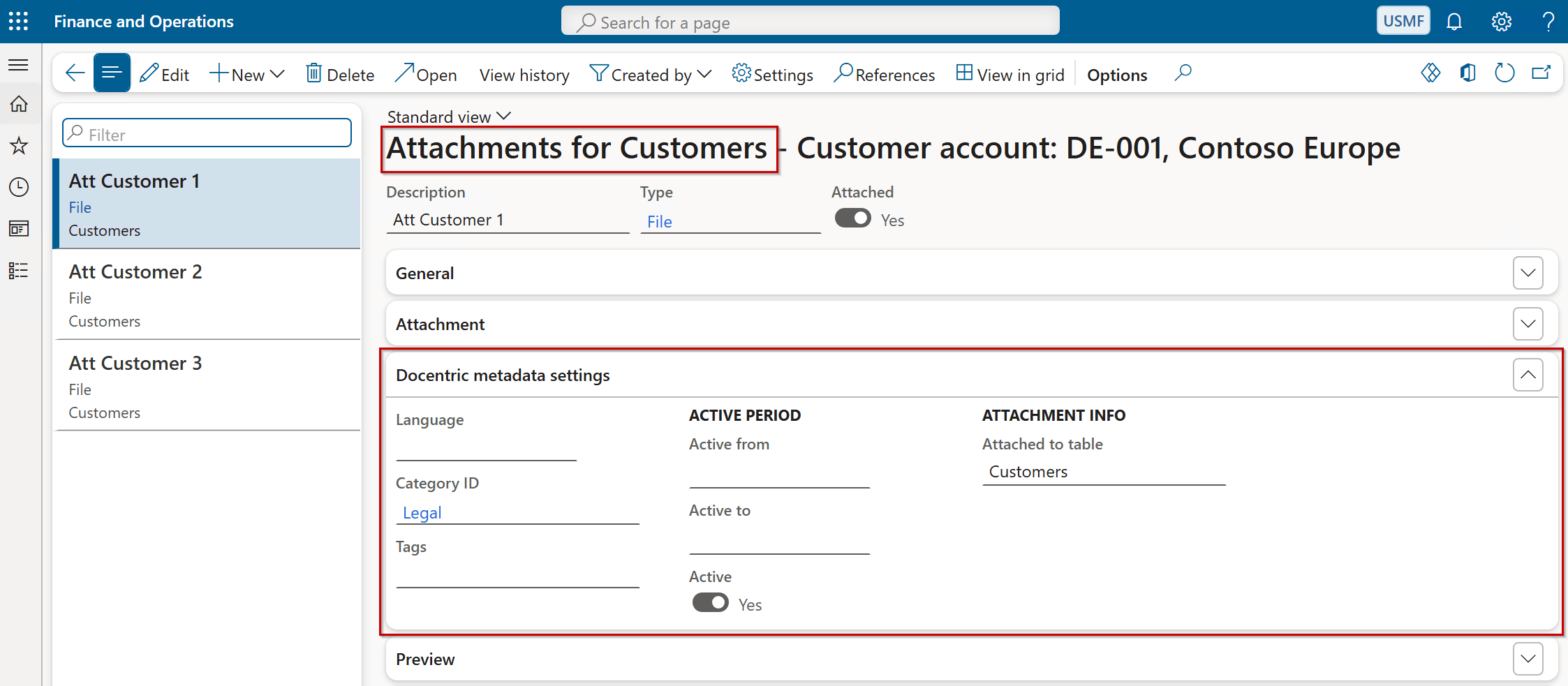

Improved attachments form
Docentric metadata settings
The Docentric metadata settings fast tab is added to the standard D365FO Document management attachments form:
It contains the following fields:
  • Language: allows refining the list of documents to be attached to the report, by matching the report runtime language with the language specified on the document.
  • Category ID: enables a simple way of categorizing the documents, so that all the documents marked with a given category can be filtered. To maintain the attachment categories, go to Docentric AX Workspace > Additional setup > Attachments > Attachment categories form.
  • Tags: provided to make it easier to describe the document purpose and to identify it later.
  • Active period (Active from, Active to, read-only field Is active): allows specifying the period when the attachment is active.
  • Global attachment: visible and applicable only on the Attachments form for legal entities (see the left image above). If the attachment source is Global attachment, then only the current legal entity’s attachments with this option turned on are candidates for report attachments. For other types of the attachment sources this flag isn’t applicable.
We introduced these fields to enable more flexible and efficient filtering of additional loaded report attachments, but you can use these settings in your custom scenarios as well.
