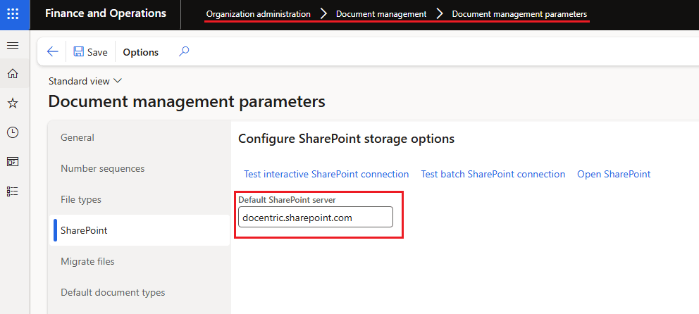

When accessing to a SharePoint location from D365FO, the current user account is always used to log in to the default SharePoint server. To override this default behavior for Docentric functionalities related to SharePoint, from 3.4.3 you can use SharePoint extended security settings.
Unlike the built-in D365FO, where only a single SharePoint server is supported (SharePoint Online that is configured in Document management parameters), with the new security settings you can also use SharePoint On-premises and even multiple SharePoint servers. Additionally, you can configure different login accounts for different sites and document libraries, by using Fine-grained security.

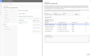

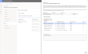

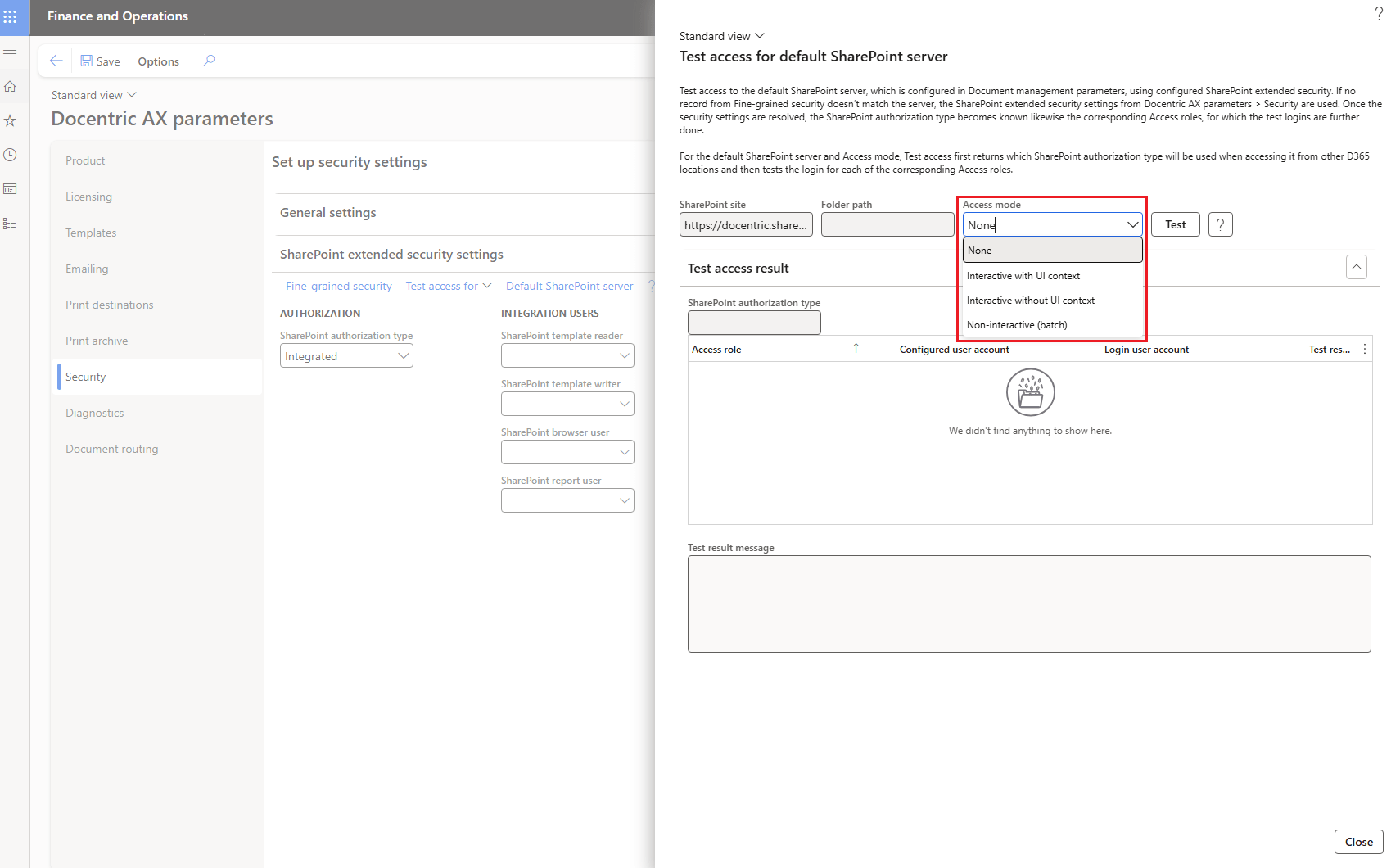

Test access to SharePoint URL
To test SharePoint extended security for a given SharePoint URL, you can use the Test access menu items on both the Fine-grained security form and the Docentric AX parameters > Security > SharePoint extended security settings form.
The Test access form actually implements the process described above, and by using it, you can check which users will be used for which scenarios considering the existing SharePoint extended security setup. You can also check if the current user account (your account) has access to a certain SharePoint location, which can be a SharePoint server, SharePoint site, document library, folder path or file.
