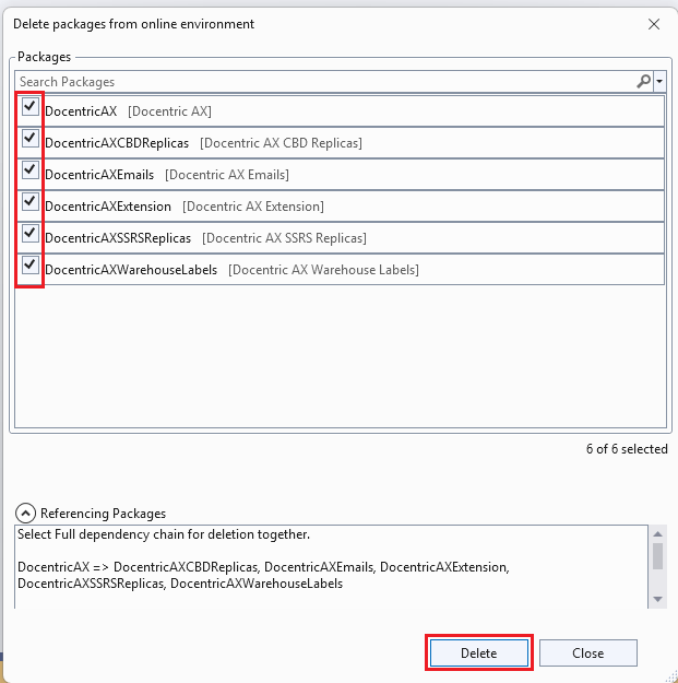

Delete Docentric AX packages and models

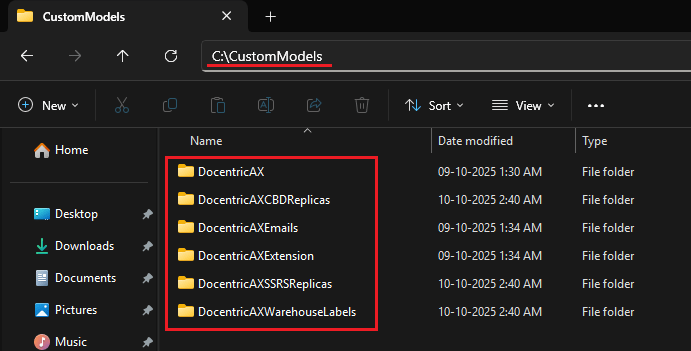

Each model belongs to an package, which has a dedicated folder within the Packages folder (or model store folder), typically C:\packages or C:\AosService\PackagesLocalDirectory.
For example, the Docentric AX model belongs to the DocentricAX package, which is located in the DocentricAX subfolder of the Packages folder (e.g. C:\AosService\PackagesLocalDirectory\DocentricAX).
Next, the Docentric AX Extension model belongs to the DocentricAXExtension package, which is located in the DocentricAXExtension subfolder of the Packages folder (e.g. C:\AosService\PackagesLocalDirectory\DocentricAXExtension).
After deletion of the models, we will get the following situation:
In order to make Docentric AX models disappear from AOT completely, we need to physically delete all related subfolders, e.g. DocentricAX and DocentricAXExtension, which are now empty, from your Packages folder.
