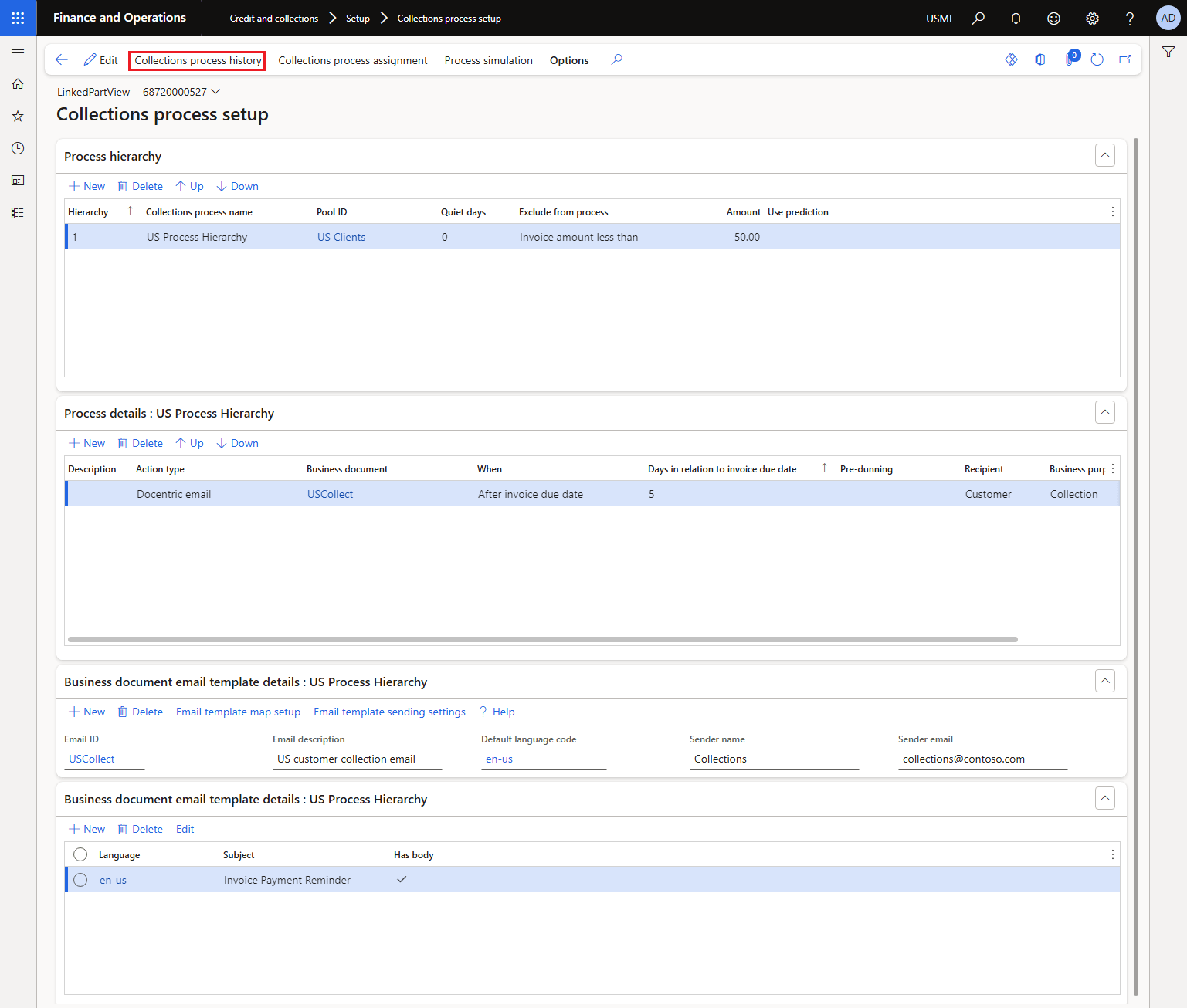

Improvements are implemented by adding a custom Action type – Docentric email, which can be selected among the built-in Action types (Email, Collection letter, Activity) when configuring Collections process setup lines (in the Process details grid) on the Collections process setup form.
Collections process automation batch jobs perform the action steps that are configured in Collections process setup for collections processes (strategies) with different customer pools. Every process (strategy) is configured as a list of steps (the process details) of certain Action type.
When Action type of current process step is Email or Docentric email, an email is created from System email template, which is configured in the Business document field on the process step (process details line), and sent to the recipients, which are configured on the same step through the Recipient and Business purpose contact fields.
If the Recipient field is set to Customer, the created email is sent to the contact emails of the processing customer (from the process pool), which are marked with the purposes configured in the Business purpose contact field. If Recipient is set to Sales group or Collections agent, the created email is sent to all members of the group or the agent that are configured in Business purpose contact respectively.
The difference between Email, a built-in Action type, and Docentric email, a custom Action type, is that in the case of Docentric email, the design and process of sending generated emails is enhanced by Docentric.

Email sending settings for outgoing emails, which are created in Collections process automation by using a custom Action type – Docentric email, can be configured in the Email template sending settings form per Docentric System email template used for Collections process automation.
Email template sending settings include:
  • Email sending mode: Choose between Synchronous mode, which sends out emails in process and is used by default, and Email processing, which sends emails via Batch email sending status and Docentric email distributor batch. Email processing is an enhancement introduced by Docentric. Learn how Docentric improves built-in email processing >>

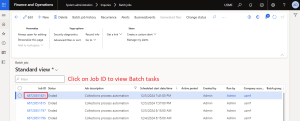

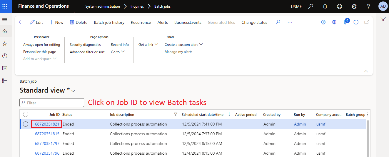

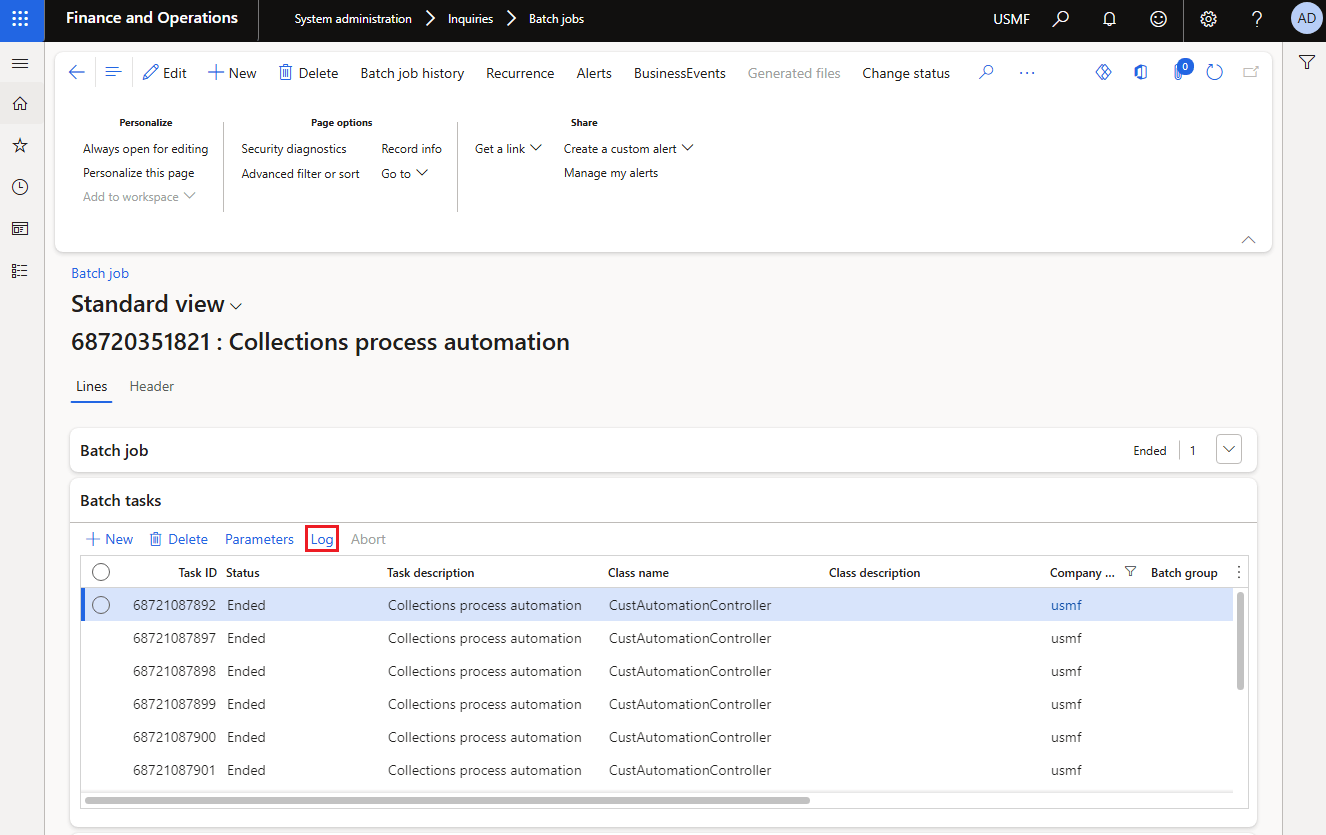

  1. Batch jobs - most detailed logging, best for troubleshooting
    In the Batch job form, you can locate jobs with Collections process automation as Job description and check Log messages in Batch job history. Unlike View errors from Collections process history, the messages from Batch job history log will include all types of messages, not only errors.

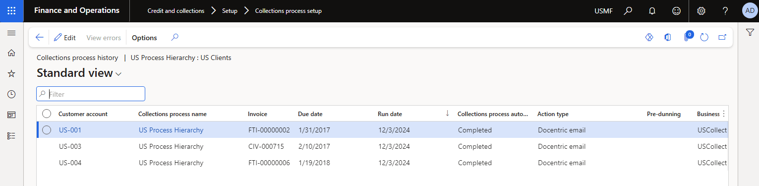

  2. Collections process setup > Collections process history
    Monitor the execution of Collections processes by process, customer, open invoice, due date, run date, action type, etc. You can also see the errors that occurred per invoice on the Execution message log dialog, including emailing errors, by clicking the View errors button.

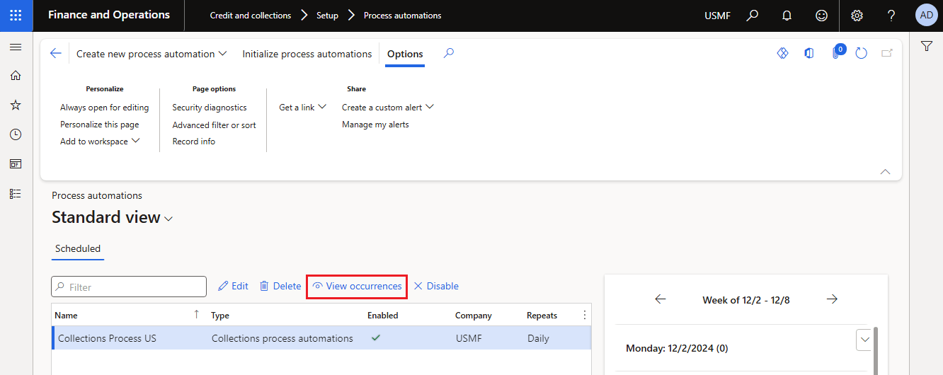

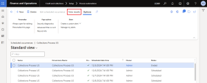

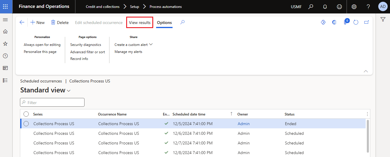

  3. Process automation
    On the Process automations form, view all scheduled, executing and completed processes of type Collections process automations. Occurrences for these processes can be seen in a calendar view, with a possibility to view the execution results for the completed processes (the View results button). However, most detailed log messages can be found in Batch jobs.

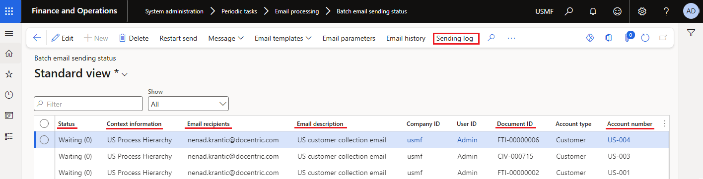

  4. Batch email sending status
    If the emails generated during Collections process automation are sent using Email processing, you can monitor Status of outgoing emails and Sending log in the Batch email sending status form.
    You can search outgoing emails by columns Document ID (Invoice ID), Account number (Customer account), Context information (Collections process name), Email description (Description of the system email template used for the email creation and configured on the collections process setup line in the Business document field), Email recipients (resolved from the fields Recipient and Business purpose contact configured on collections process setup line).
