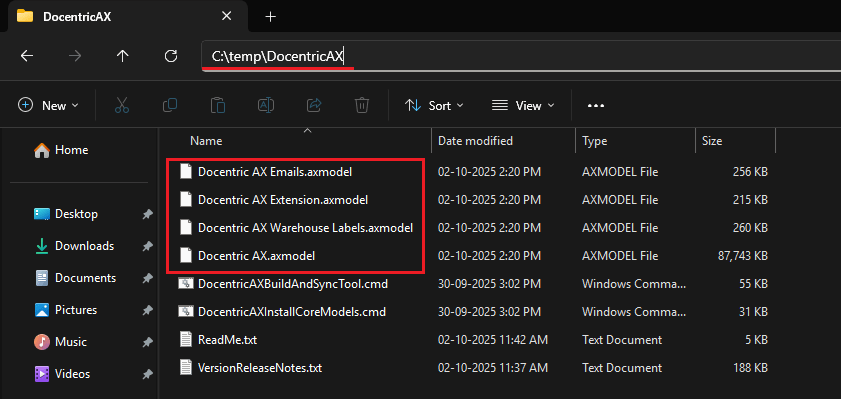

In the downloaded ZIP packages, you will find Docentric AX models but also 2 additional files:
- ReadMe.txt contains more precise instructions about which model files to use (e.g. it can happen that models will be different for different D365FO application and platform version).
- VersionReleaseNotes.txt contains the list of new features and bug fixes in the new version release.
Read the complete Docentric AX change log >>

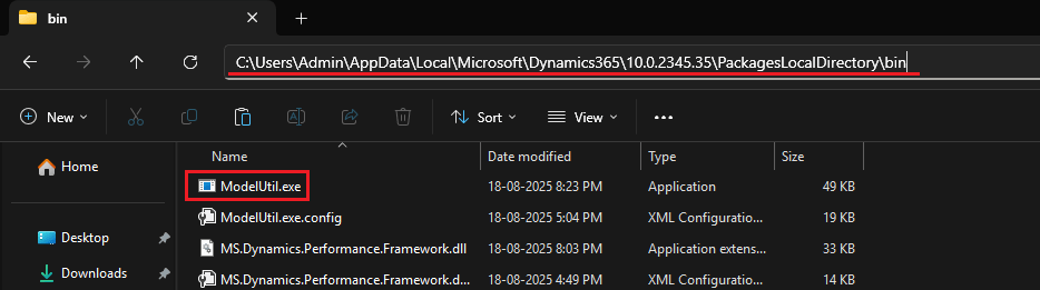

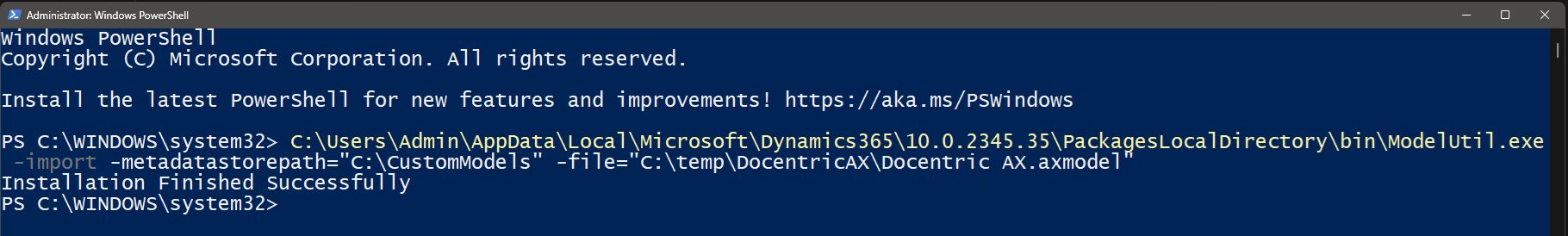

1. Import Docentric AX model files using the »ModelUtil.exe« tool.

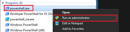

This tool is located in the Packages Bin folder (typically, C:\Packages\Bin or C:\AosService\PackagesLocalDirectory\Bin). Run Command Prompt as Administrator and navigate to the Bin directory of your Packages folder. Execute the command for importing the Docentric AX models:
1 2 |
modelutil -import -metadatastorepath=[path of the metadata store where model should be imported] -file=[full path of the file to import] |
Example:
1 2 3 |
modelutil -import -metadatastorepath="C:\AOSService\PackagesLocalDirectory" -file="C:\Temp\DocentricAX\Docentric AX.axmodel" modelutil -import -metadatastorepath="C:\AOSService\PackagesLocalDirectory" -file="C:\Temp\DocentricAX\Docentric AX Extension.axmodel" |

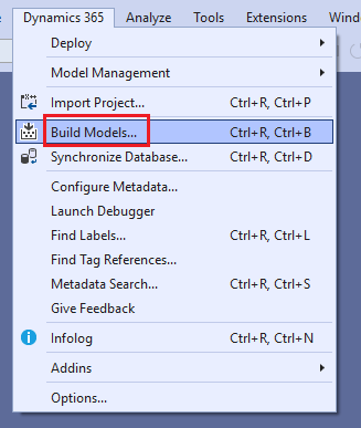

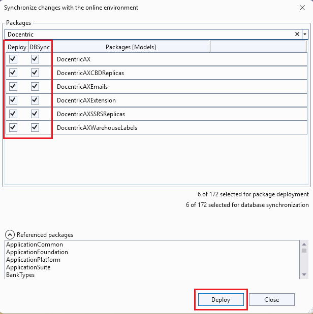

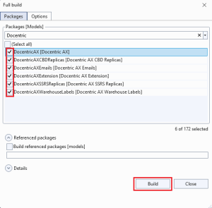

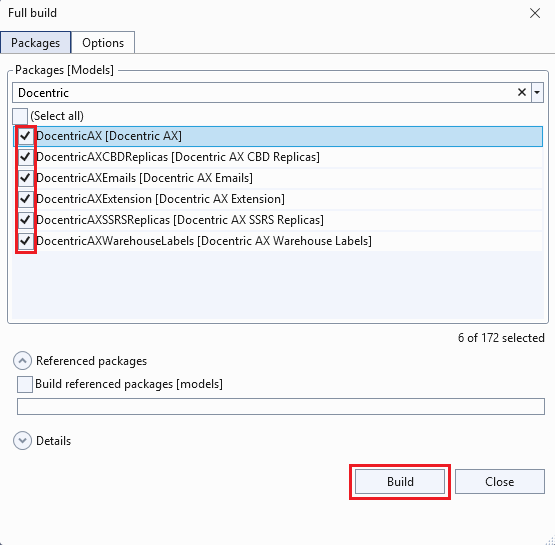

2. Build the imported models.
In Visual Studio select the »Dynamics 365 -> Build Models…« menu. In the Model Build dialog select the newly imported models and press the Build button.
3. Synchronize the database.
In Visual Studio click the »Dynamics 365 -> Synchronize Database…« menu item and press the Synchronize button in the shown dialog.
