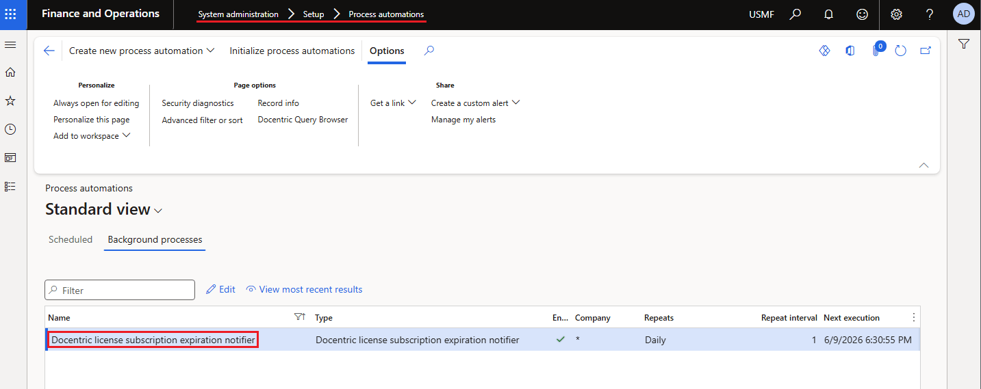

You can find the Docentric license subscription expiration notifier background process by opening the Process automations form, which can be found under System administration > Setup > Process automations:

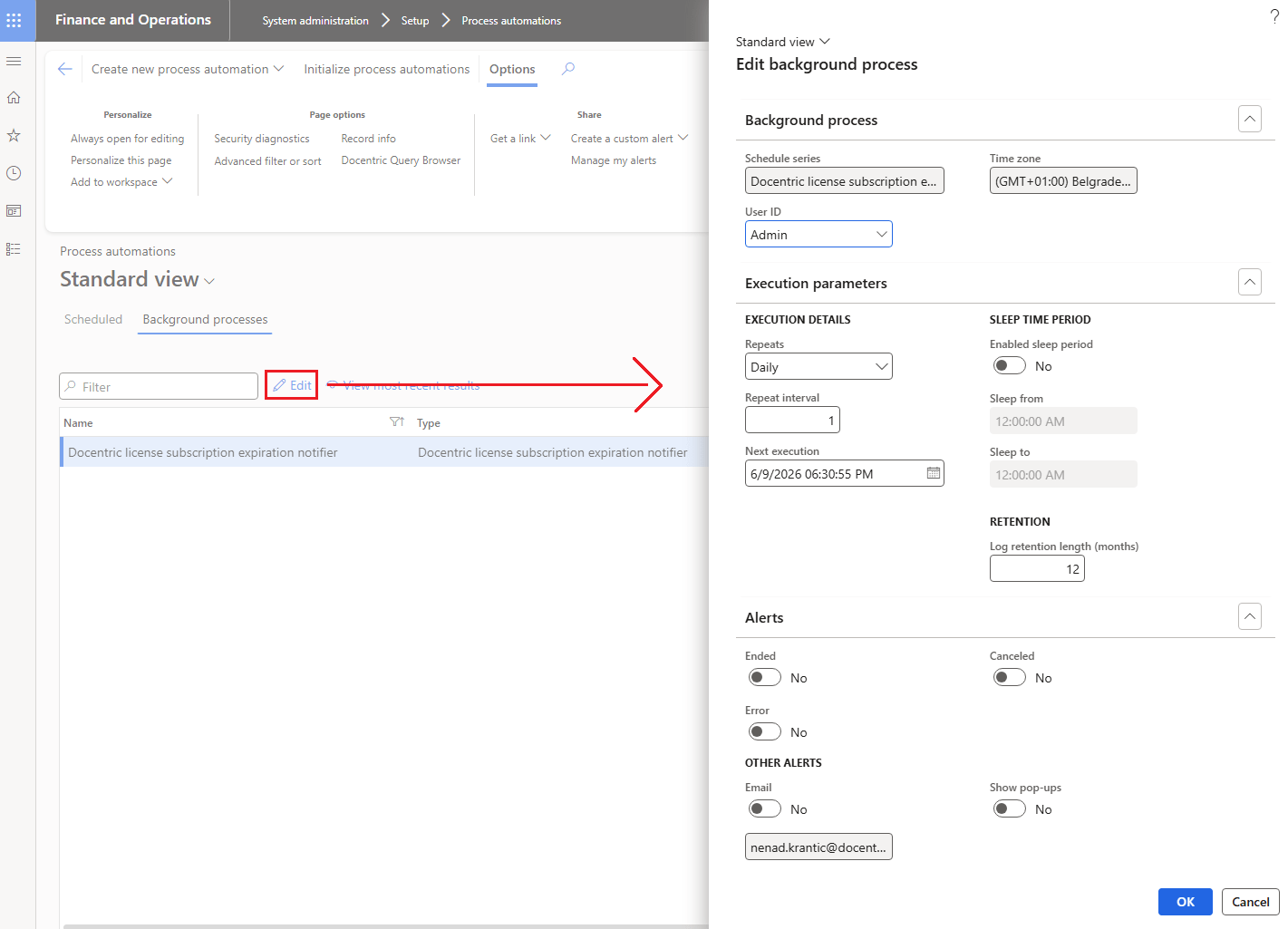

From here you can edit the parameters of the background process by clicking on Edit:
Please note that the execution interval cannot be changed, it will always execute once per day (Repeats = Daily, Repeat interval = 1).

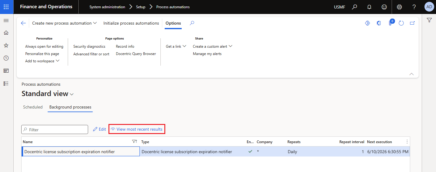

On the same form you can also open the execution logs and see the execution results of the Docentric license subscription expiration notifier background process by clicking on View most recent results:

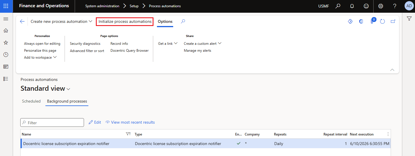

If the Docentric license subscription expiration notifier background process was not created, you can click on Initialize process automations, which should create all non-existing background processes:
