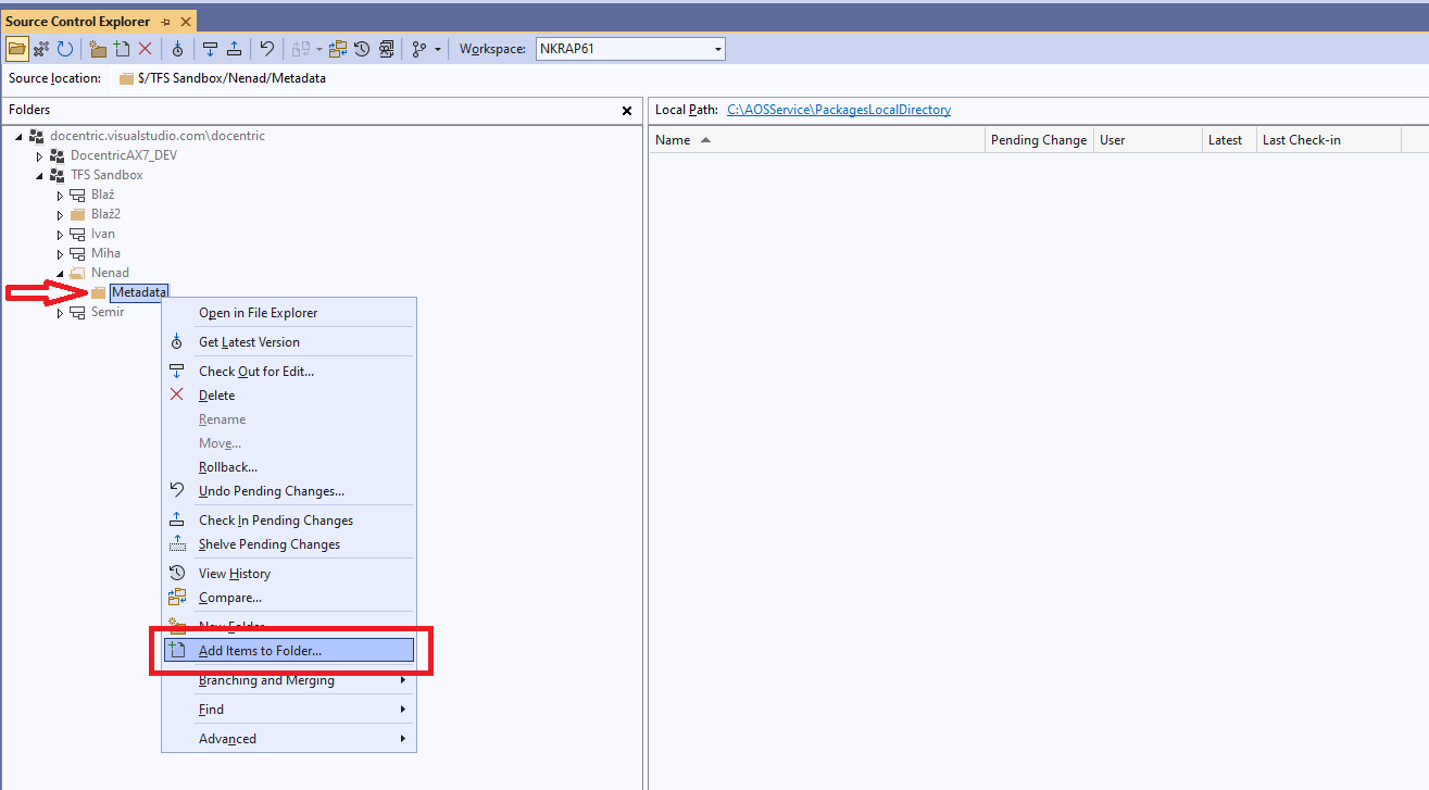

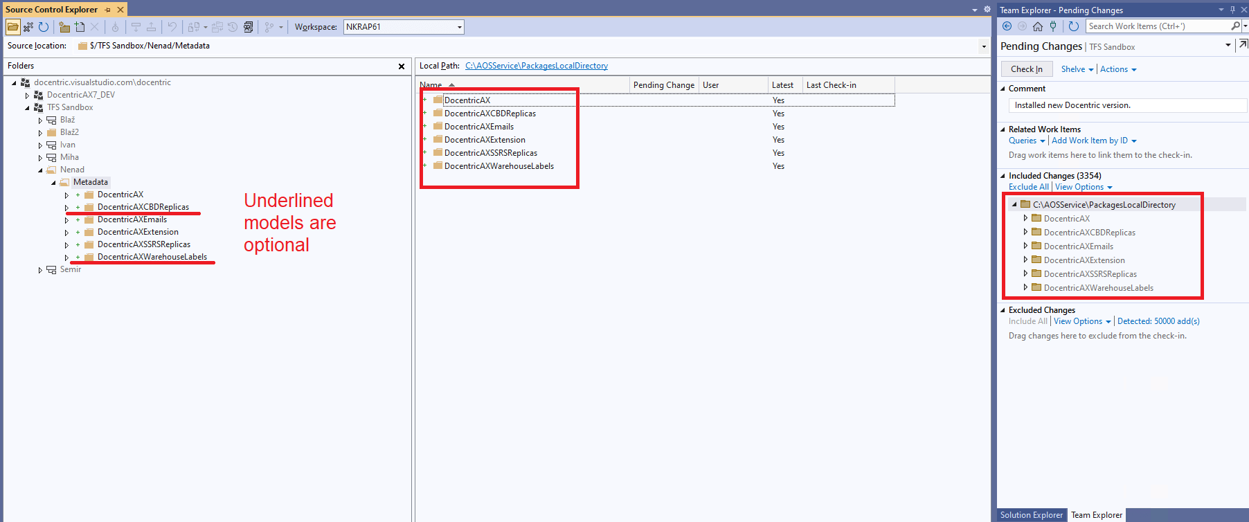

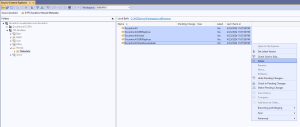

If you would like to check-in all the changes of the upgraded Docentric AX models, make sure that all these changes are listed in Team Explorer\Included Changes, before checking-in them to TFS. Updates are included automatically, while deleted files have to be manually promoted from Team Explorer\Excluded Changes > Detected. New files have to be added manually as well (Add Items to Folder).

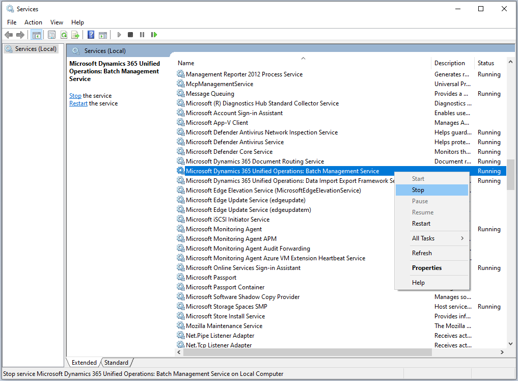

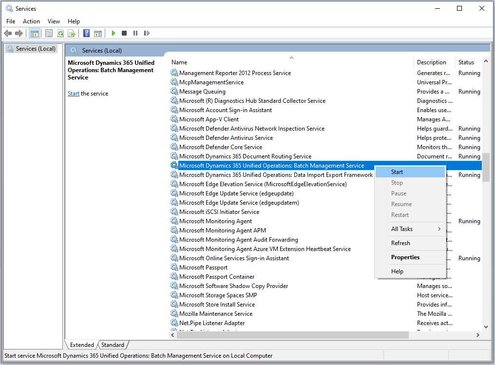

- Stop IIS (or IIS Express) and the Batch service.
- Delete all Docentric AX models (i.e. packages) from TFS and CHECK-IN THE CHANGES.

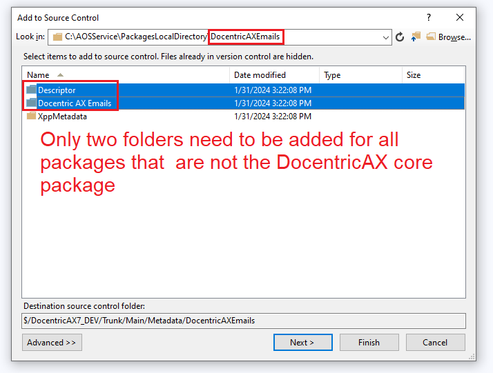

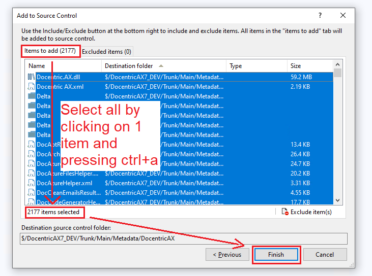

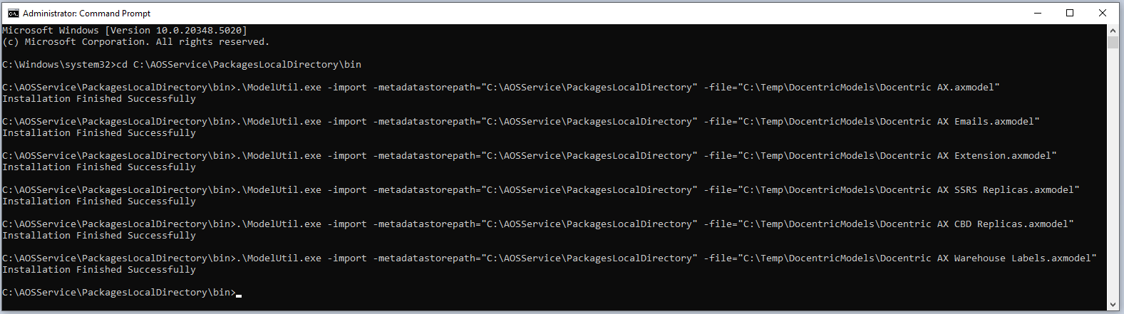

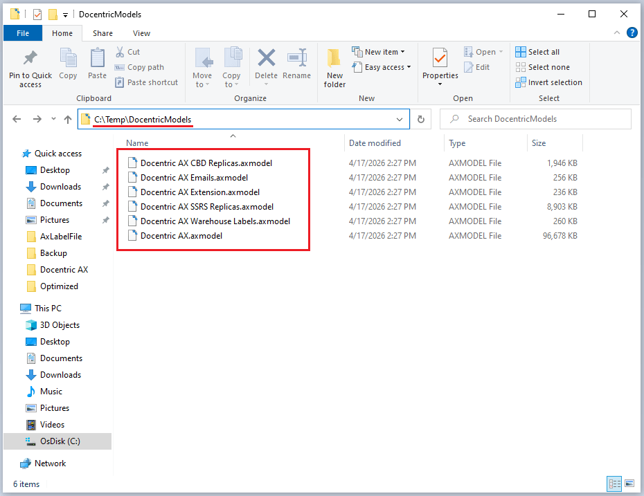

DO NOT compile or synchronize the database at this point.Make sure to also delete the Docentric.AX.dll and Docentric.AX.Services.Contracts.dll from the DocentricAX\bin directory and commit their deletion to TFS! - Since we deleted the Docentric AX models, you can manually import the latest version of the models by using ModelUtil.exe (modelutil -import) as it goes for the clean installation.
The ModelUtil.exe tool is part of the standard D365FO installation and is usually located in the C:\AOSService\PackagesLocalDirectory\bin directory, but can also be on a different drive (for example, K:\AOSService\PackagesLocalDirectory\bin).

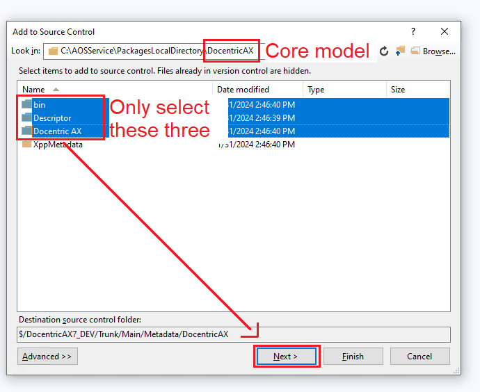

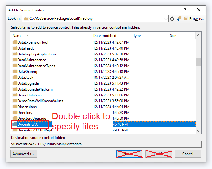

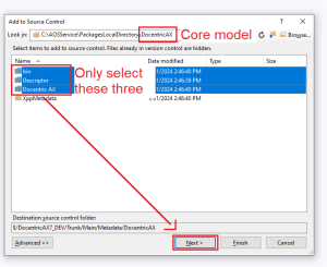

1234567cd C:\AOSService\PackagesLocalDirectory\bin.\ModelUtil.exe -import -metadatastorepath="C:\AOSService\PackagesLocalDirectory" -file="C:\Temp\DocentricModels\Docentric AX.axmodel".\ModelUtil.exe -import -metadatastorepath="C:\AOSService\PackagesLocalDirectory" -file="C:\Temp\DocentricModels\Docentric AX Emails.axmodel".\ModelUtil.exe -import -metadatastorepath="C:\AOSService\PackagesLocalDirectory" -file="C:\Temp\DocentricModels\Docentric AX Extension.axmodel".\ModelUtil.exe -import -metadatastorepath="C:\AOSService\PackagesLocalDirectory" -file="C:\Temp\DocentricModels\Docentric AX SSRS Replicas.axmodel".\ModelUtil.exe -import -metadatastorepath="C:\AOSService\PackagesLocalDirectory" -file="C:\Temp\DocentricModels\Docentric AX CBD Replicas.axmodel".\ModelUtil.exe -import -metadatastorepath="C:\AOSService\PackagesLocalDirectory" -file="C:\Temp\DocentricModels\Docentric AX Warehouse Labels.axmodel"Alternatively, you can use the scripts from the downloaded ZIP packages – DocentricAXInstallCoreModels.cmd and DocentricAXInstallSSRSReplicasModel.cmd to import/replace the models. - Add the regular artifacts from Docentric AX models to TFS the same way as a clean installation. Make sure that the correct DLLs from the DocentricAX\bin folder are added to TFS.

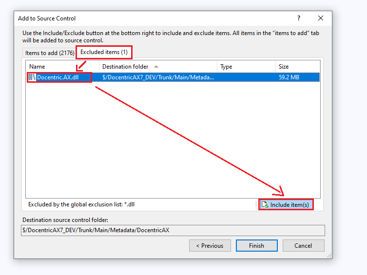

As with a clean installation, the only files from the DocentricAX\bin folder you should add to TFS are the Docentric.AX.dll and Docentric.AX.Services.Contracts.dll files.
All other files, which will be created in this folder after the first build, including Dynamics.AX.DocentricAX.dll, are build artifacts and SHOULD NOT be added to TFS. - Start IIS (or IIS Express) and the Batch service.

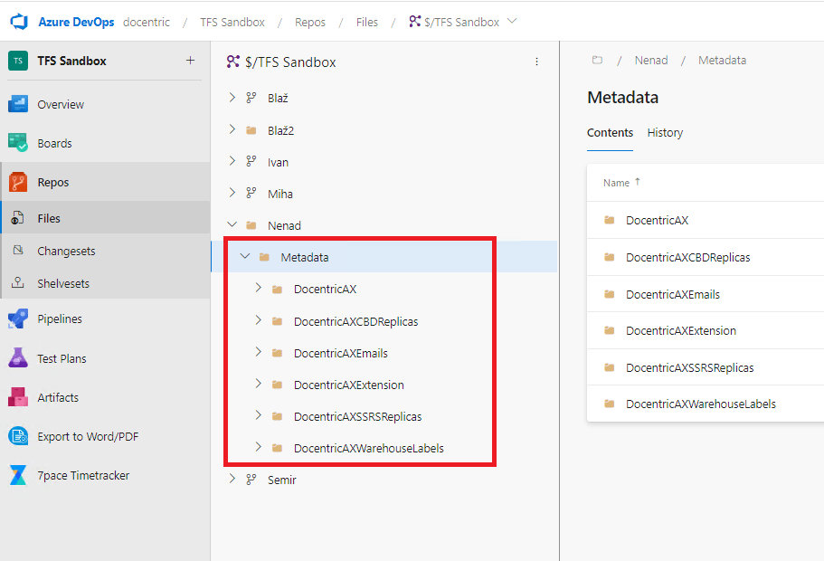

- Check-in the changes and verify on the TFS (Azure DevOps) portal that you really have the new code in place in the repository.
