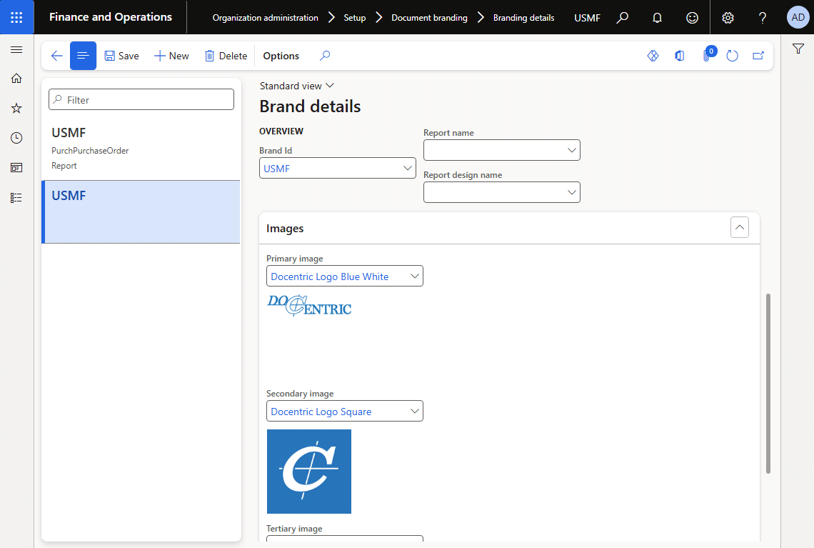

Instead of hardcoding the same company information into every report design, you can maintain branding centrally under: Organization administration > Setup > Document branding:
Standard D365FO Document Branding setup.
The standard setup includes:
  • Document brands
  • Document images
  • Branding details
Branding details provide common information such as company images and logos, addresses, contact information, notes and other branding information.

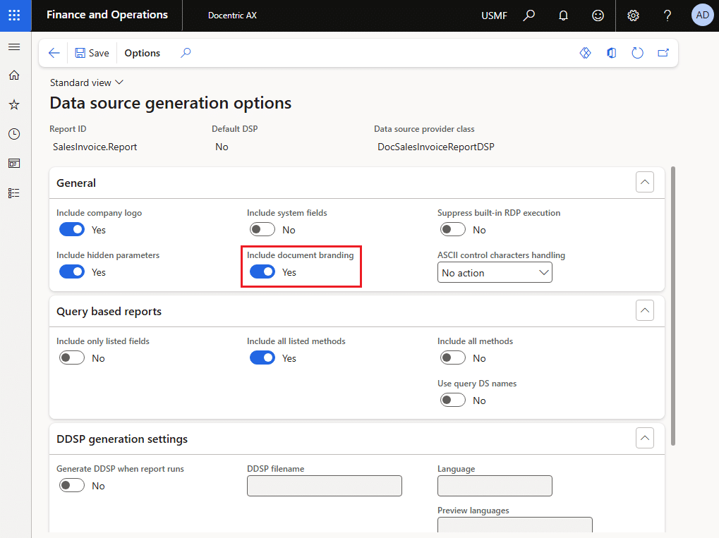

For SSRS-based Docentric reports, you can include the Document branding data in the Docentric report data source and use it directly in Docentric templates. In the Data source generation options form for the selected report turn on the Include document branding flag:
Enabling inclusion of Document Branding information inside the Docentric Data Source Package (DDSP).

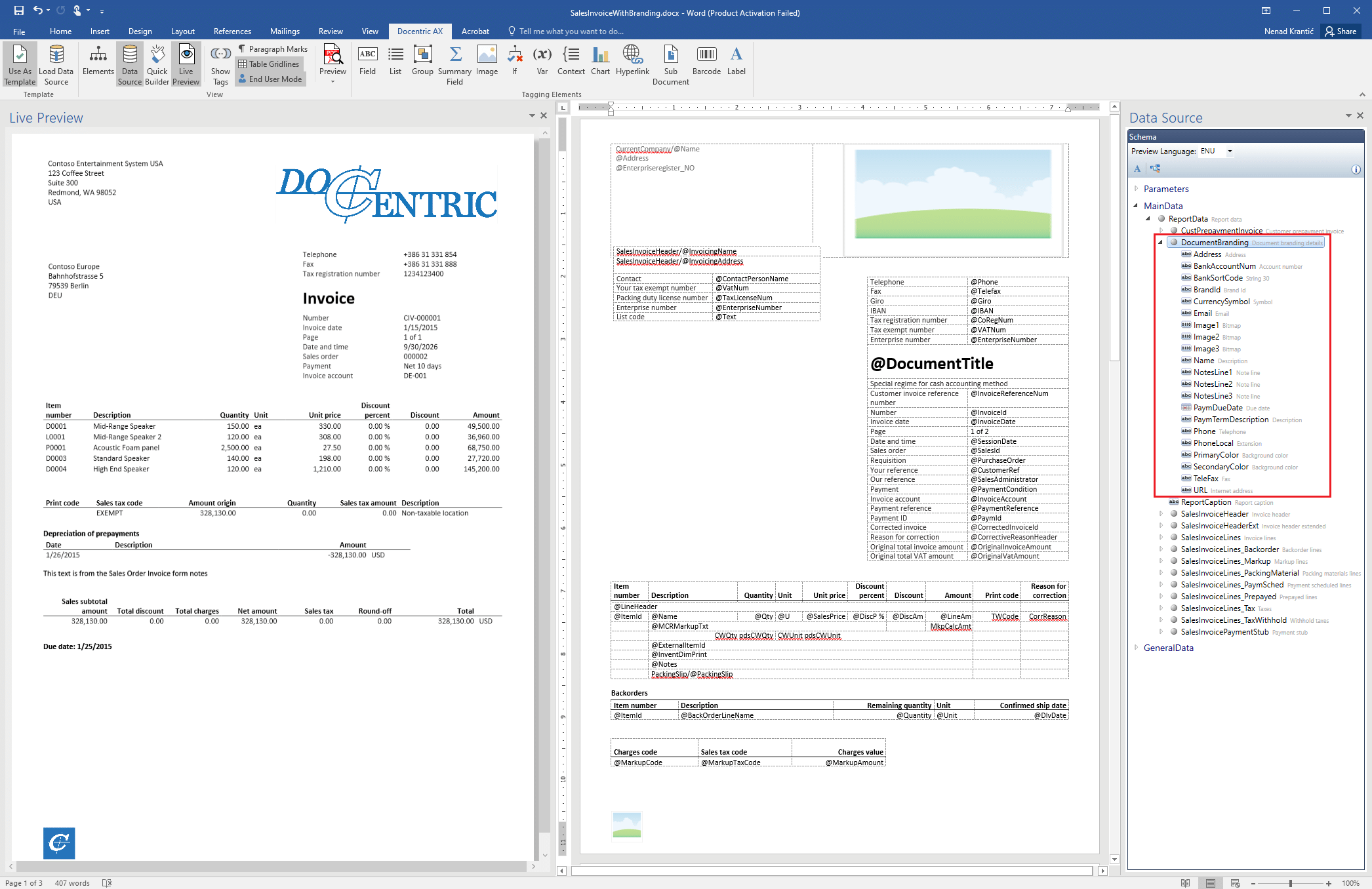

Docentric designer showing the Document Branding fields being available for use.
