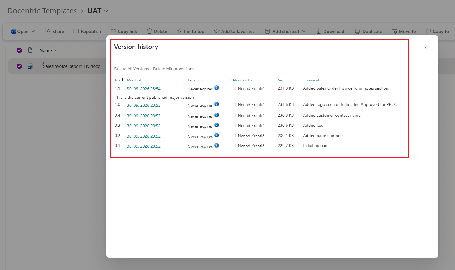

(A) Draft and versioning
A Template Editor changes the template during normal template development.
Instead of manually creating files such as:
SalesInvoice_v12_FINAL_FINAL.docx
the template can keep the same name while SharePoint version history keeps track of its changes.
Depending on the SharePoint document library configuration, the customer can also use major and minor versions and check-in/check-out. This gives the team a history of the template without having to manage multiple copies of the same file manually.
SharePoint Version history dialog for SalesInvoice.Report_EN.docx showing minor versions 0.1 to 0.4, the published major version 1.0, and a newer draft version 1.1, each with its date, author, size and check-in comment.

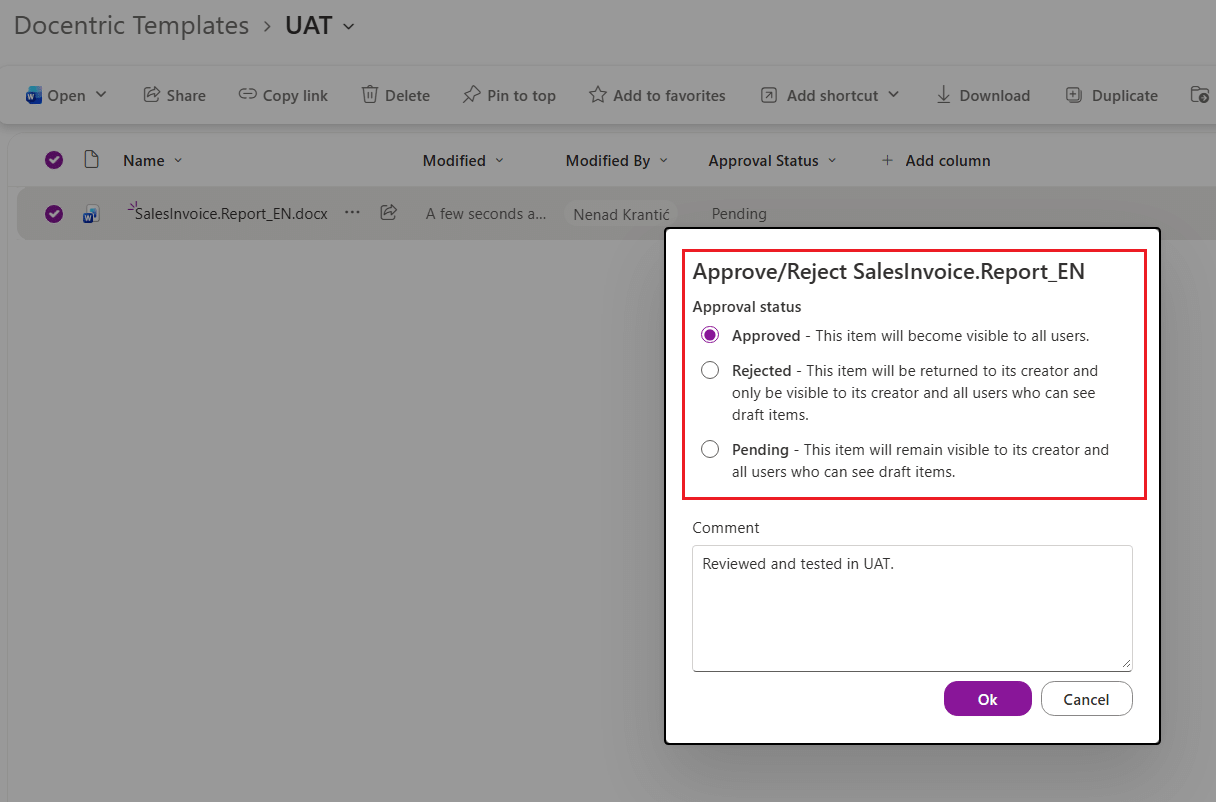

(C) Approval
After the template has been reviewed and tested, the customer can mark it as the approved version using the approval process configured in SharePoint.
This is an important separation of responsibilities:
  • Docentric AX manages the template and uses it when generating documents.
  • SharePoint manages the template version history and, when configured, the approval process.
Docentric therefore does not need a second, separate approval workflow for a template whose lifecycle is already governed in SharePoint.
SharePoint Approve/Reject dialog for SalesInvoice.Report_EN with the Approved option selected and the comment Reviewed and tested in UAT. The file's Approval Status in the library is Pending.

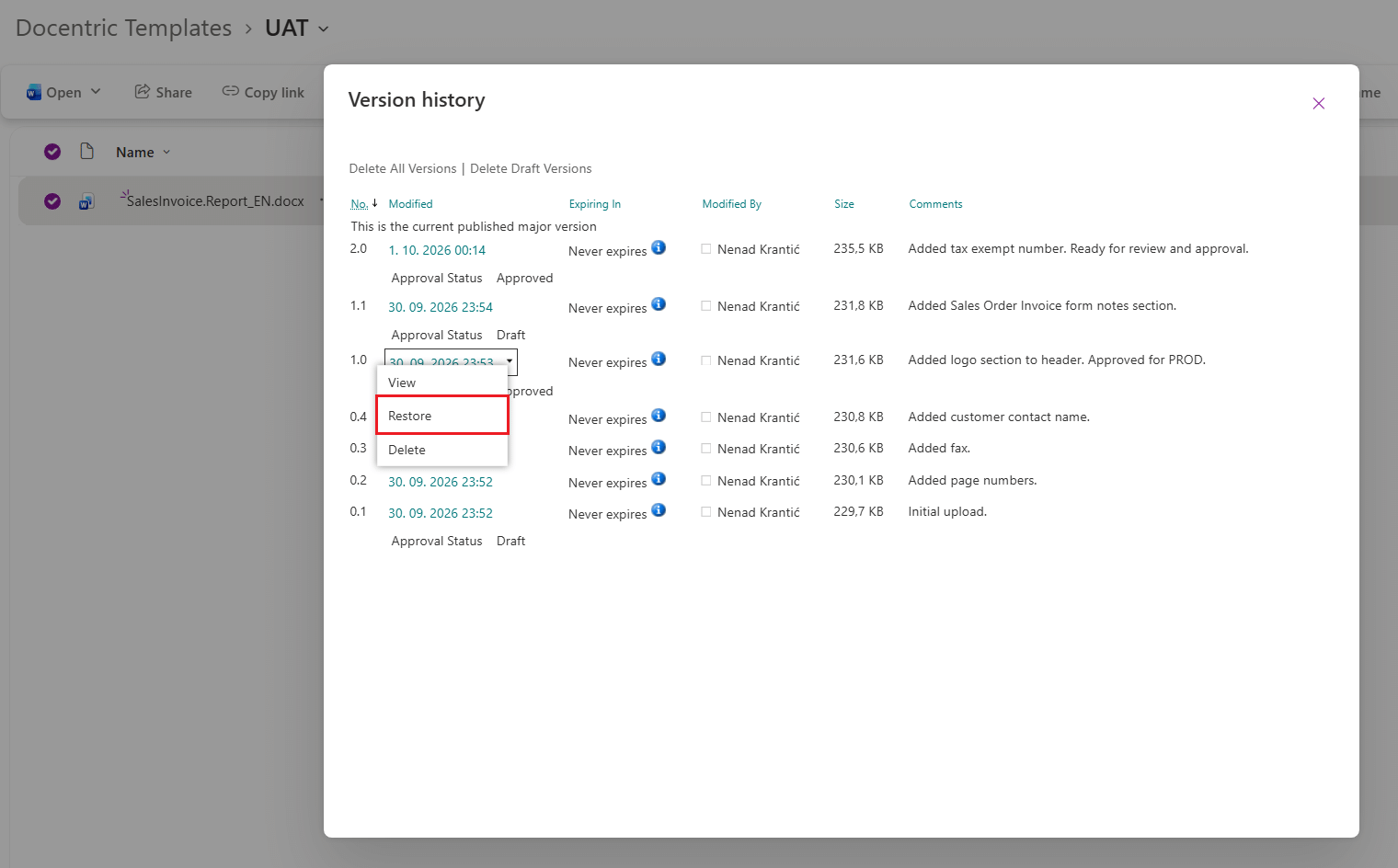

(E) Rollback to an earlier version
If a newly released template causes a problem, SharePoint version history can be used to find and restore an earlier approved version.
For this reason, customers should keep previous approved Production versions instead of deleting them when a new version is released.
A simple rule can be:
Current approved version → Production
Previous approved version(s) → available for rollback
SharePoint Version history dialog where the current approved version is 2.0. The menu of the earlier approved version 1.0 is open with the Restore option highlighted.

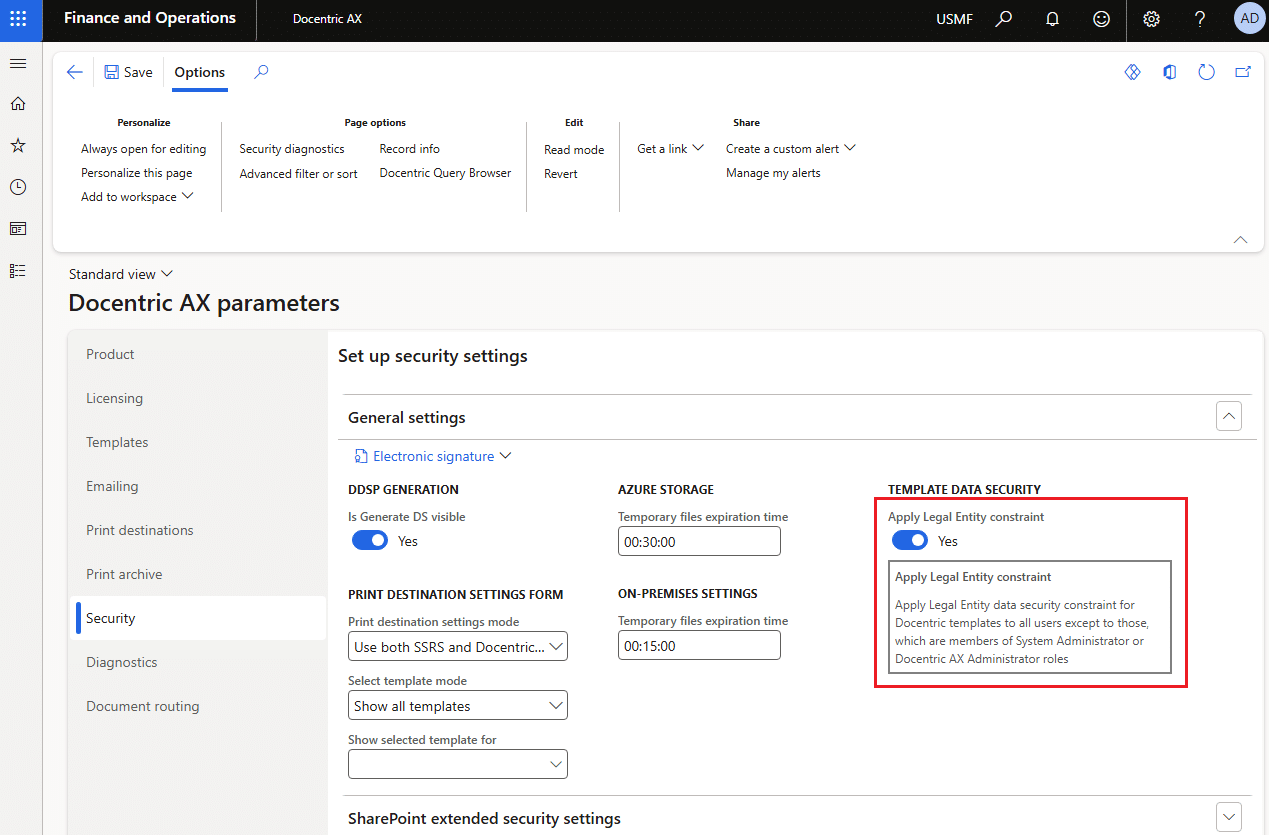

5. Control who can change templates
Template Governance should also define who is allowed to change templates and related Docentric configuration.
SharePoint permissions control access to template documents stored in SharePoint. Docentric security controls what users can do with templates and Docentric report setup inside D365FO.
Security role: Docentric AX Template Editor
The Docentric AX Template Editor role is intended for users who design and maintain Docentric templates.
For example, this can be a Functional Consultant or a trained business user responsible for maintaining Sales Invoice, Purchase Order or other business document templates.
The user can work with templates without being given full Docentric administration rights.
Security role: Docentric AX Power User
The Docentric AX Power User has broader access to Docentric functionality and configuration than a Template Editor.
This role is suitable for users who, besides maintaining templates, also need to work with broader Docentric report setup and configuration.
Security role: Docentric AX Administrator
The Docentric AX Administrator has full access to Docentric configuration and securable artifacts.

Restrict template access by Legal Entity
Giving a user the Template Editor or Power User role does not necessarily mean that the user needs access to all templates.
Docentric Template Data Security can further restrict which templates these users can work with.
For example, the Legal Entity constraint can restrict users to templates associated with the legal entities they are allowed to work with.
This makes scenarios such as the following possible:
Template Editor + access to German legal entity → can maintain templates for that legal entity
without automatically giving the user access to templates belonging to other legal entities.
Custom Template Data Security constraints can also be implemented in X++ when the standard Legal Entity constraint is not sufficient.

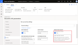

Template Data Security applies to Template Editors and Power Users. Docentric AX Administrators and System Administrators are not restricted by these constraints.
Docentric AX parameters form, Security tab, with the Apply Legal Entity constraint option under Template data security set to Yes.

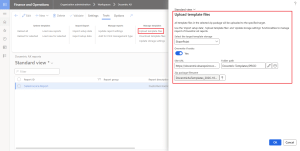

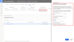

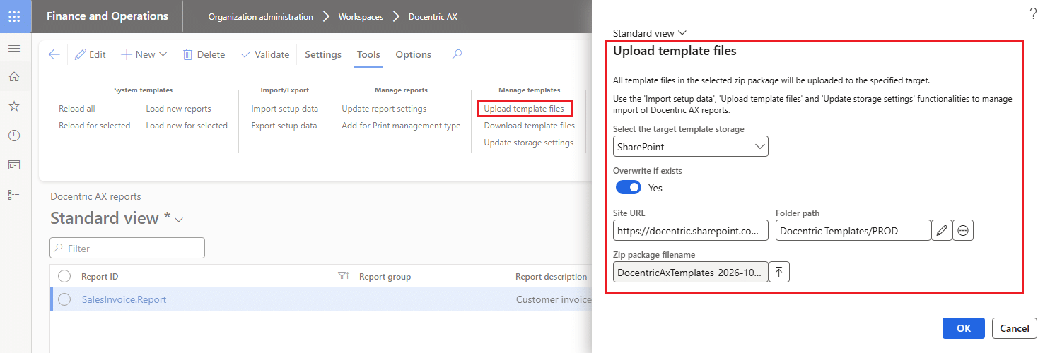

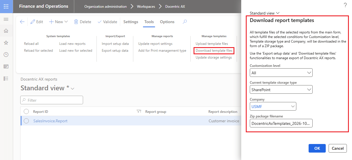

Use Docentric Deployment Tools
Docentric Deployment Tools are designed move Customized System and Custom Templates as well as other settings from Docentric report setup between environments.
They support:
  • Download/Upload templates
  • Update storage settings
  • Export/Import report setup data
For example, templates from multiple reports can be downloaded together as a ZIP package. That downloaded ZIP package can then be uploaded to the corresponding storage in another environment.
Docentric AX reports form, Action Pane > Tools tab, with Download template files highlighted. The Download report templates dialog shows filters for Customization level, Current template storage type set to SharePoint, Company set to USMF, and the ZIP package filename.   Docentric AX reports form, Action Pane > Tools tab, with Upload template files highlighted. The Upload template files dialog has SharePoint as the target template storage, Overwrite if exists set to Yes, the Folder path set to Docentric Templates/PROD, and a ZIP package selected for upload.

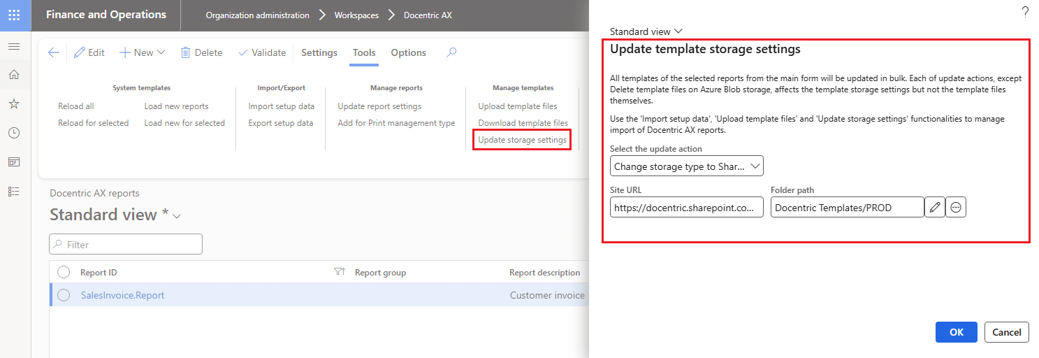

If TEST/UAT and PROD use different SharePoint folders, Azure Blob Storage locations or other storage settings, Update storage settings can be used to update these settings in bulk.
Docentric AX reports form, Action Pane > Tools tab, with Update storage settings highlighted. The Update template storage settings dialog has the update action Change storage type to SharePoint and the Folder path set to Docentric Templates/PROD.

SharePoint is a natural storage choice when the customer also needs versioning and approval.
Custom Template
SharePoint
Draft → Review → Test → Business Review/UAT → Approve
Move approved version to PROD
Verify in PROD
In this model:
  • Functional Consultants or trained business users maintain the templates,
  • SharePoint keeps the version history,
  • SharePoint permissions control access to the template documents,
  • a SharePoint approval process can be used when formal approval is required,

  10. How will you roll back an incorrect Production change?
    Make sure the previous approved version can be identified and restored.
