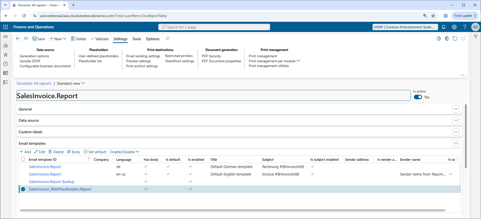

Email templates
Email templates enable templating of the outgoing emails for reports that are emailed using Docentric Email print destination. They are introduced in the 3.3.9 version.
Learn how to configure and use Email templates >>
