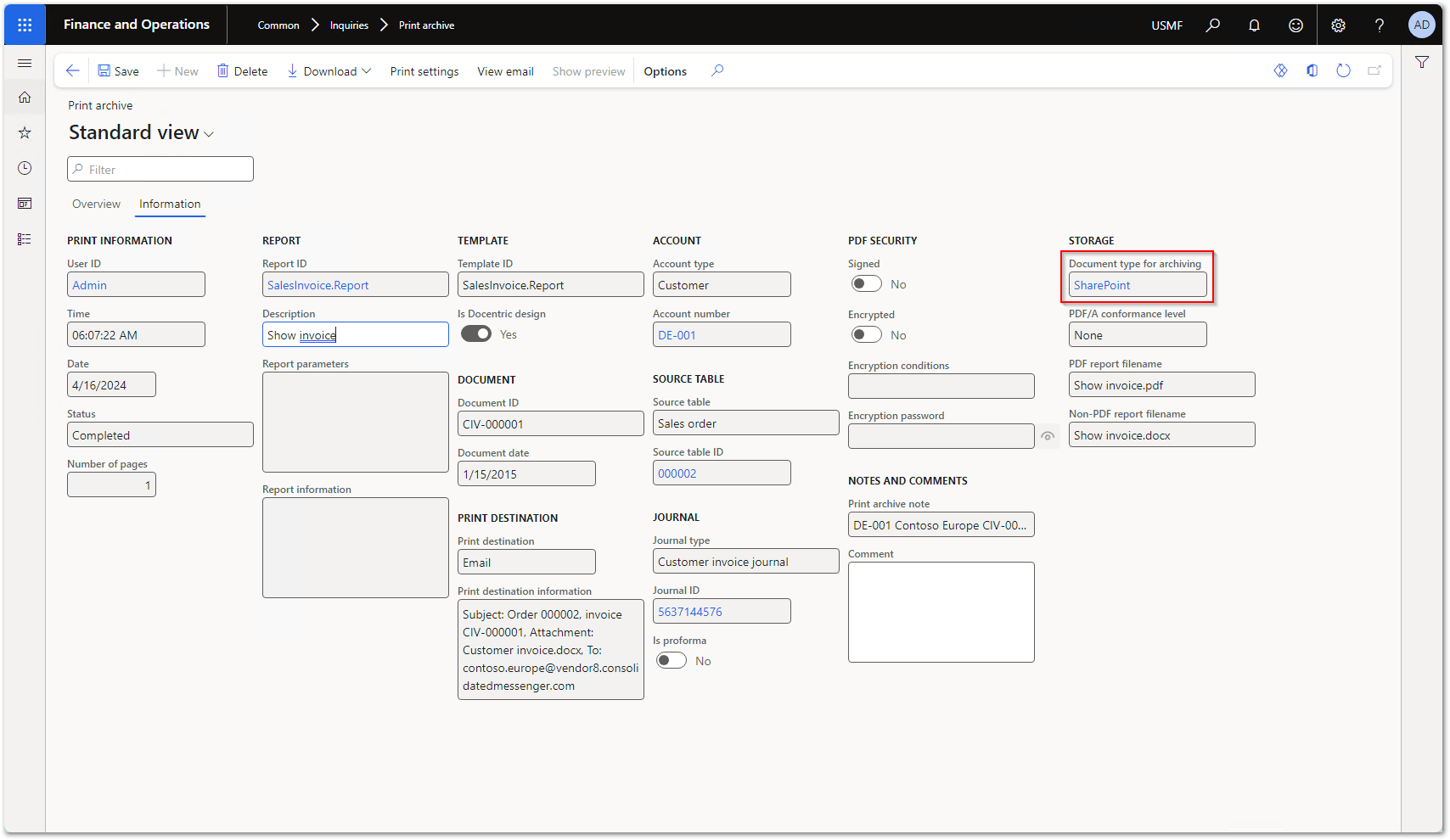

Built-in Print archive utilizes regular Document types for archiving reports. More precisely, the firstly found Document type with File in the Group field will be used, and usually this is the type with Type ID File; the described logic is hardcoded in X++. Because of that, all archived reports are saved to the same location – either to Azure blob storage or to the same SharePoint folder, which depends on the Location field of Document type with Type ID File.

Instead of using always the same Document type File when archiving reports, Docentric enables you to configure different document types for different companies in Docentric AX Parameters.

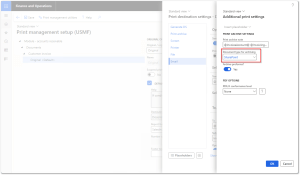

Print archive document type per report
Furthermore, you can set up and use different Document types for archiving different reports. This way you can save your invoices and purchase orders in different SharePoint folders. Print archive document types you can set up per report per company in Docentric report setup.
