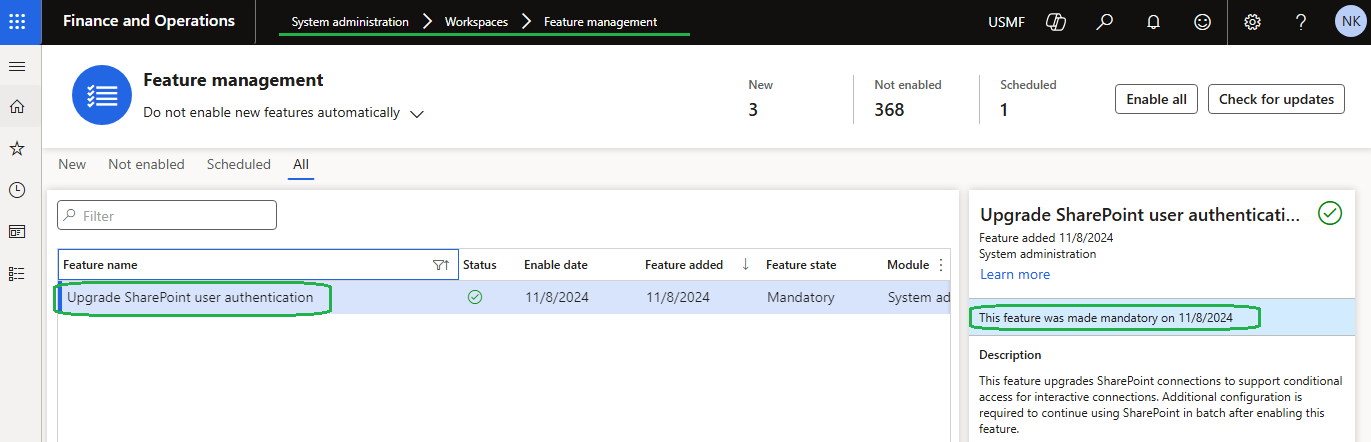

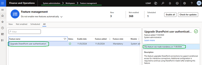

Starting with D365FO versions 10.0.42, the standard Upgrade SharePoint user authentication feature has become mandatory and can no longer be turned off.

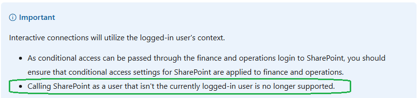

This means that user impersonation for SharePoint (calling SharePoint as a user that isn’t the currently logged-in user) is no longer supported by neither the standard nor Docentric on D365FO versions 10.0.42 and above, as explained in Microsoft documentation:

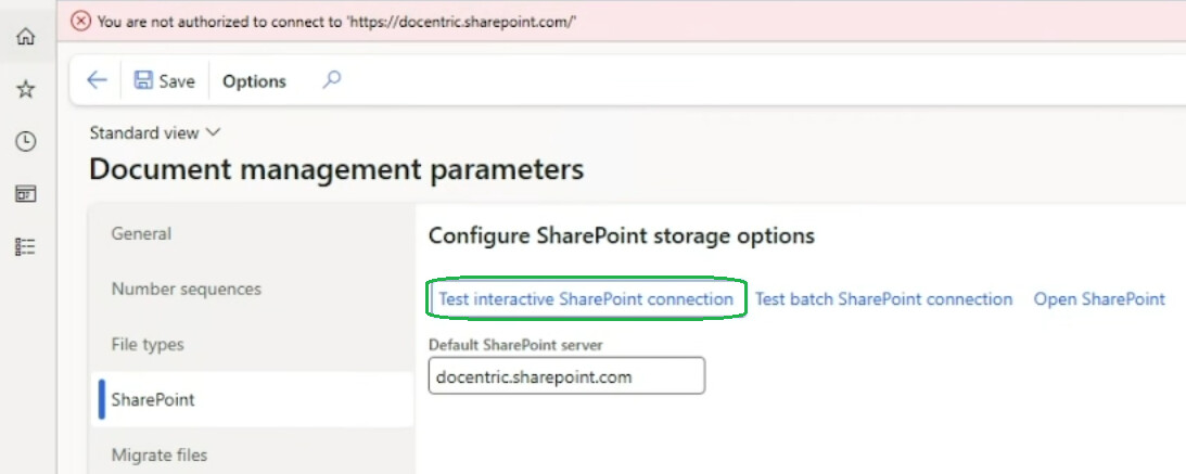

The way the upgraded SharePoint user authentication works also means that you will no longer be able to interactively execute operations that need access to SharePoint (neither standard nor Docentric) on Tier 1 (DEV) environments:

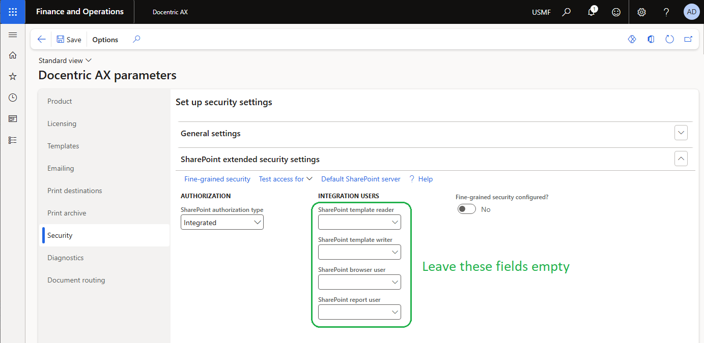

Integrated SharePoint Authorization

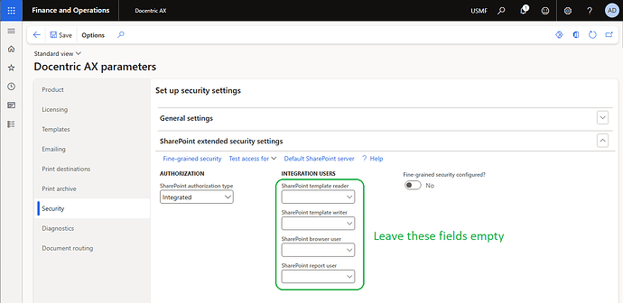

If you were using integrated SharePoint authorization for Docentric, you can continue using this type of authorization, by clearing the Integration Users fields located in Docentric AX parameters:

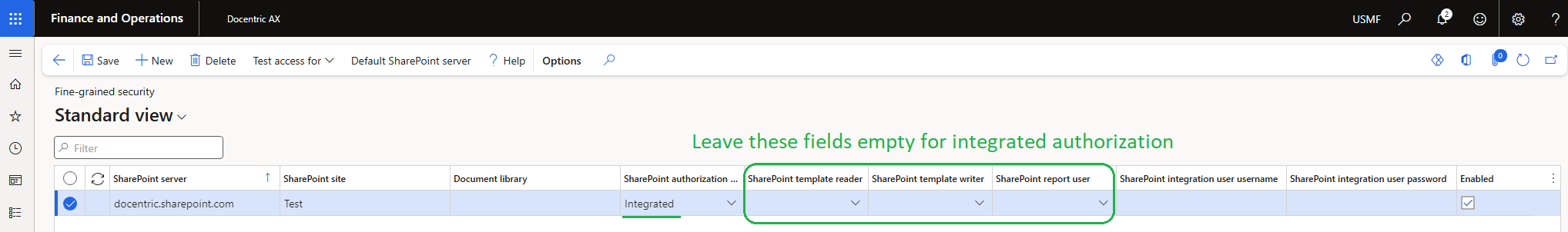

Additionally, you will have to clear any fine-grained security settings that you may have present for the integrated authorization type:
