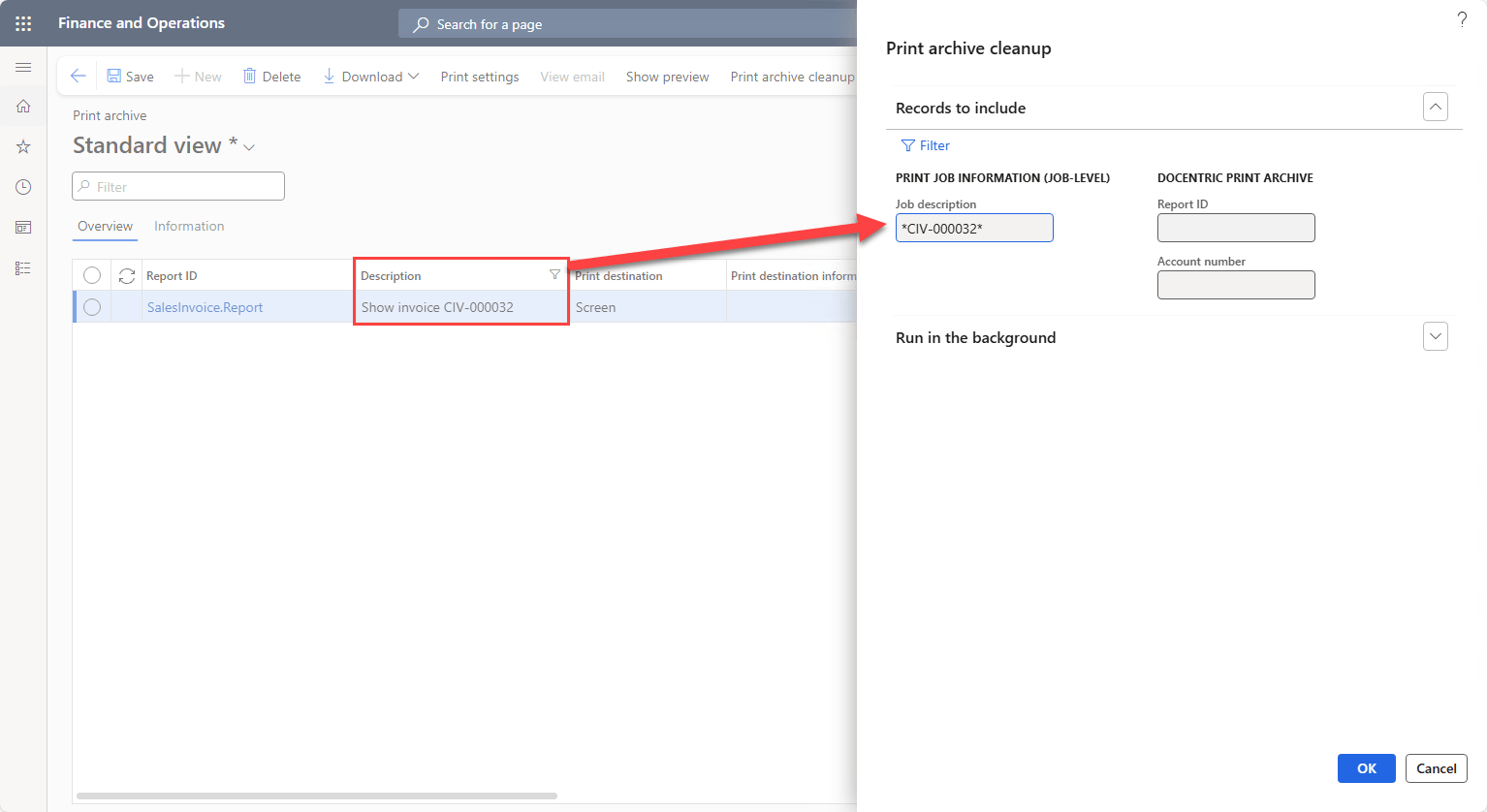

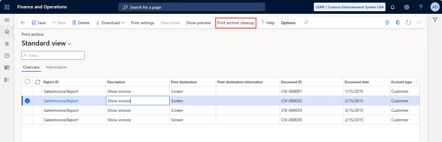

Print archive cleanup
If you make intensive use of the Print archive, the database size can grow significantly over time.
To help you manage it, we’ve added the Print archive cleanup job, which can delete old or unnecessary Print archive records either interactively or in batch.
You can access it from Organization administration > Inquiries and reports > Print archive > Print archive cleanup.
To see the menu item and open the dialog, you must either have the System administrator role or be assigned the Maintain Print archive for all users duty (DocPrintArchiveAllMaintain).
You can define which Print archive records to delete using the Records to include filter. Apply filters to refine the query and target specific or older archived documents. If you’ve already set filters in the Print archive grid, the Print archive cleanup dialog will open with those same filter values pre-filled automatically.
A soft limit of 10,000 records per job helps prevent performance issues. If the number of records exceeds this limit, a confirmation dialog warns you before proceeding.
The deletion of corresponding archived report documents stored in Azure Storage or SharePoint is controlled by the Document removal options setting on the Document type used for archiving.
