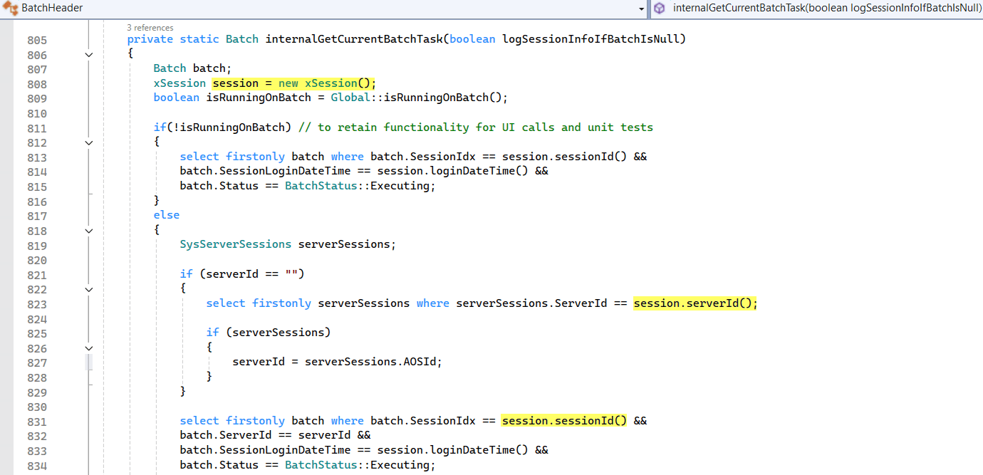

runAsync() can be called from an interactive session or from a batch job. The batch job processor executes each batch task in one of the available batch (worker) sessions. If the batch job code calls runAsync(), it executes the called method in a separate async session, which is not one of the available batch sessions.
Here comes the catch. The standard batch API (for example, BatchHeader::getCurrentBatchHeader()) looks up current batch info by the current session ID in the Batch and SysServerSessions tables. As the async session has a different session ID, it returns null. There is no way to get the batch info from async session itself, but you can use the workaround passing the caller session ID as async method parameter and use it to get the batch info.
