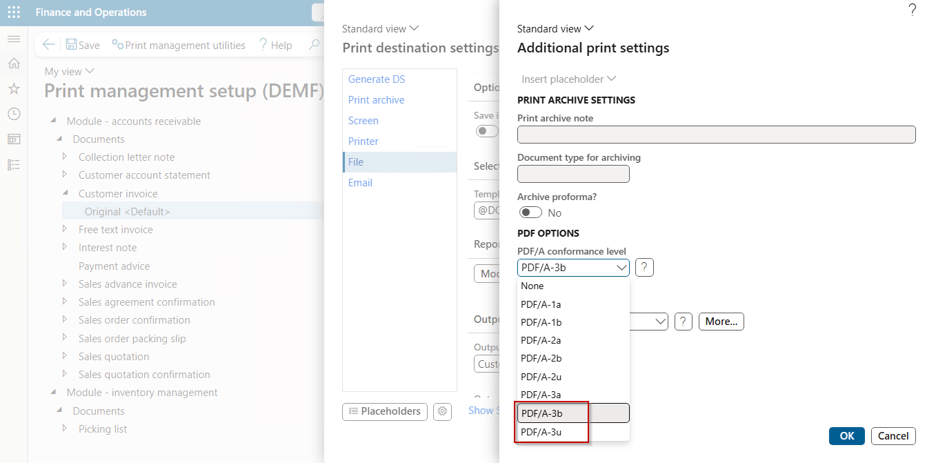

Configuring the correct compliance level is handled entirely within the Docentric Print Destination settings. How? Just follow these instructions:
  1. Open the Docentric print destination: Go to Print management settings for your report (e.g. Customer invoice) and open the Docentric File or Email print destination settings form.
  2. Ensure PDF output: In the Print destination settings, verify that the Output file format is set to PDF.
  3. Enable PDF/A Conformance: Using the More button on Print destination settings open the Additional print settings form.
  4. Select PDF conformance level: Choose either PDF/A-3b (standard) or PDF/A-3u (if Unicode is required by your customer).
Note: Based on this setting, Docentric will modify the PDF header of the generated file so that it’s identified as a PDF/A-3 document. This prepares it for the XML embedding.

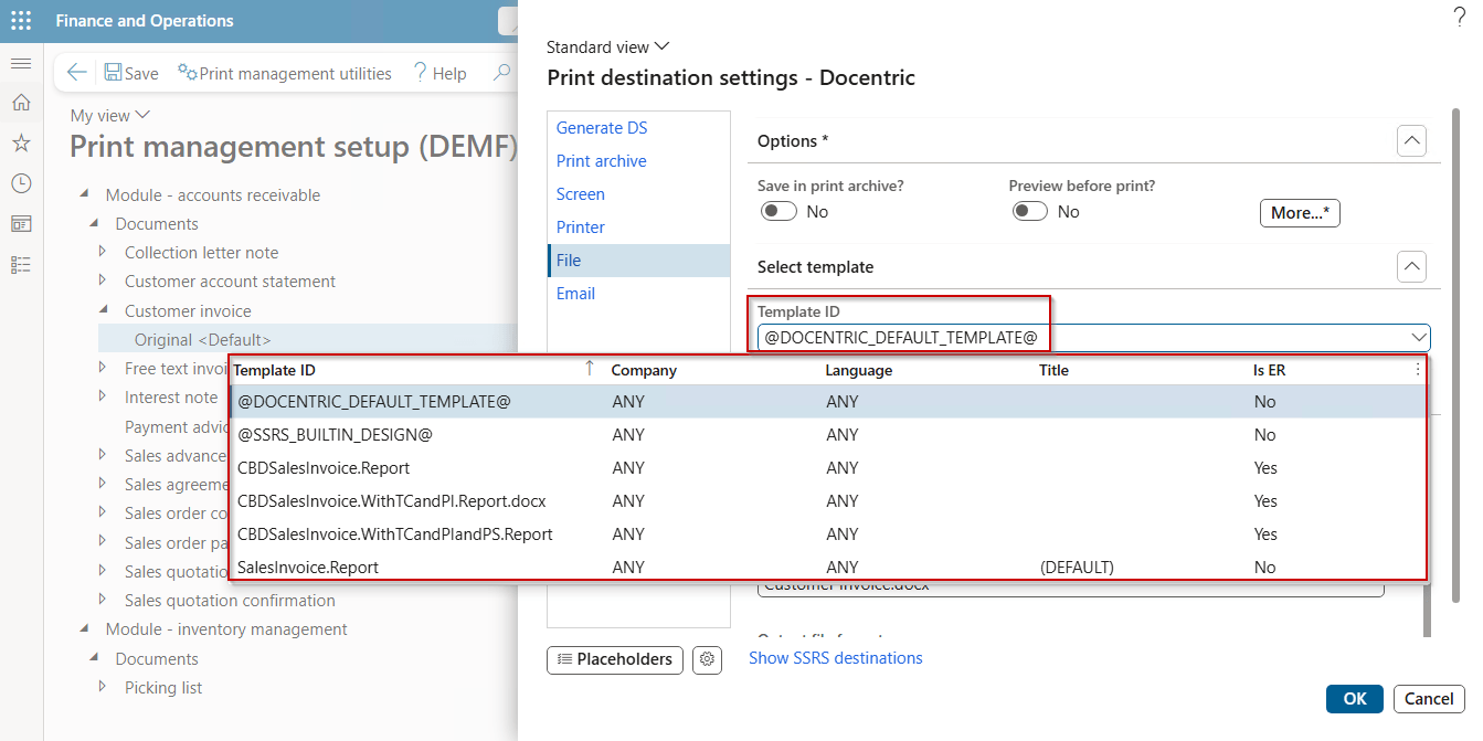

How to configure
You can select your desired template directly from the Print destination settings, exactly in the same way as for any other report:
  1. Open Print Destination Settings: Use the Docentric Print destination settings for Customer invoice (e.g., via Print Management).
  2. Select Template ID: Use the Template ID dropdown to choose your preferred design.

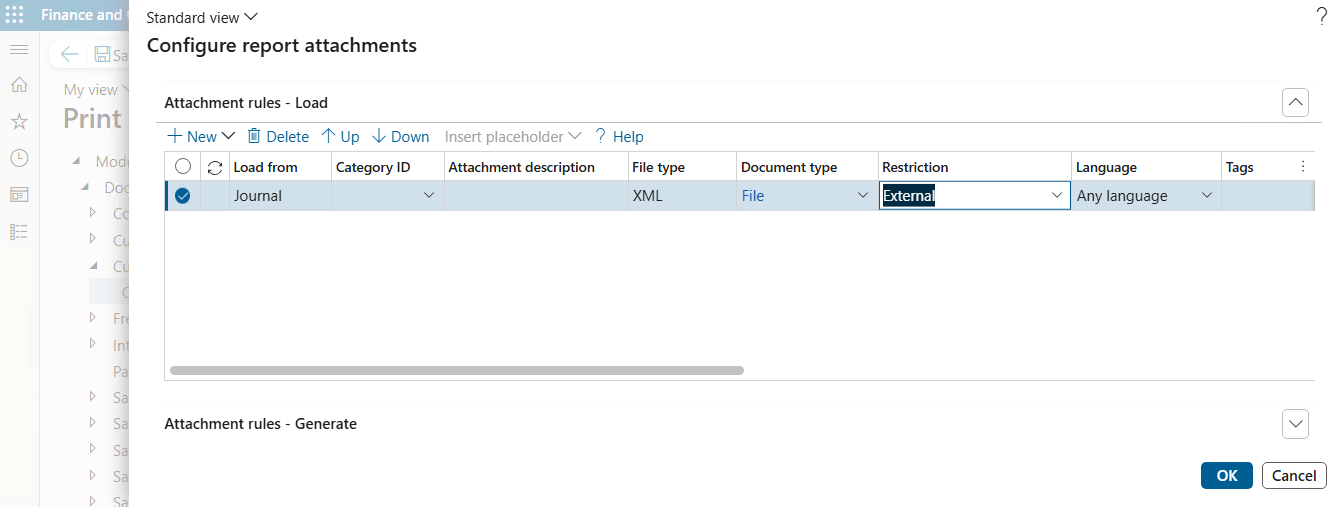

Option A: Embedding an Existing XML (Attachment Loading Rules)
You need to have a valid XML invoice file already generated by using an ER format configuration, a custom X++ process or a third-party system. With assumption that it is stored in D365FO as a Customer invoice journal attachment, you use the below or similar Attachment loading rule. Make sure that the rule criteria clearly points to your XML file, and the loaded attachment will be “printed” as PDF attachment, or in other words: embedded into the PDF as attachment.
Need more details? See a detailed article on Creating Project eInvoice with embedded and merged PDF Attachments

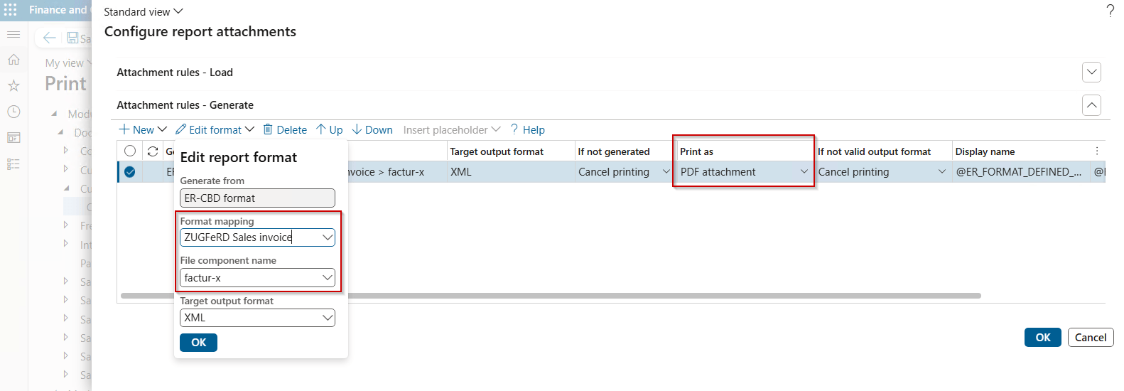

Option B: Generating XML on the Fly
This is the simplest and most integrated method. You create an Attachment generating rule to use the ER format configuration designed for ZUGFeRD XML. This will invoke the Electronic Reporting (ER) framework to generate the XML in parallel with generating the PDF. The format must produce CII compliant e-Invoice and you just need to “print” it as PDF attachment.
Not sure which option to use? If your XML is already generated elsewhere, go with Option A. For one-step ZUGFeRD invoice generation, let Docentric invoke ER to automatically create the XML and embed it into the generated PDF as PDF attachment. See the detailed guide on loading and generating attachments.

  • Attachment rule: In the Report Attachments fast tab, add a Generate rule to create the XML on the fly.
  • ER format: In the Format mapping field, select the ZUGFeRD ER Format you imported earlier and set its Print as option to PDF attachment. This ensures the machine-readable XML is embedded directly into your PDF.
