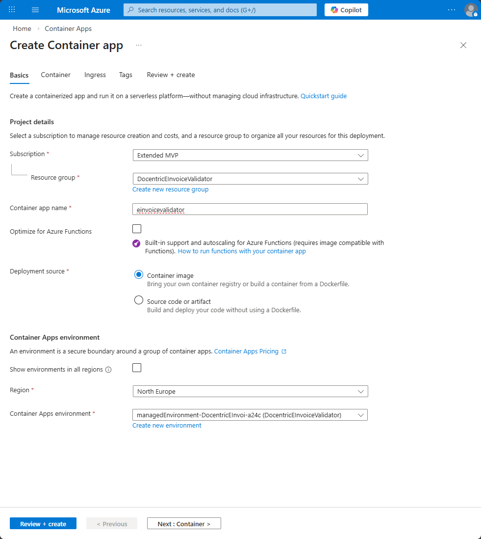

Create a Container Apps environment
  1. Open the Azure Portal
  2. Search for Container Apps
  3. Click Create > Container App
  4. Set:
    1. Resource group: create a new one, for example, rg-einvoice
    2. Container app name: einvoicevalidator
    3. Region: choose your preferred region
  5. Click Next

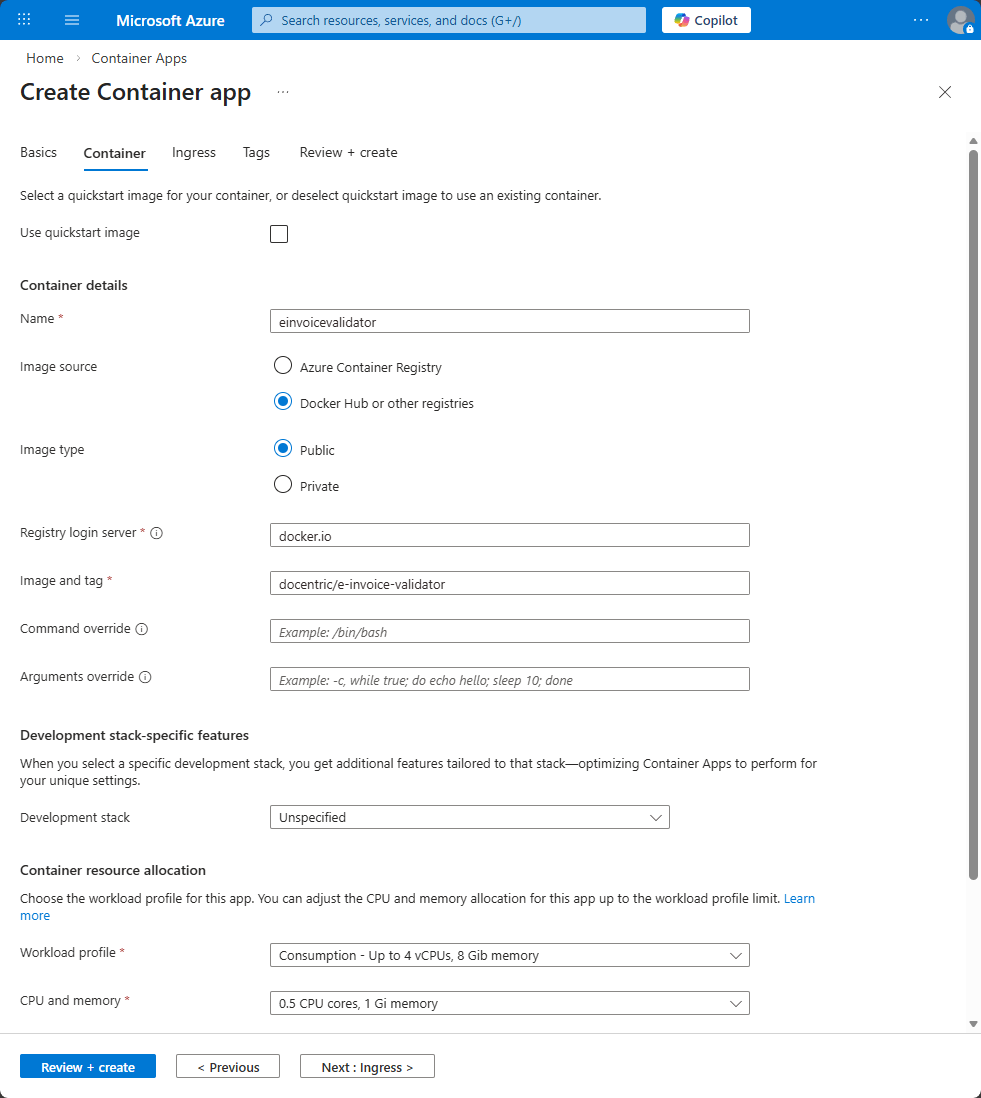

Configure the Container App
In the Container tab:
  1. Container:
    1. Disable Quickstart image
    2. Image source: Docker Hub or other registries
    3. Image: docentric/e-invoice-validator
    4. Tag: latest
  2. CPU and memory:
    1. 0.5 CPU cores, 1 Gi memory

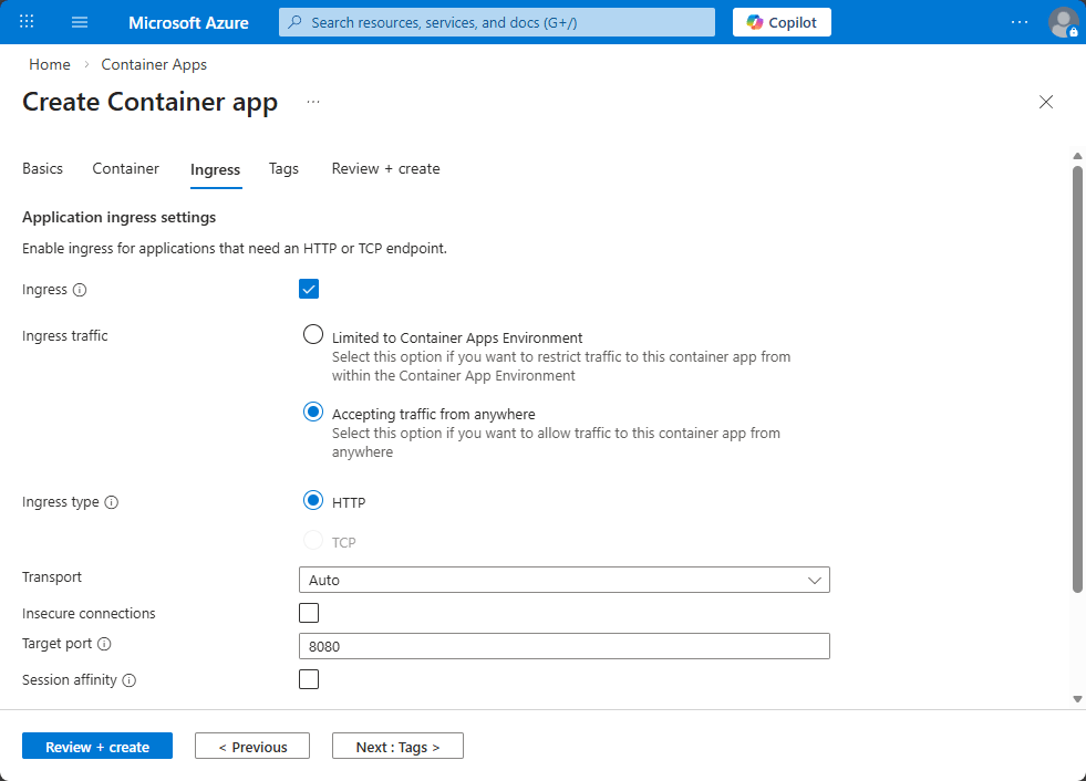

Ingress
In the Ingress tab:
  1. Ingress:
    1. Enable ingress
    2. Allow traffic from anywhere
    3. Target port: 8080
Finally, click Review + create, and once it validates, click Create.
