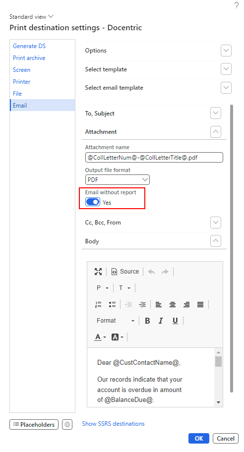

Let's demonstrate Emailing reports without attached output file on the example of the Collection letter note report. To enable sending emails without attached report, turn on the Email without report option on the Print destination settings form > Docentric Email print destination > Attachment.
