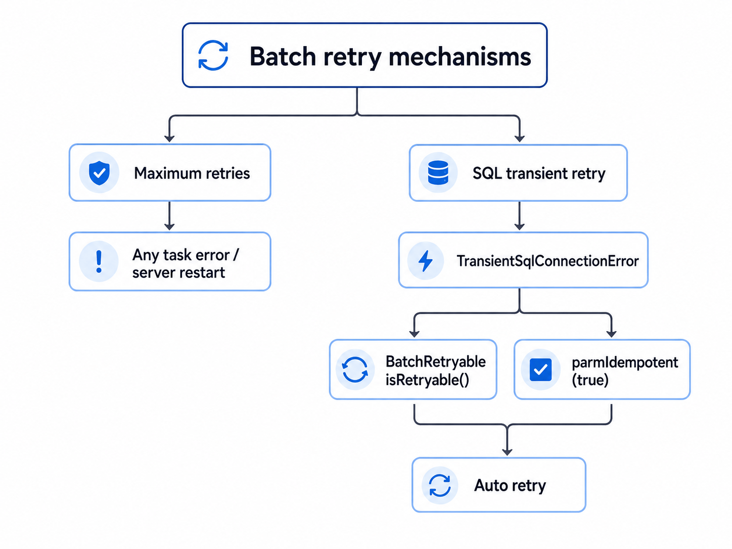

The standard implements two retry mechanisms.
First one is general batch task retries defined by the Maximum retries parameter on batch task. It automatically repeats batch task if the execution ends in Error status.
By default Maximum retries = 5, but you can change it later on the Batch jobs form.
The second retry mechanism is specifically designed for SQL transient errors. If a batch class derived from RunBaseBatch implements isRetryable()=true OR this.batchInfo().parmIdempotent()=true then the batch is rerun after a SQL transient error and it does not increment batch task Actual retries count (used in first mechanism).
Note that the retriable property can also be overridden by admin on Batch class configuration overrides form for specific classes.
