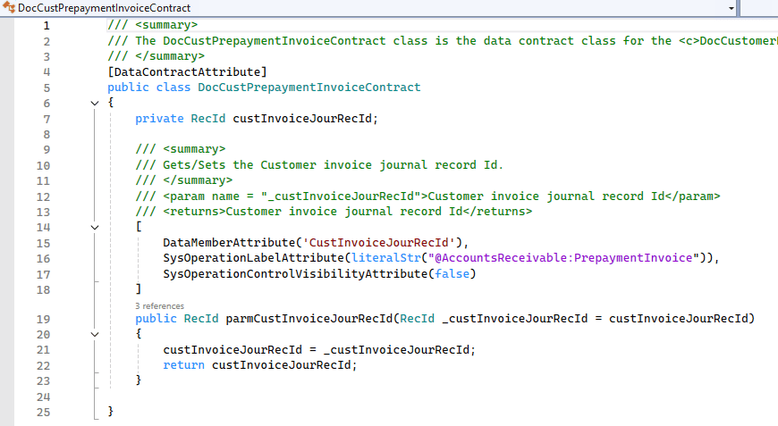

1. Create a data contract class
Think about the information you want to exchange between the UI and report engine. In this case we only need the RecId of the Customer invoice journal that was created by posting the caller Customer prepayment invoice. We named this class DocCustPrepaymentInvoiceContract and below is its content.
Some important things to notice about this implementation:
  • Decorate the class with DataContractAttribute.
  • Add a class variable for the underlying record Id and implement the related parm method. In our case the class variable is custInvoiceJourRecId.
  • We don’t want this parameter to appear on the print dialog, so we used SysOperationControlVisibilityAttribute(false), but it turned out that it wasn’t enough. The SSRS format is a master in this whole chain of artefacts, so keep reading to see how the parameter visibility is controlled there.

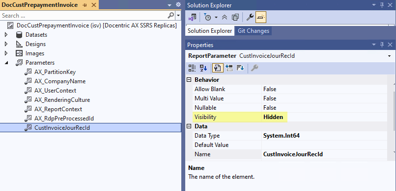

  • Expand the Parameters node, select the CustInvoiceJourRecId (remember, it’s the parameter specified in the data contract class from the step 1 above), and set its Visibility property to Hidden. This will prevent the parameter from showing on the report dialog form.

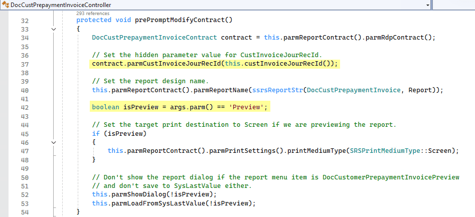

To accomplish this, we implemented the prePromptModifyContract() method:
Things to notice about this method:
  • We populate the only contract parameter, custInvoiceJourRecId, from the RecId of the caller record.
  • We initialize a local isPreview variable based on the Parameter value of the caller menu item button (remember, it can be Preview or ShowPrintDialog). If it is Preview, we force the print destination (parmMediumType()) to screen, otherwise we open the Print dialog where user will have a chance to configure the print destination.

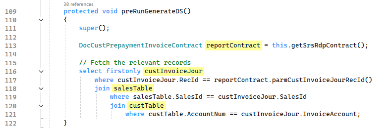

We implemented a new Docentric data source provider (DSP) class, where we decided to add the logic for generating the report data source from scratch. We named this class DocCustPrepaymentInvoiceDSP. As all other Docentric DSP classes, it inherits from the base DocDataSourceProviderSrsReporting class.
Before the actual data source generation is started, some convenient initialization can be done in the preRunGenerateDS() method. Here we obtained the data contract, because it holds the information about the caller Customer invoice journal record, and we fetched the linked records that hold the information to be presented on the invoice document:
Data source generation should be placed in the generateXmlDataSource() method. When we implement a DSP class for a fully-blown SSRS report, where data source is already generated in its pipeline, then this method usually has a call to super(), in order to preserve the SSRS-generated data source. But in this case, we are creating a data source from scratch, so we omitted the call to super().
We create one header record called Prepayment header, which has 2 sub-records, Invoice information and Customer information. We populate them with the relevant fields, based on what we saw in the ER model. Then we create a list of lines records, called Prepayment line (we explained earlier that there will be actually only one prepayment line, but it shouldn’t prevent us from creating a list with only one record.
In Docentric DSP classes we typically implement some custom placeholders, for information that users might want to use in combination with e.g. file names, email subject or body, etc. We implement these placeholders in the overrideReportRunSettings() method, which must be decorated in an appropriate way. Here you can see the beginning of this method and its decoration:

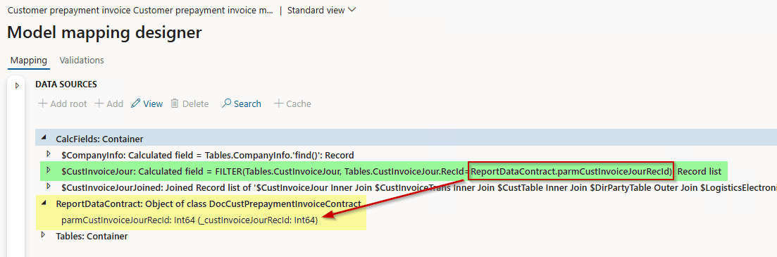

Below are the configured data sources in the original model mapping configuration. Entry point to this model is the caller CustInvoiceJour record, which is provided as a parameter when invoking the execution of the ER format configuration.
The information about the caller record and the ER format configuration is tightly bundled and Docentric cannot reach between the two of them to obtain the report context. Therefore, we need a new model mapping configuration that is based on the report data contract we created for the SSRS report, because we will be able to get the caller record from it.
The image above shows the derived model mapping configuration where we made the following modifications to the data sources:
  • We added a ReportDataContract object of DocCustPrepaymentInvoiceContract. Its parmCustInvoiceJourRecId() method will return the RecId of the caller Customer invoice journal record.
  • We modified the expression for the $CustInvoiceJour calculated field. In the original configuration it was provided directly from the caller, but in our configuration we need to filter the CustInvoiceJour table to match the caller CustInvoiceJour record.
