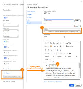

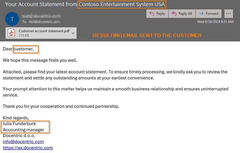

When emailing a Customer account statement report with the standard D365FO functionality, you run into a few issues:
- Fixed email subject and body: You have to manually change the email subject and body every time you send the report.
- Limited email body editor: The small editor introduced in version D365FO 10.0.39 makes it hard to see the full content and doesn’t allow adding dynamic report data.
- Fixed report attachment: You can only use fixed text for the report attachment.
- Complex print management: To use multiple templates for email print destinations, you need a print management setup for each customer account, leading to many print management overrides with the same issues.

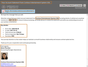

Docentric solves these problems by letting you customize email subjects, bodies, and attachments dynamically using all the report data. This improves email communication and helps avoid mistakes.
As you can see, emails generated with Docentric are richer and more informative.

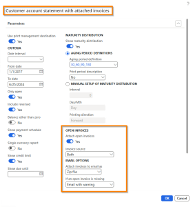

To make this work with Docentric, we’ve introduced a new report dialog for the customer account statement with extra parameters.

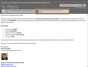

When you email a customer account statement with the open invoices attached, the generated email will look like this:
It’s super simple! Just configure the additional parameters, and all open invoices will be attached to the outgoing email. 😉

Once you've made these changes, the report dialog will look like this:

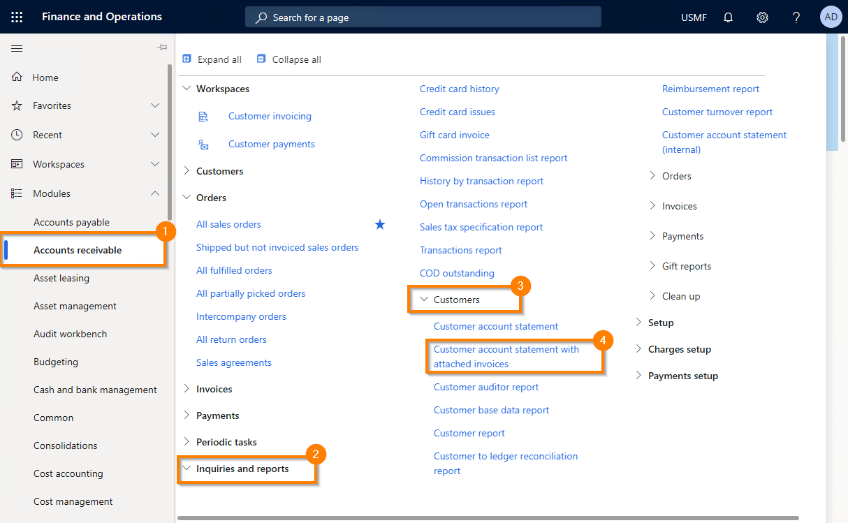

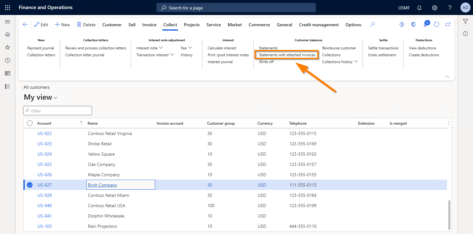

To keep the enhanced report separate from the standard one, we’ve added a new menu item under the Accounts Receivable module:
- Path 1: Customers > All customers > Collect > Customer balances > Statements with attached invoices
- Path 2: Inquiries and reports > Customers > Customer account statement with attached invoices
This makes it easy to find and use the new report dialog.

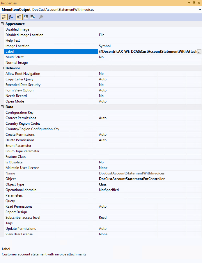

This new menu item is accessible through standard roles. So, if you can access the standard report, you can also run the enhanced one. We achieved this by extending the standard security duties.

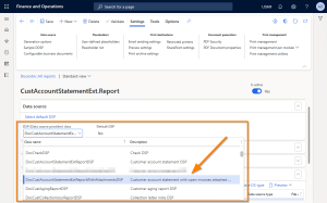

After making all the previous changes, we’re almost ready to run the enhanced Customer Account Statement report and retrieve all the open invoices as additional attachments. But before we do, we need to adjust the report settings in Docentric setup and select the correct DSP class.
You can also customize how the outgoing email looks. Use the Docentric Email print destination to define and use Report Email templates, which can even be resolved in another language.
