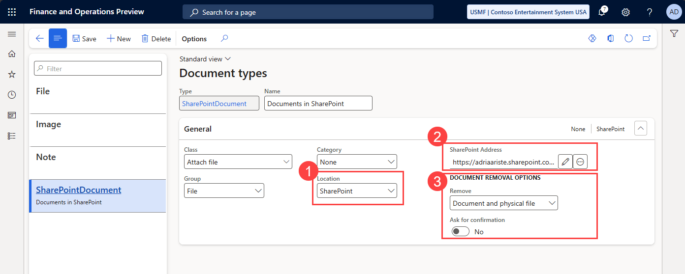

Configure a Document type
To enable SharePoint as a location for storing the archived documents, go to Organization administration > Document management > Document types and create a new type:
  1. Location: select SharePoint.
  2. SharePoint Address: click the edit button and select the site and folder where you want to store the documents.
  3. Document removal options: here you have two fields that enable an interesting behavior for what you wish to achieve.
    1. Remove: choose between Document and physical type that deletes the file from SharePoint and the document in D365FO, or Document only, which only removes the reference to SharePoint in D365FO.
    2. Ask for confirmation: enable it to ask the user for confirmation of the deletion.
Thanks to the Remove option, you can clean the Print archive records while keeping the printed documents on SharePoint.

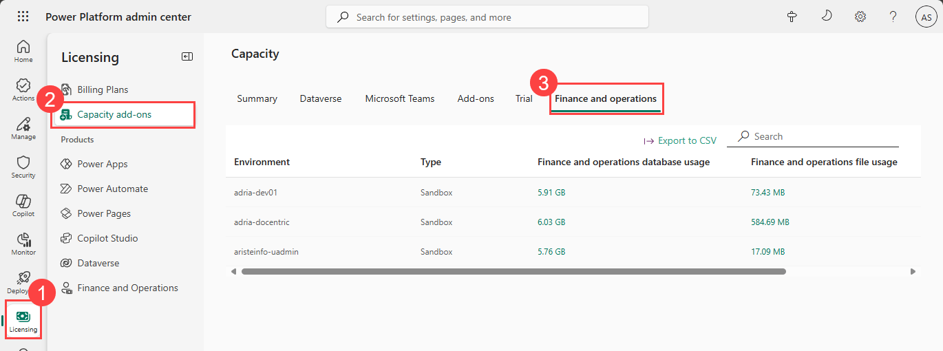

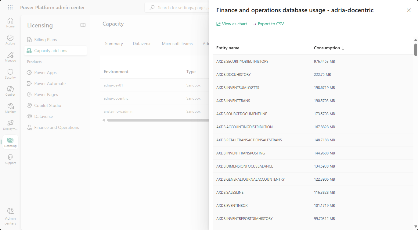

You can check your top consuming tables in the Power Platform admin center (PPAC):
Go to the Licensing menu, click Capacity add-ons, and then select the Finance and operations tab.
Here you have two columns:

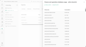

  • Finance and operations database usage: it shows the D365FO DB size. If you click it, a side pane will open, displaying a list of the tables ordered by size.
  • Finance and operations file usage: it shows the overall file storage consumption. There are no details even if you click it.
The database usage pane displays the table list and lets you export a CSV file with the contents:

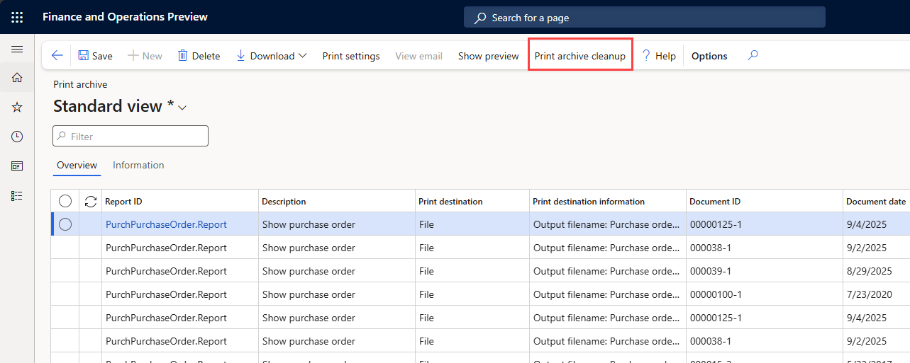

To run the Print archive cleanup job, go to Organization administration > Inquiries and reports > Print archive. You will see the Print archive cleanup button in the action pane.
To see the menu item and open the dialog, you must either have the System administrator role or be assigned the Maintain Print archive for all users duty (DocPrintArchiveAllMaintain).

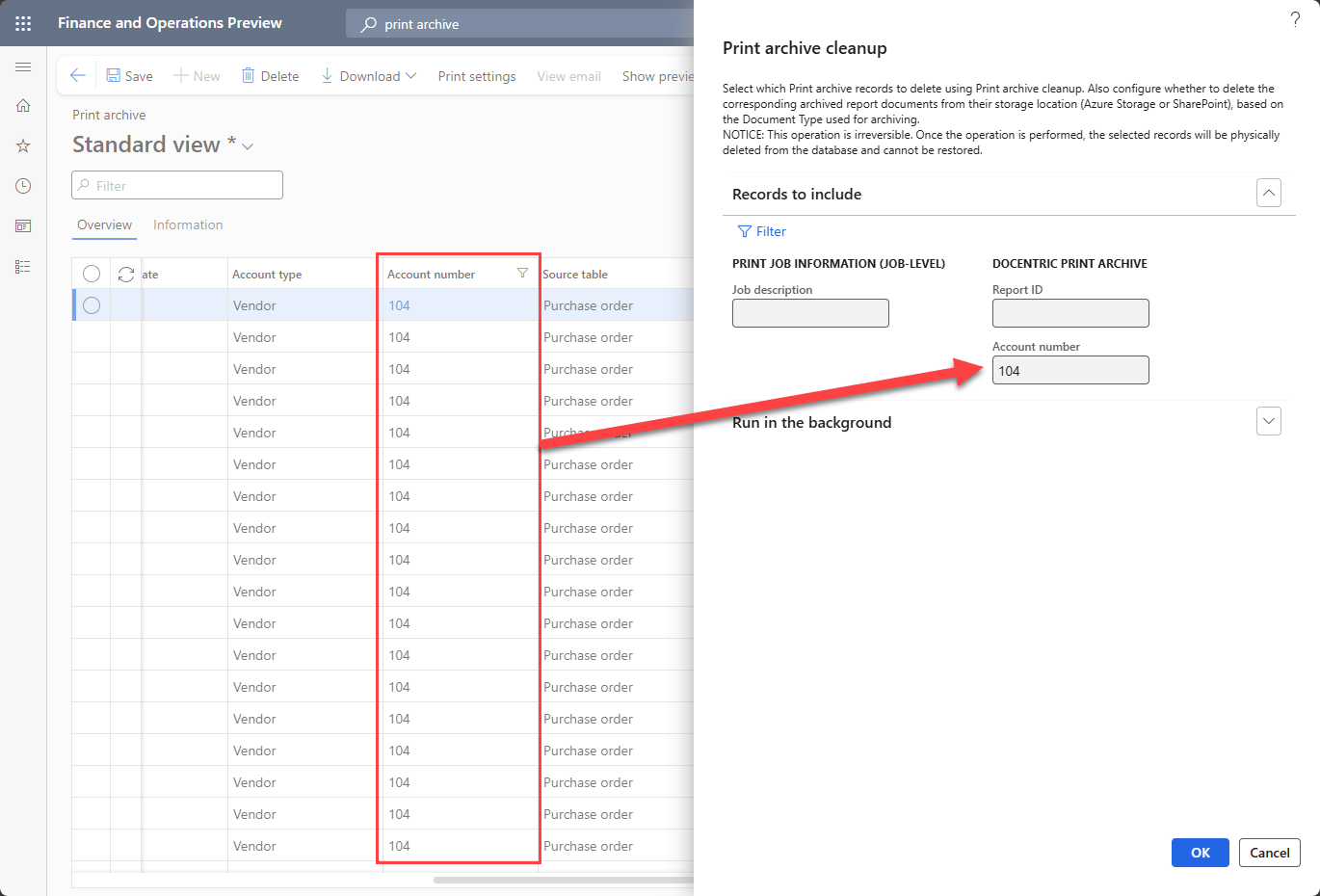

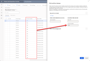

Clicking the menu item will open a dialog with a pre-built query filter. If prior to clicking the menu item you applied any filter to the form's grid columns, the filter condition will be already applied to the query. For example, if we filter on account number DE-001:
The Account number field in the query is automatically populated. If you don’t add any filters, you can build the query manually or leave it empty and clear all records.

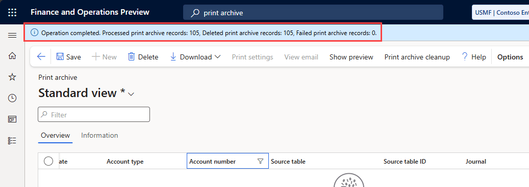

Once the process finishes, a message appears showing how many records were deleted.
