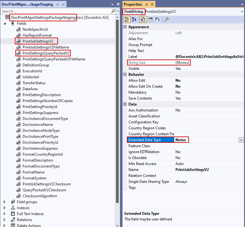

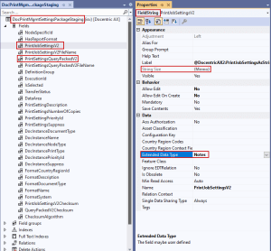

  1. The first step is to create a new field on the staging table of the data entity, that should be named the same as the actual container field on the original table that is the data source of the data entity.
    Make sure that this staging table field is of type string and that it uses the EDT Notes (it will probably also work with any other string EDT that has a (Memo) string size).
    In our case, these fields are PrintJobSettingsV2 and PrintSettingsQueryPackedV2:
