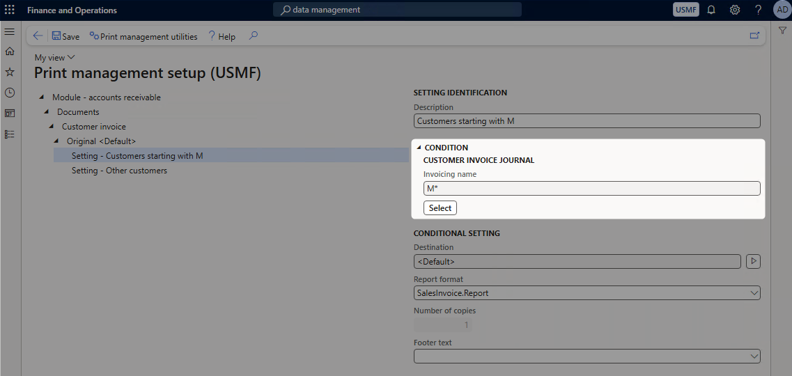

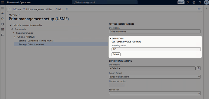

I am currently working for a customer there have created 2 templates one for customers start with M in customer number and other the rest of the customers i, but I want to use one template for the customer start with M and the rest should use the default template. It is in same legal entity and same language they are using.
Hi @dhe and welcome to the Docentric Community!

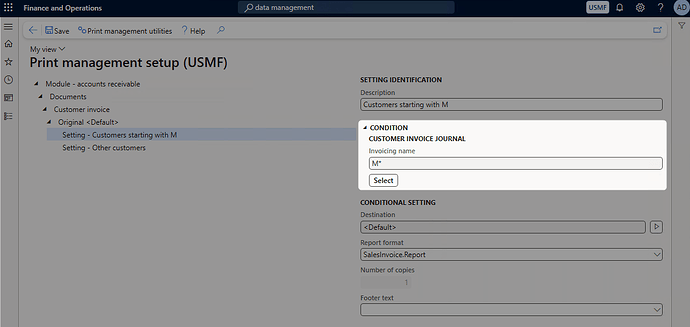

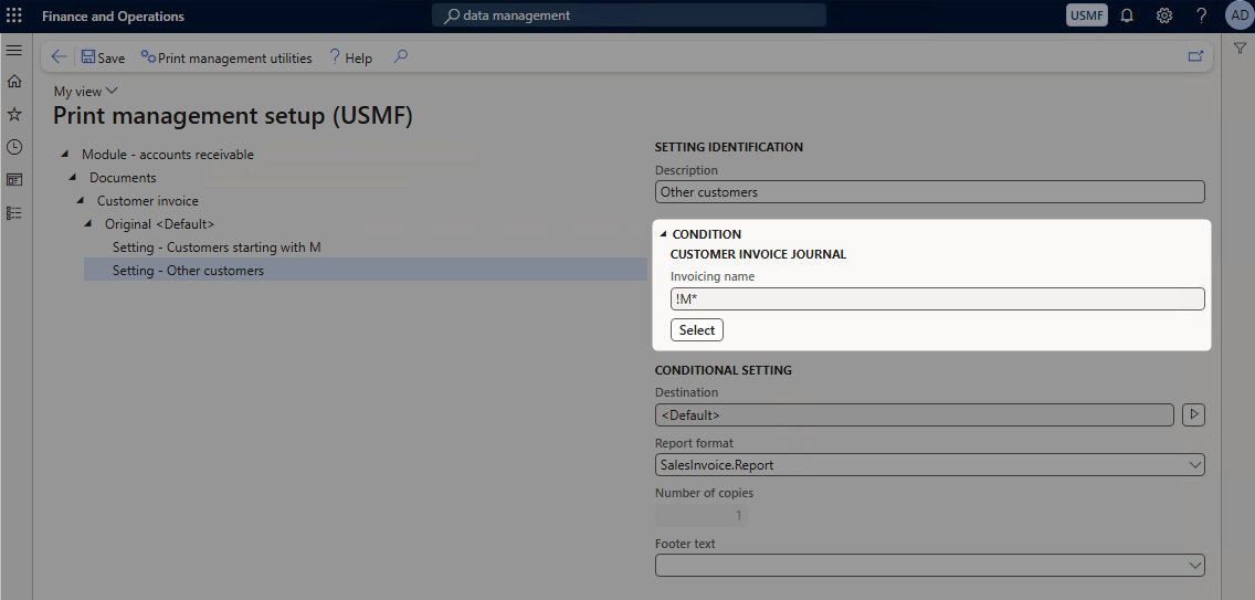

I believe that the best way to cover your scenario would be by using Conditional Print Management Settings

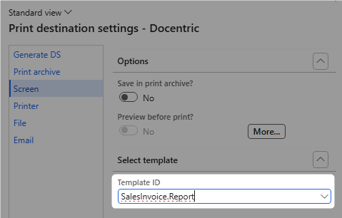

You would simply define one Print Management Setting for customers starting with M and have it’s own report template selected on its Docentric print destination.
The other Print management setting would have a condition to filter out and use the report template for all other customers that have their names starting with all characters other than M.
You can choose the template on any of the Docentric print destinations.
