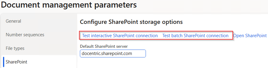

When this feature is enabled, first test menu items on the SharePoint tab on Document management parameters form. The interactive connection is ready to use on Tier2+ environments (UDE, Sandbox, Prod) but does not work on development environments (Tier1 onebox (CHE or VHD)). The batch connection does not work by default, but can be enabled and the works on all environments (explained later).
Each of the above menu items (interactive, batch and Open SharePoint) uses different technique to access SharePoint, so do not assume that all three work if you test just one. Interactive connection uses On-Behalf-of-a-User access, batch connection uses App-only access and Open SharePoint opens SharePoint site in browser.

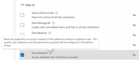

If you would like to limit D365FO permissions to selected SharePoint sites than you can use Sites.Selected pemission instead of Sites.ReadWrite.All and then use Graph API to set permissions on the site level (more details here).

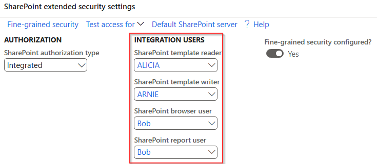

If you were using Integrated authorization type with specific integration users it will not work anymore as user impersonation is not supported anymore (and will soon be blocked by the SharePoint).
You will get the error “Integrated SharePoint authorization type is not supported for user impersonation” shown below.

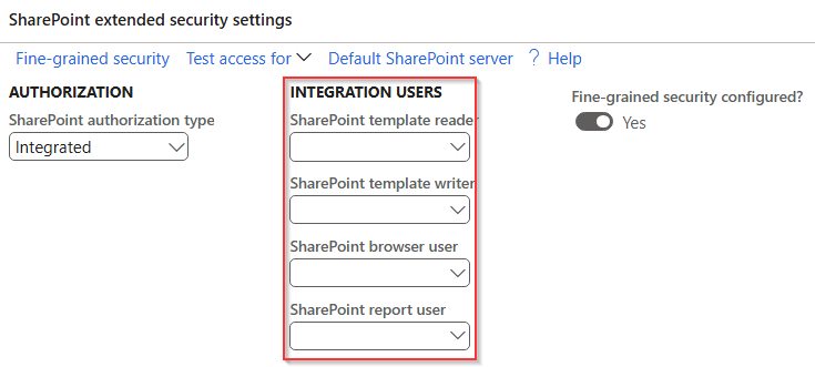

But you can leave the integration users fields empty, which means that active user will be used to access report templates and store reports. It will work fine if all required users have required permissions on these SharePoint folders. On report template folder grant read access to all and write access on to the users that need to upload new templates.

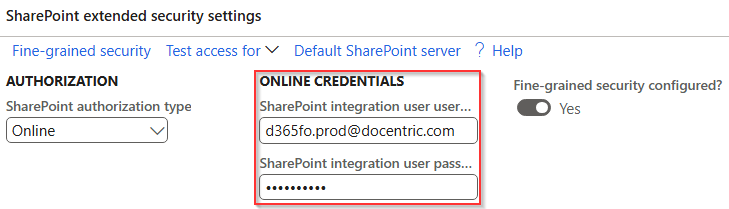

Online authorization type
If you do not want your D365FO users to directly access report templates you can use Online authorization type. That option is not affected by infrastructure changes. You need to provide the username and password of an integration user that is used to access SharePoint.

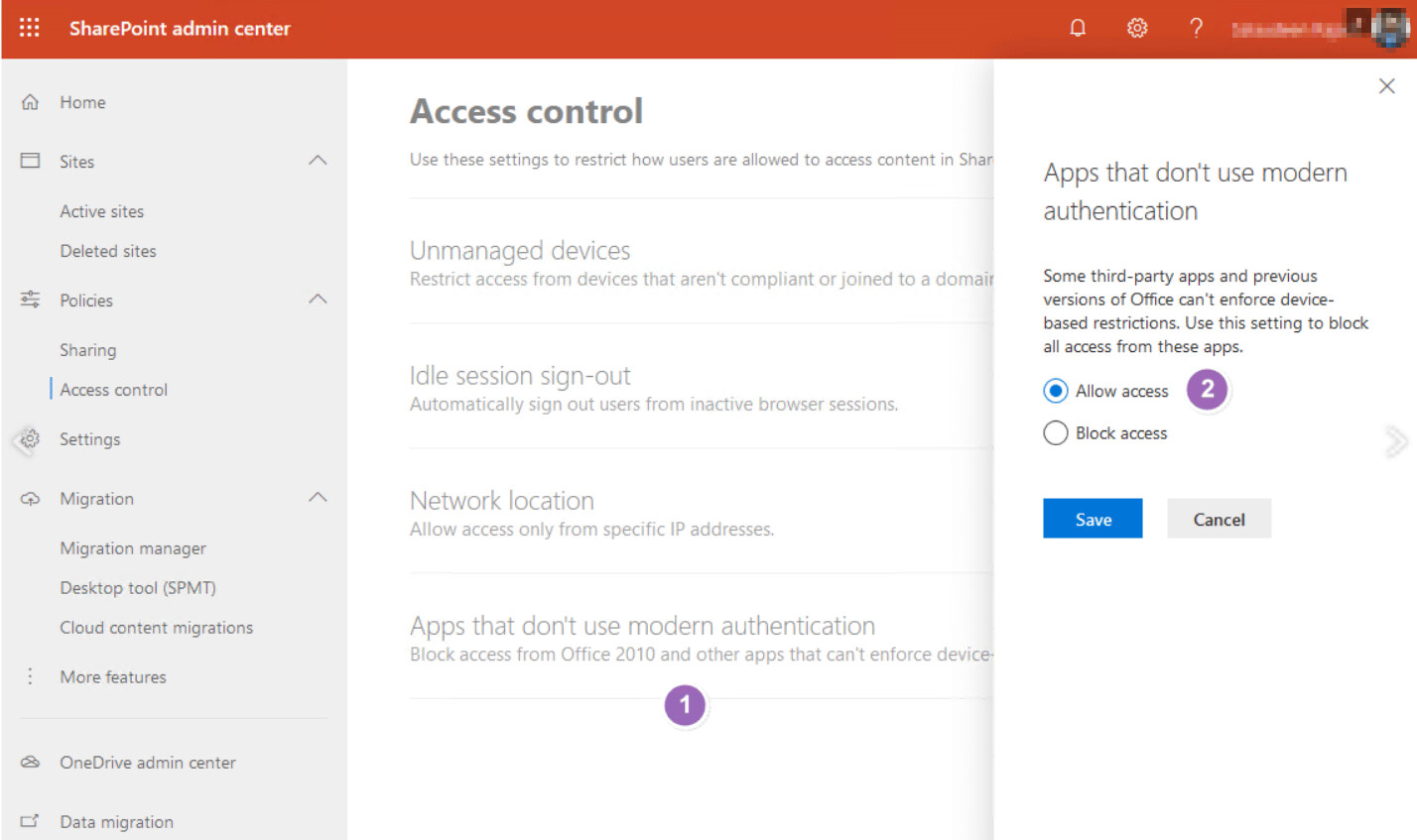

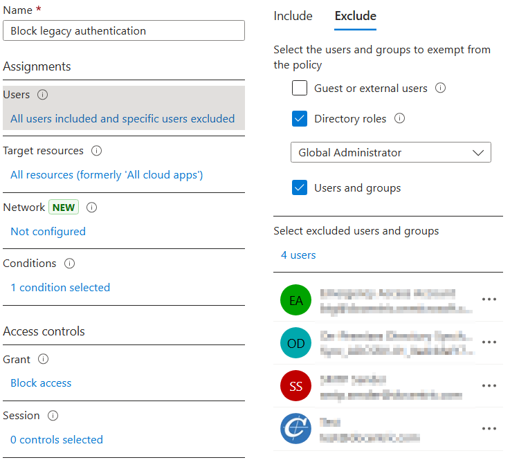

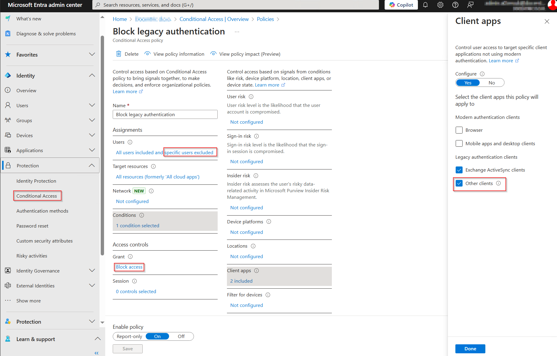

Basic authentication (without MFA) is used so it needs to be allowed for selected integrations user. In order to achieve it the following settings are required on your tenant (ask your tenant admin to check and adjust it):
- Third-party app without modern authentication should be allowed on SharePoint admin center.
- On Entra admin center make an exception for this user on a conditional access policy that blocks legacy authentication (and enforces modern authentication).

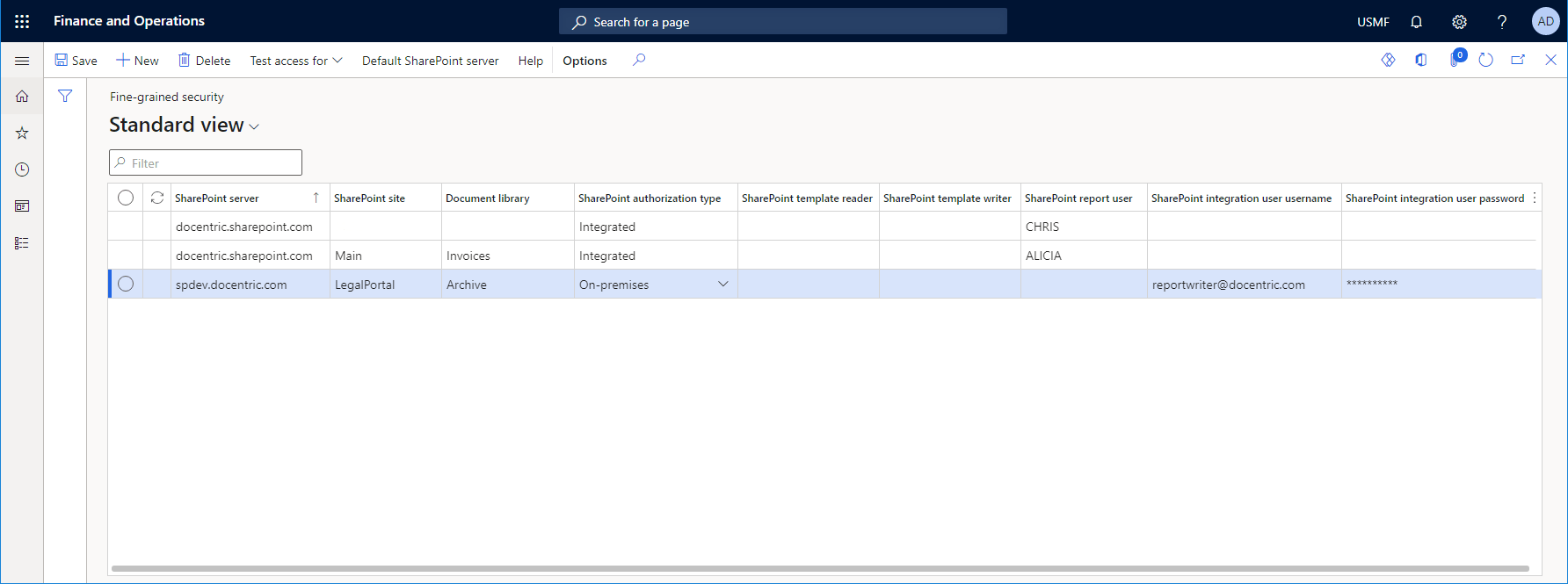

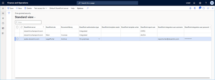

Fine-grained security
With Fine-grained security you can define different security settings for different SharePoint sites and document libraries (for all unspecified default security settings are used). With this you can use Online specific integration user for templates and Integrated active user for other purposes.
