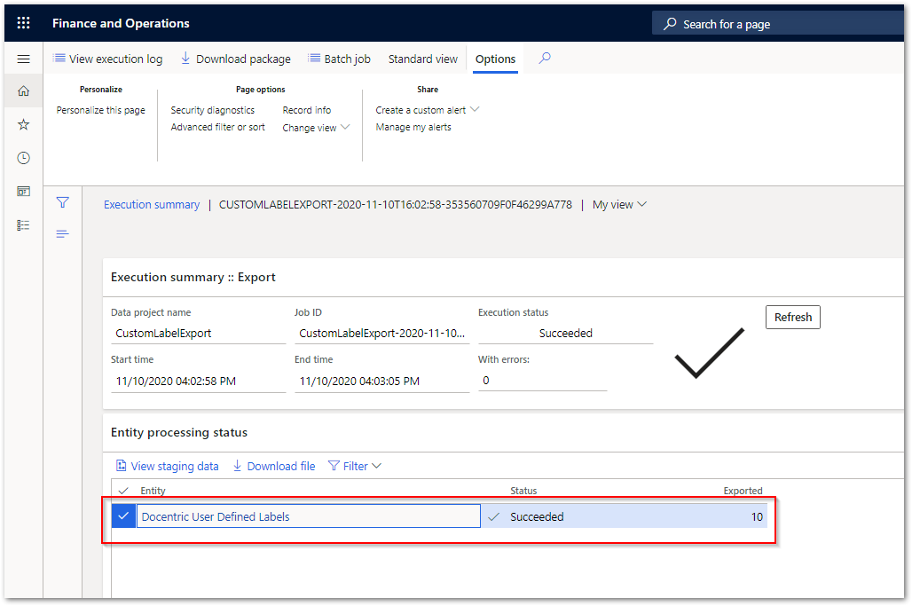

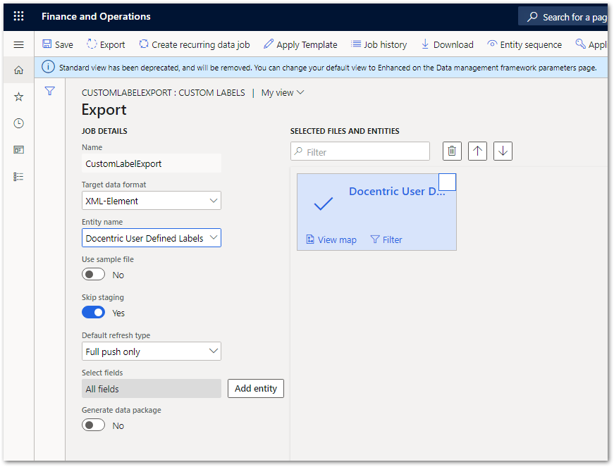

You will find the export option on the User-defined labels form here:
However, it is not possible to import the generated file to another environment. You can to do this only via Data Management :
Here you will find a series of step-by-step videos. May I ask you to watch the first three videos, which should help you to create and export an XML file with the labels:
https://ax.docentric.com/get-started-with-docentric-print-management-data-entity/
https://ax.docentric.com/copy-print-management-settings-between-legal-entities/
https://ax.docentric.com/copy-print-management-settings-between-environments/
You will also find instructions on how to import the same file to another environment.

Data entities approach

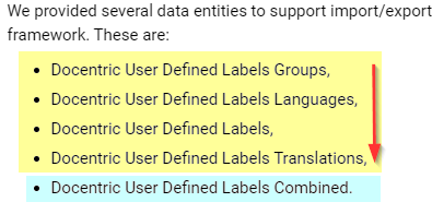

Data entities related to user-defined labels are listed in this manual:
https://ax.docentric.com/d365-how-to-manuals/d365-setup/d365-data-management/d365-import-export-user-defined-labels/
You can export-import one by one Groups, Languages, Labels and Translations by using the corresponding data entities in the same order as they appear in the list below, or you can do it all at once by using the combined data entity. Though the second approach is simpler, it may not be bulletproof for some complex scenarios, so if you encounter problems with it, please revert to the one-by-one approach.
If you are new to D365FO data entities, please read the standard Microsoft instructions. You will find even better step-by-step instructions on our pages, for another Docentric data entity (Print management) and the process should be very similar:
https://ax.docentric.com/d365-how-to-manuals/d365-setup/d365-data-management/export-and-import-print-management-settings/

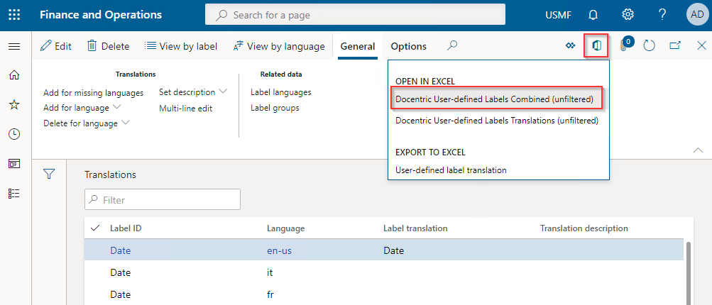

If you decide to use the combined view, instructions for Open in Excel are:

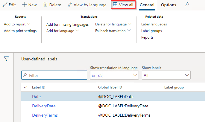

  1. Open the User-defined labels form
  2. Go to the combined view by clicking the View all menu item

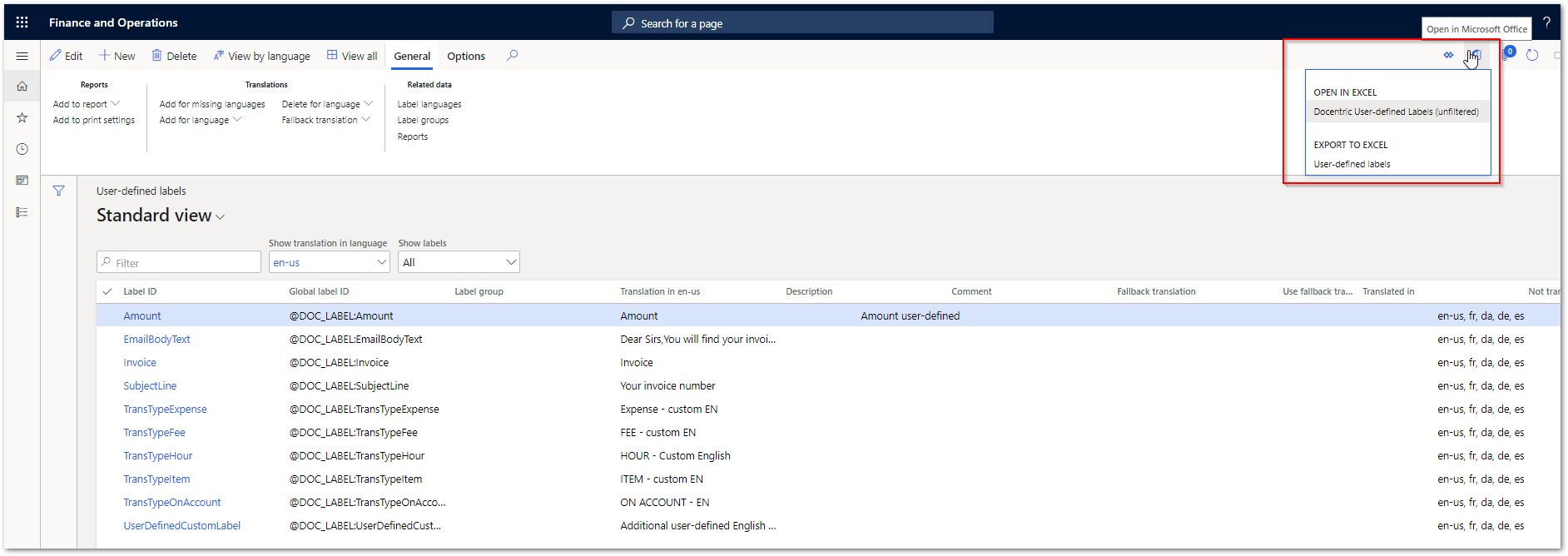

  1. Click the Office icon > Open in Excel > Docentric User-defined Labels Combined

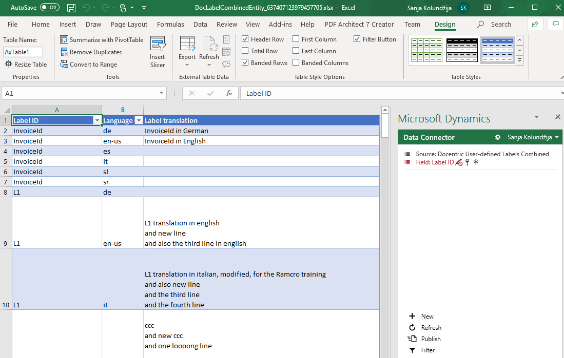

  1. You will get the result in Excel:
