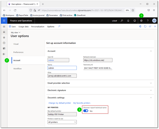

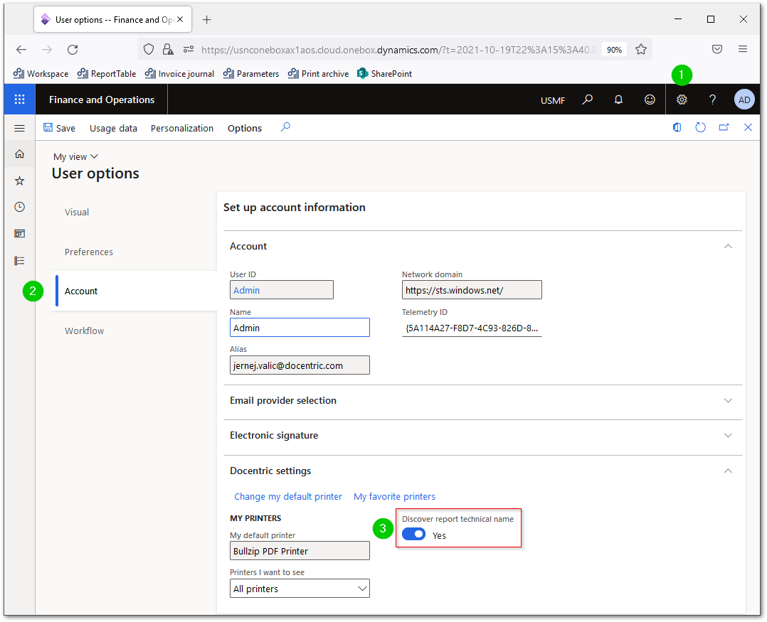

To determine the exact report technical name, we need to enable the following setting in User options (learn more):

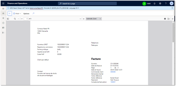

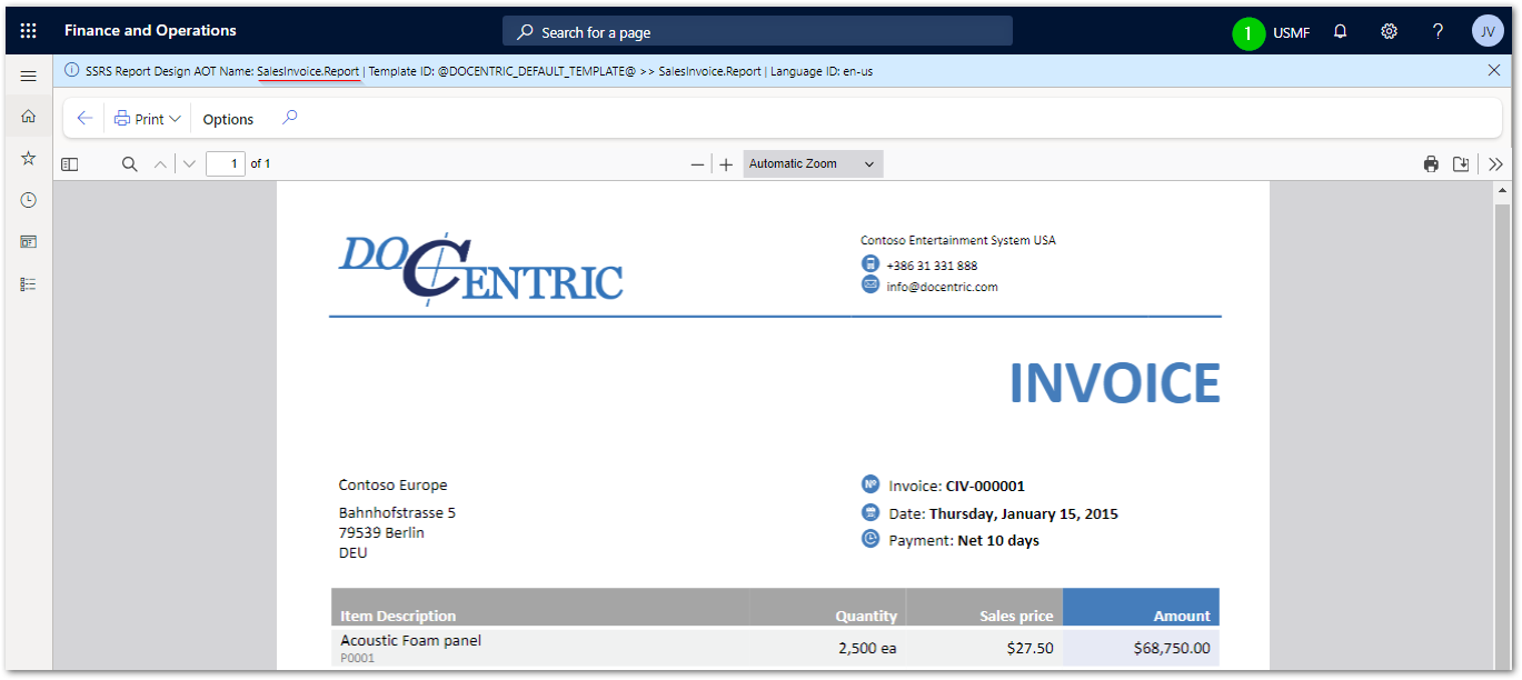

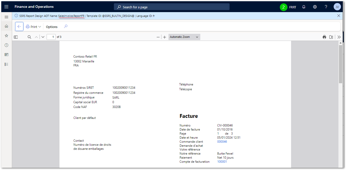

Now, when printing the same report from different legal entities, you will see the names of the reports displayed in the message bar at the top of the screen.
As you can see, printing a sales invoice from three different legal entities results in different technical names of the report:
  • SalesInvoice.Report
  • SalesInvoice.Report_FR
  • SalesInvoice.Report_IT

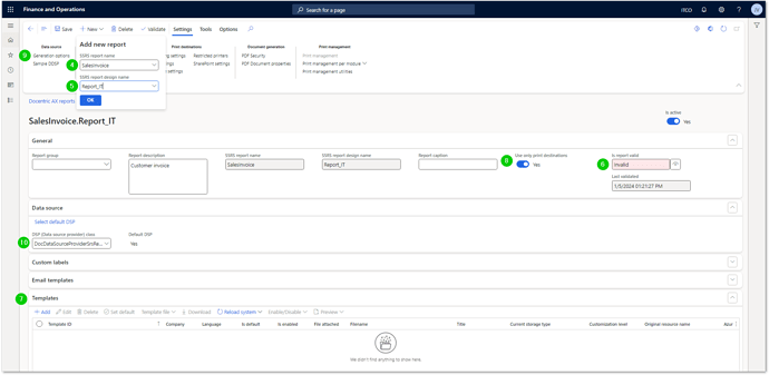

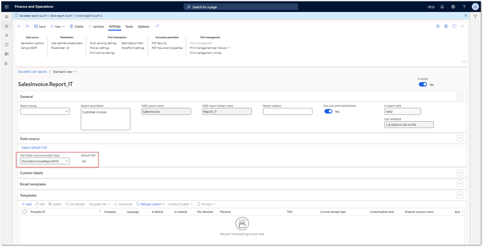

  2. If you do not see this report name registered (e.g. SalesInvoice.Report_IT), click on the New button to register this report;
  3. Enter the exact name of the SSRS report and the design (see below, 4 and 5);
  4. As you can see below, no templates are yet available for this report, resulting in a temporary validation warning (6 and 7);
  5. Activate the Use only print destinations setting (8) to be able to run this report based on the existing SSRS design (Optional: Validate the report after this setting is enabled);

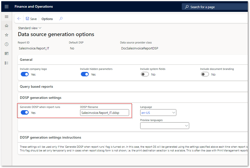

  6. Click the Generation options menu item (9) to activate the generation of the data source (learn more)
  7. Note that the DSP class selection (10) is set to Default DSP for all newly registered reports.

On the other hand, if you register a variant of the report (i.e. a localized or customized SSRS report) that already exists as a Docentric replica, as in your case, we need to change the DSP class to be used for this report.
The DSP class affects the structure of the report’s data source and allows you to take advantage of Docentric’s advanced reporting features (learn more), such as Docentric replica templates, enhanced emailing capabilities, report-specific placeholders, etc.
In the case of the Italian localization of the sales invoice (SalesInvoice.Report_IT), we therefore choose the same DSP class as for the SalesInvoice.Report: DocSalesInvoiceReportDSP. Below we can see the final setup for the SalesInvoice.Report_IT that has just been registered:
Step 4: Creating a matching DDSP for the localized report
Once the data source generation has been activated, we can generate the DDSP and finalize the setup, including the report template.

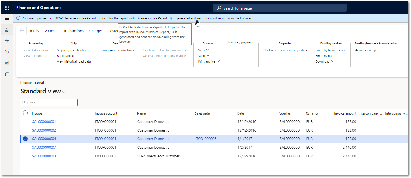

In order to use one of the existing sales invoice templates (an existing Docentric replica or one of the custom report templates) for use with the localized SalesInvoice.Report_IT, we need a matching data source file (DDSP). The DDSP will be downloaded to the browser when we run this report.

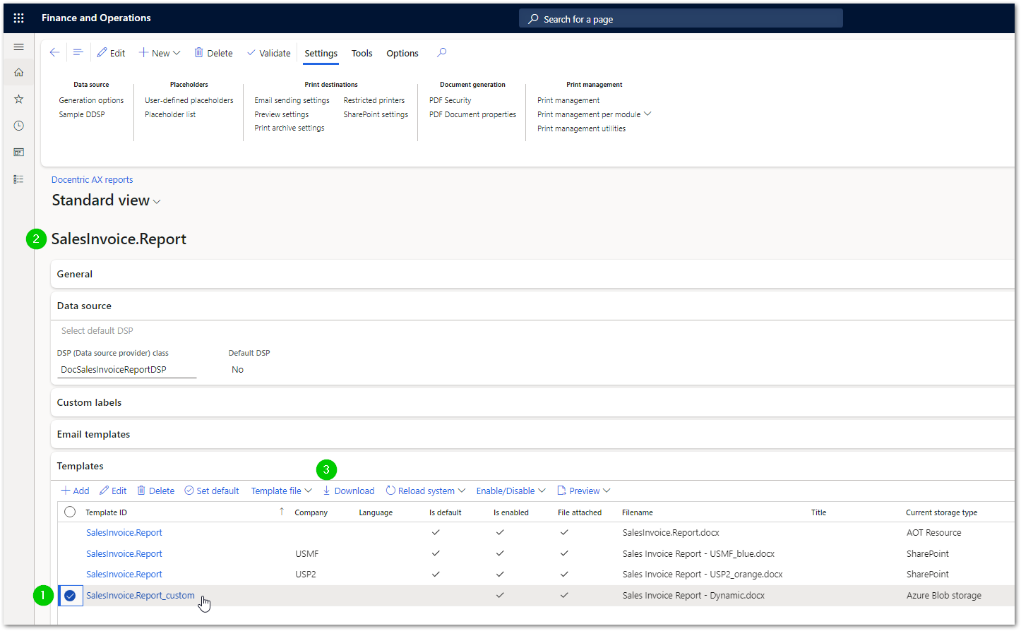

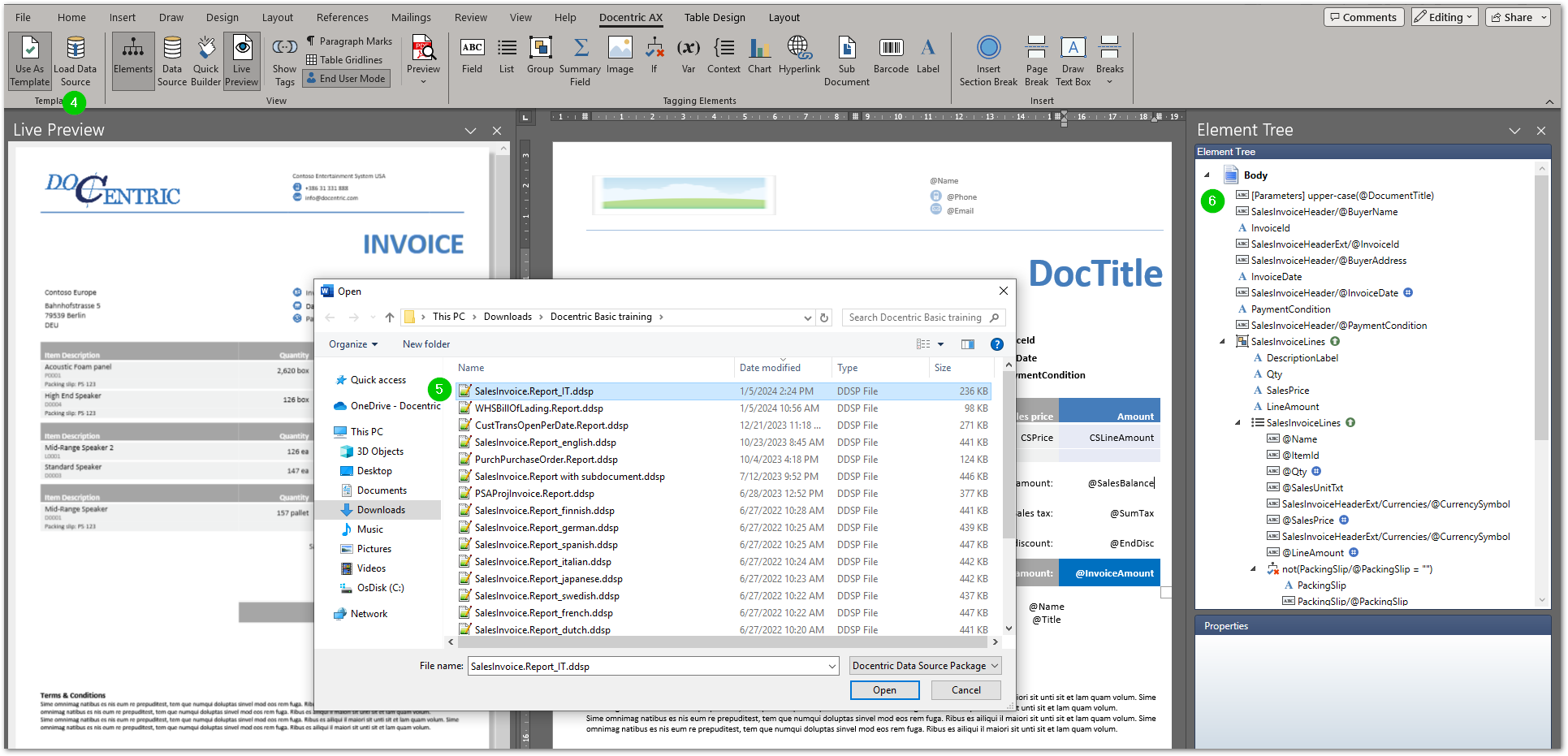

Next, we need to open the template we want to use for this report and upload the new DDSP. In my case, I will demonstrate this by using a custom template (below, 1) that I currently use for the SalesInvoice report (2).

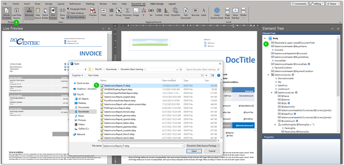

Clicking the Download button and opening the custom template in Word allows us to upload the previously generated DDSP (below, 5) into the template.
When uploading the DDSP, please ensure no tagging elements in the Element tree display warnings (6). If this is the case, we must investigate possible differences between the data sources and address this problem. Save the new variant of the template under a meaningful name.

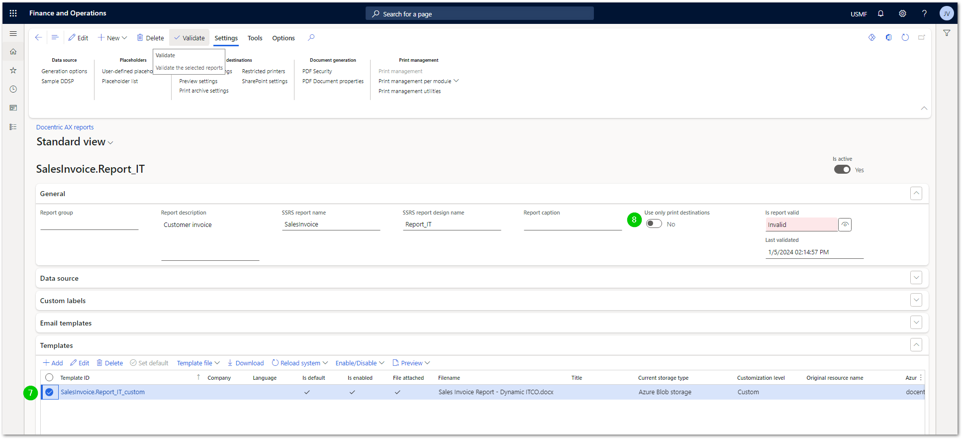

Switching to D365, we need to upload the custom template with the updated data source. Open the SalesInvoice.Report_IT report, and click Template file > Attach to upload the custom template into the environment:
After the template has been uploaded (above, 7), deactivate the Use only print destinations setting.

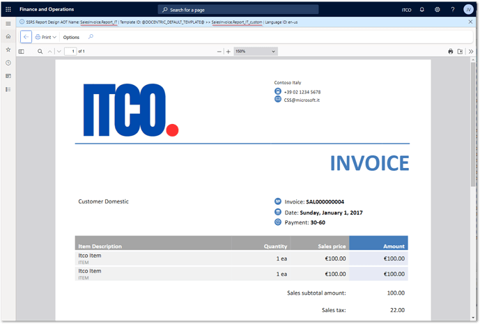

Step 6: Test the new custom template

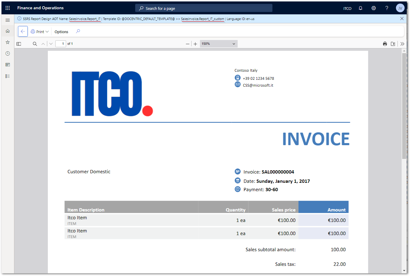

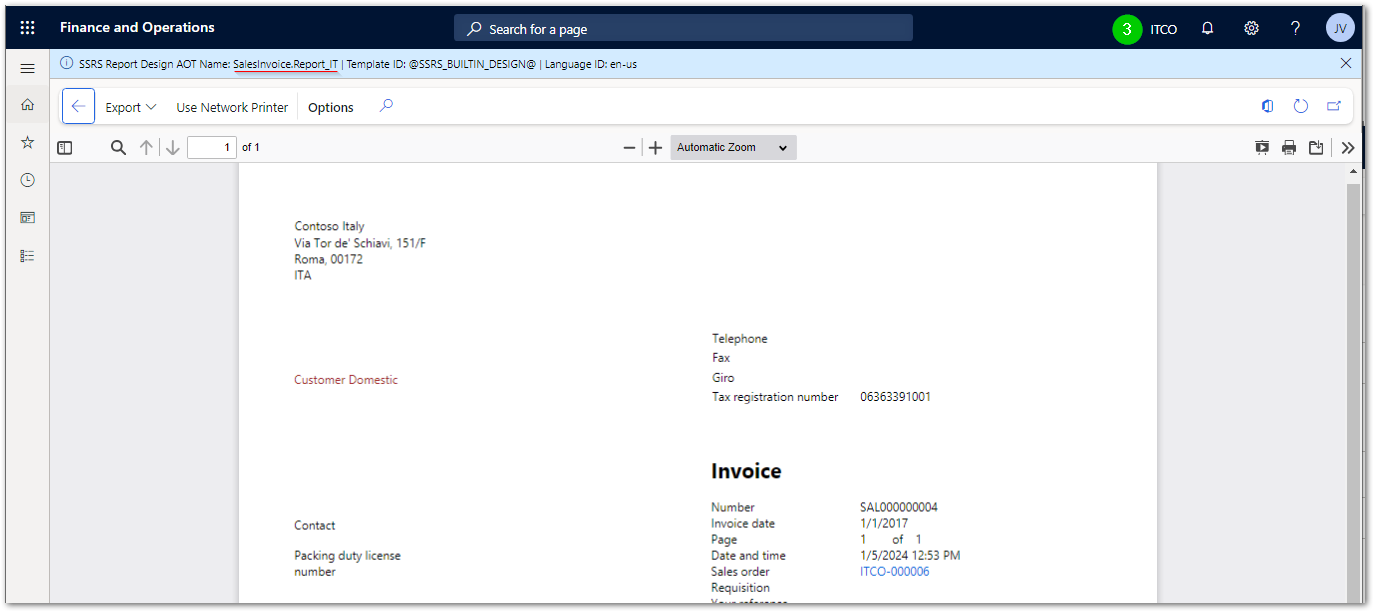

Now we can run the Italian localized sales invoice report and verify that the printed document is based on the custom report template:
We can see above the result of printing the document, with the details in the message bar confirming the correct technical name of the report and the expected Docentric Template ID.

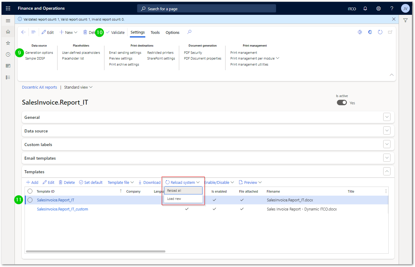

The last steps include deactivating the generation of the data source and validating the template (9 and 10).
As a side note, specifically for the report in question - SalesInvoice.Report_IT - Docentric also provides a replica template you can access by clicking the Reload system > Reload all button (above, 11).
