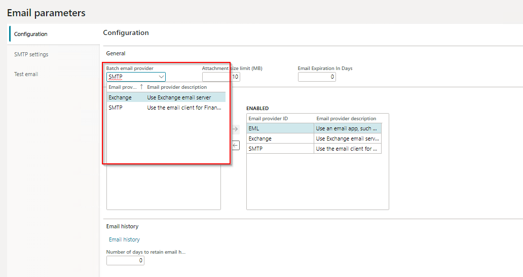

01 email parameters
1. If you are using SMTP then you have to specify @USEREMAIL@ placeholder in the From field and enter buyers’ email addresses in Docentric AX parameters > Emailing in Additional email sender accounts.
00 FROM field
2. If you are using Exchange leave From field empty so that the current user email address, specified in User options, will be used as a sender address. It seems to me that this should be an easier approach to your request.
