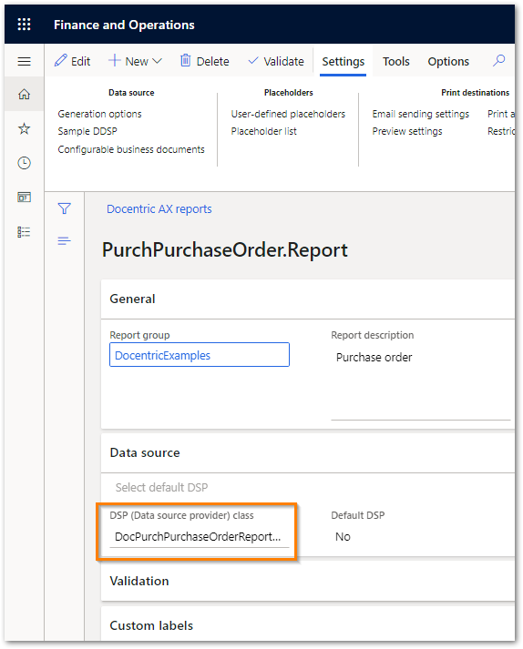

Hi @Karin. I have correct DSP class selected still having same issue.could you please suggest another solution. On local live preview, it shows data. but when prints on the actual live system, values don’t show up.
First you need to make sure that the same DSP class has been used for generating the DDSP file when you created the template and for executing the report. Some fields may be omitted during runtime but present during design time due to missing values coming from the standard SSRS pipeline.

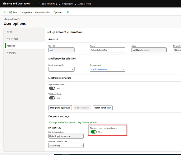

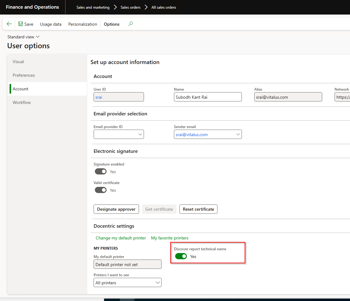

Also, please enable “Discover report technical name” so we can see which report is being executed, and include a screenshot of the Docentric setup for this report.
