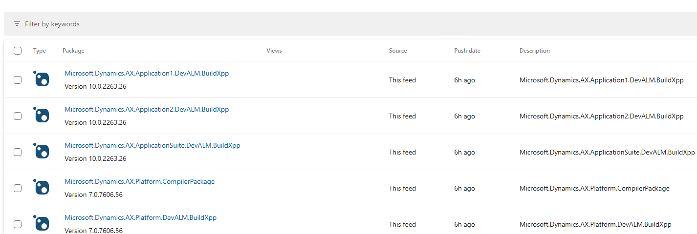

Hi @BlazJ thank you for the response. I did remove the base model from the repo and then reinstall it. I had the same result. In addition, I had a co-worker receive the same error on a different project.
As for the build on the pipeline, the package built properly with no errors until I updated the nugets to the latest version. Once the nugets were updated that is when I started seeing this error.
Nuget versions:

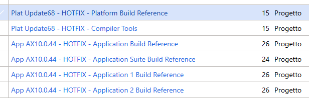

I also have the same problem.
I solved it by creating the PipeLine with the HotFix package, but it is a solution that then involves extra work during installation on the production machines.

I’ve created a new Pipeline, based on a new artifact with the new hotfix
ciao
Fabio

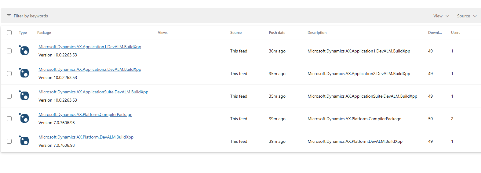

Hi @Mark_Edwards, I’d suggest updating all the NuGets to the latest version as Fabio says.
There are new packages that were published yesterday, 11 June, by Microsoft.
Thanks all, I finally got it to work with the versions published on 6/12/25

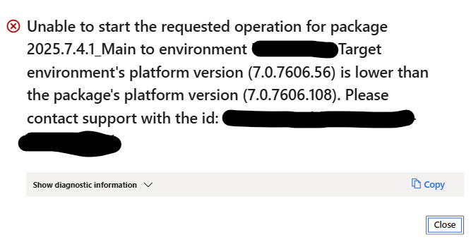

Hi Mark, did you get this message trying to apply the package?
Hi Joham,
You need to take the latest Cumulative Updates on the environment so the environment version is higher than the nuget versions.
