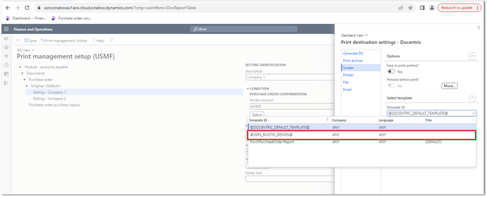

Most importantly, you need to enable the highlighted flag Use only print destinations to Yes in order to skip the use of Docentric templates for the specific report:

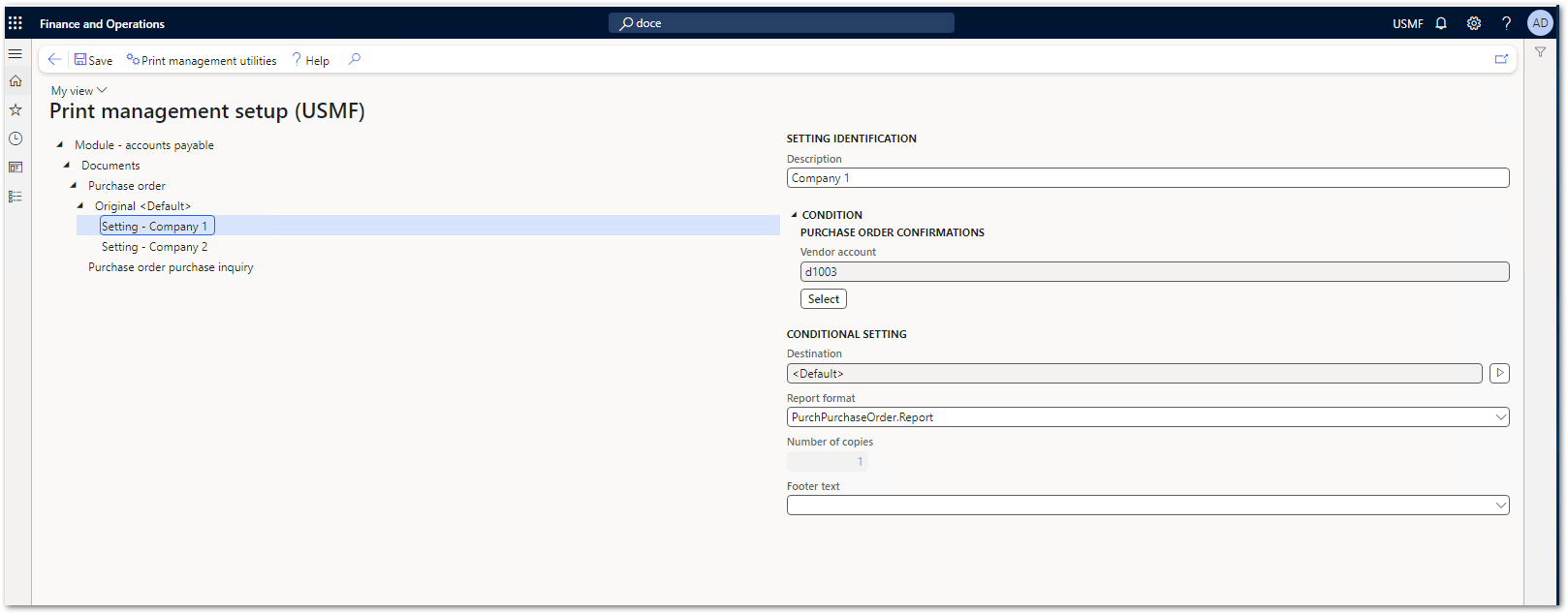

Regarding your screenshot, currently we use PurchPurchaseOrder in each company and have created one template by company. The flag looks like a global setting. When I create a custom report and set there the setting, how can I set the new report as default? Just global print destination settings in that one company?
Hi Stefan,

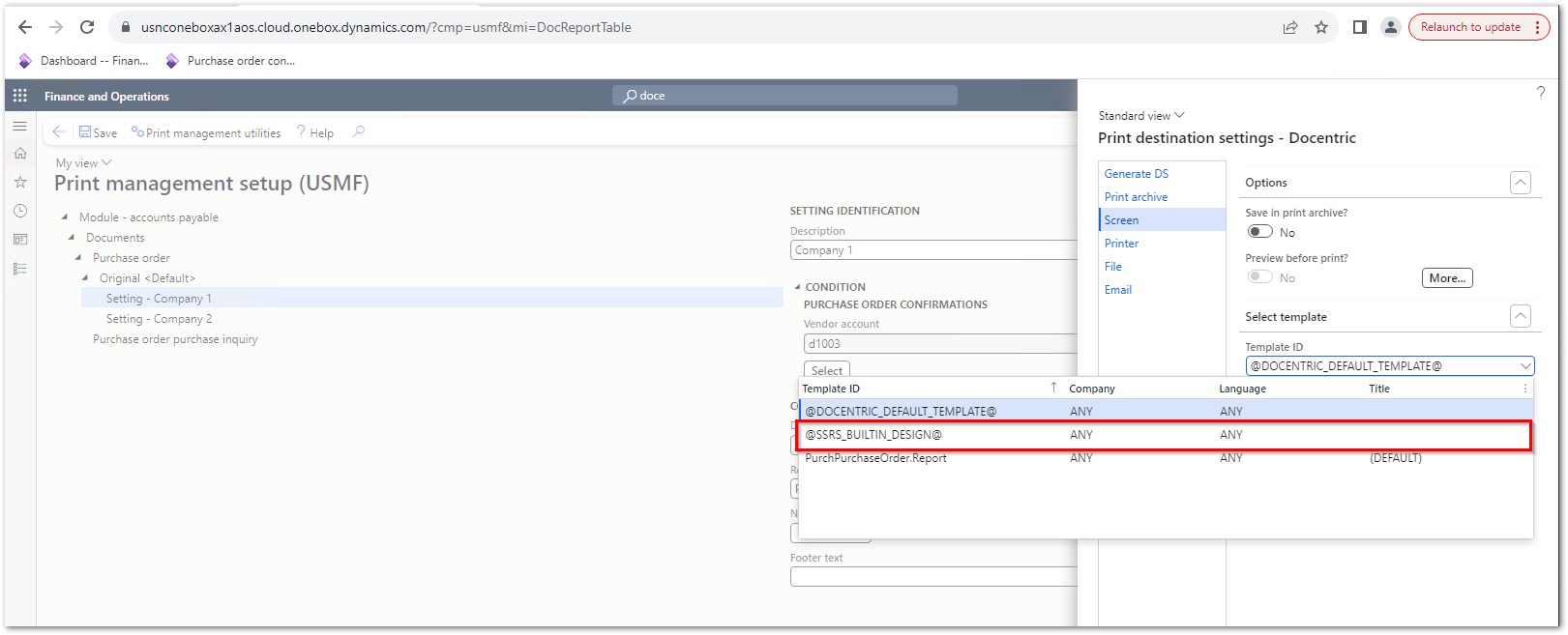

Based on your case description, I suggest utilizing the standard Print Management framework. Simply create a new condition for the specific company where you want to deactivate the Docentric design.
Then instead of using the Docentric design in the print destination, just opt for SSRS design.
