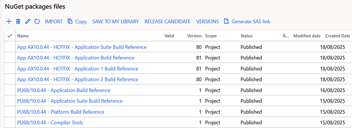

I uploaded first the newest “Applications” files, even “Application 1” and “Application 2”. I did not notice that “Platform” NuGet also had hotfixes:
“Plat Update68 - HOTFIX - Platform Build Reference”
“Plat Update68 - HOTFIX - Compiler Tools”
These hotfixes do not contain “10.0.44”, so I did never consider them, until yesterday.

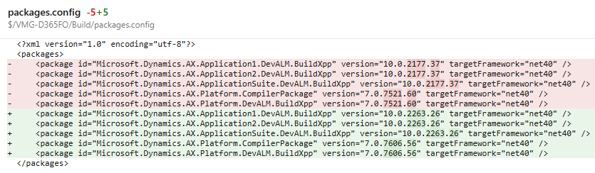

Hi @AmirO ,
Here I will paste the screenshot of Azure DevOps packges.config file change due to upgrade to 10.0.44 App/Platform version. Let me know which other info you would need.
Maybe you already know and can advice which specific file is missing in our Azure DevOps environment?

Hi @Nartas,
There was an issue with the version you’re using. Some files were missing, and it was reported by Microsoft and hotfixes were released.
We have successfully built version 3.4.9.2 with 10.0.44 with the NuGets on this version:
  • Microsoft.Dynamics.AX.Application1.DevALM.BuildXpp: 10.0.2263.109
  • Microsoft.Dynamics.AX.Application2.DevALM.BuildXpp 10.0.2263.109
  • Microsoft.Dynamics.AX.ApplicationSuite.DevALM.BuildXpp 10.0.2263.109
  • Microsoft.Dynamics.AX.Platform.CompilerPackage 7.0.7606.135
  • Microsoft.Dynamics.AX.Platform.DevALM.BuildXpp 7.0.7606.135
Higher versions should work as well.
