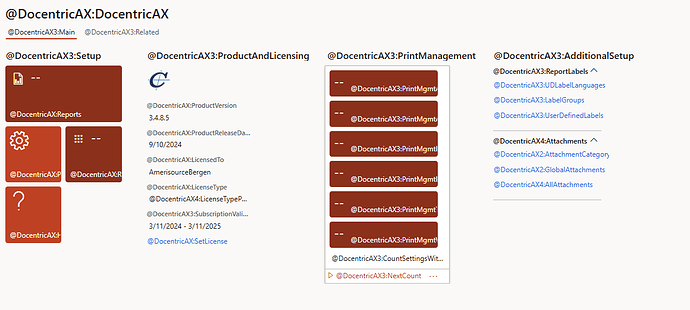

Hi @DalilaI and @Olivier,
I have issue with the Labels after to upgrade to version 3.4.8.5. Any tip to fix it?
Thanks!

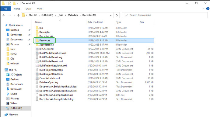

Hi Rafael,
On what environment is the issue present?
The labels are found in the Resources folder, they should be created when a build is done. Please try to rebuild and check if the labels are generated.
This resources folder should not be part of the source control, since it contains build artifacts (the resulting labels, for example), which will be recreated after every build.
One client has said in the past that they did put the resources folder as part of source control, because for some reason it wasn’t being populated otherwise, so that might be a possible solution.
Hi @NatasaKA,
The issue with Labels is in UAT environment. In the Dev environment, where we installed the model, is working, but in UAT is not working.
PS: We deleted the 3.4.7.2 version and installed the 3.4.8.5, following the steps in this article How to Commit Changes to TFS/DevOps After Upgrading Docentric AX Models - Docentric AX
Hi @rafaelparaujo ,
If you have entirely followed the upgrade guide with TFS/DevOps and the labels are still missing, you can try the suggestion from my colleague Nataša in the previous response, to include resources folder to source control.
