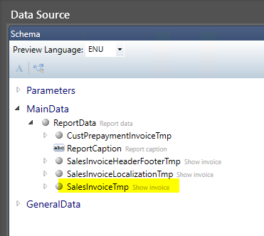

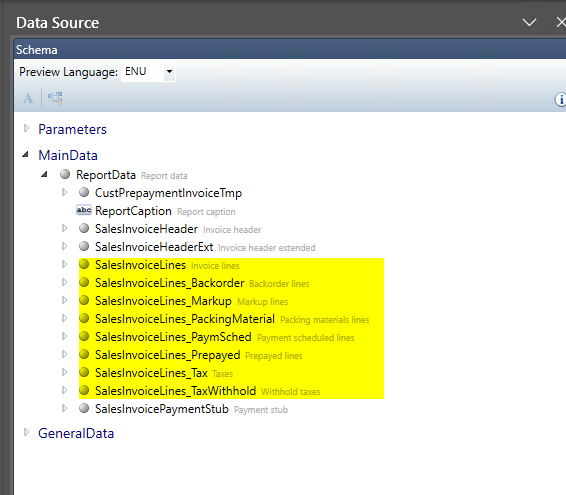

In standard SSRS reports, such as Sales Invoice or Purchase Order, several line types like transactions, taxes, prepayments, and charges are stored in one shared table called SalesInvoiceTmp. This setup works fine for developers but not for template designers who want to display each line type separately.
To solve this, Docentric reshapes the data.
In our replica DSP classes, we split that large table into clear, separate record groups.
This process is called reshaping, and it makes the data easier to understand and use in the Docentric AX designer.

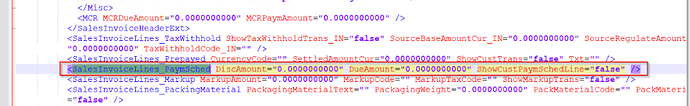

However, not all documents contain every line type. For example, an invoice might only have transaction lines and no taxes or charges. If we only used real data, those missing groups would not appear in the DDSP. That would break the field bindings in your Word template.
To avoid this, Docentric adds a dummy record for each missing group when creating the design-time DDSP.This record is empty but keeps the structure complete so you can bind all fields.

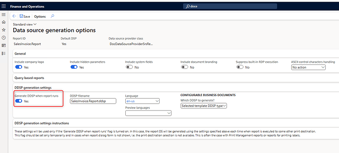

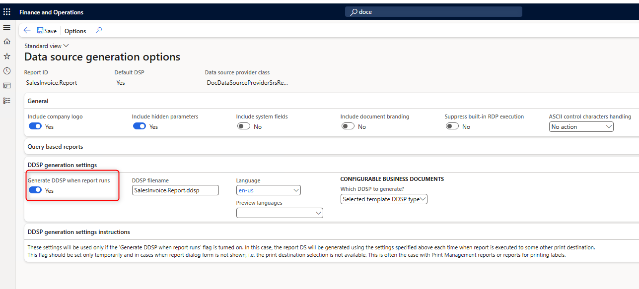

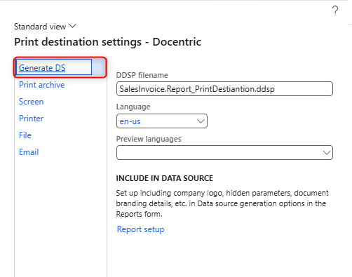

First, let’s download the design-time DDSP file. There are two ways to generate it:
Enable the Generate DDSP when report runs flag in the report setup under Data Source, or
Use the Print Destination called Generated DS to generate the DDSP file.
Both methods will produce an identical DDSP file that you can use for template design.

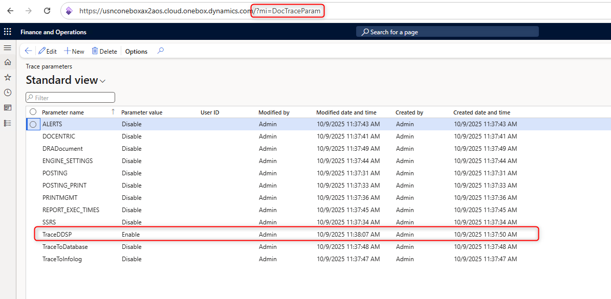

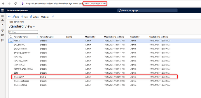

When it comes to the run-time DDSP file, it’s stored in memory. To capture it, we can use the Docentric Tracing Framework, which helps us understand what happens when a report runs in the background.
If you want to see exactly what data the report uses at runtime, enable the Trace DDSP option.

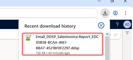

This allows you to download the run-time DDSP file directly from your browser when the report runs.
Once you have both DDSP files (design-time and run-time), you can open them in your favorite text editor and compare them to find the dataset or field causing the issue. For example, you can check if certain fields are present and what values they hold.
