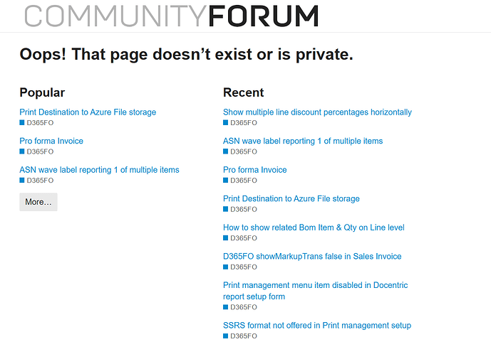

I can’t access that page. Either the post no longer exists or I do not have permissions.

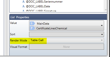

To show multiple discount percentages horizontally for each invoice line in the Sales Invoice report, you need to use a List tagging element inside the discounts cell, and set its Render Mode to Table Cell. This will make each discount appear in a separate table cell, displayed horizontally in the same row as the invoice line.
So it should be something like this:
  1. Wrap the invoice line row in a List tagging element bound to your SalesInvoiceLines collection.
  2. In the cell where discounts should appear, insert a nested table with one row.
  3. Inside that row, add a List element bound to the Discounts collection of the current line.
  4. Set the inner List’s Render Mode to Table Cell**.
You can check a similar approach in the following article, where the key point is to set the List’s Render Mode to Table Cell:
