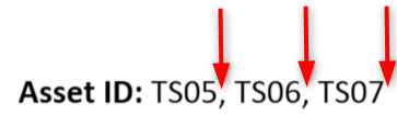

Here are some screenshots for a visual representation.
Design-time:
Result:
In summary, the provided expression handles the addition of commas, ensuring they are present between elements but not after the last element in the list. The logic involves checking the count of nodes against the current index within the context of the loop or iteration.
