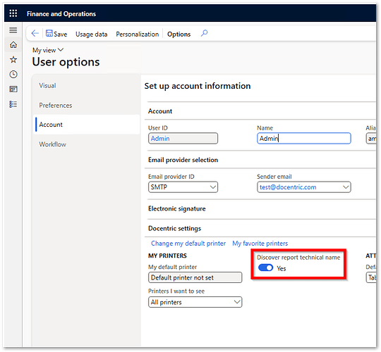

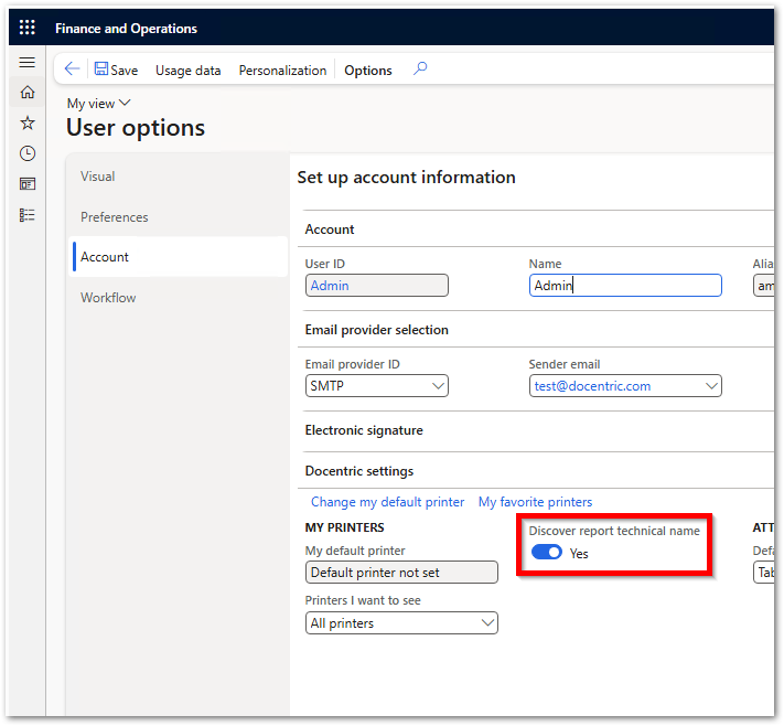

If you’re not sure which SSRS report is printed in F&O, you could turn on the flag “Discover report technical name” under User options. Then check the info box when printing to see which SSRS report is being used.
More info in this forum post: Discover report technical name
