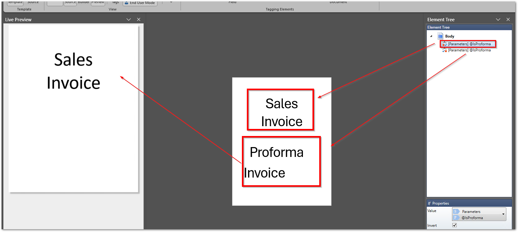

Copy your Proforma Invoice design into the template used for the Sales Invoice. Then, in both designs, include a tagging element that checks a specific data field called “IsProforma” in our case, to decide whether to print the Proforma Invoice layout or the standard Sales Invoice layout.

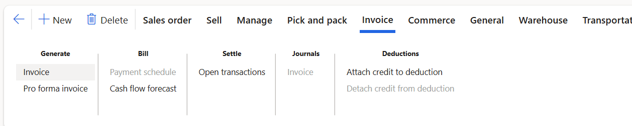

My sales invoice templates are running on the basis of print management settings, how can I select and run the proforma invoice template. I would like to call this custom template after I select a sales order on the ‘all sales orders’ form and click ‘pro forma invoice’ under ‘Generate’ group in ‘Invoice’ tab.

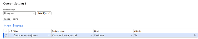

The print management is a standard D365FO feature. To achieve what you are going for, you can simply use the Pro forma condition setting and set it to Yes.
When the report is executed through Print Management, the system will evaluate the condition (Pro forma = Yes) and use the specified print destination along with the corresponding report template.

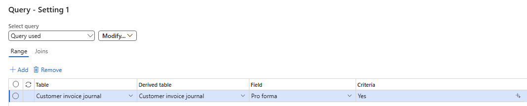

I have similar issue. For sales invoice, I have a template for all companies. Then for France, i have a template for the French company/legal entity and French language, and another for the French company and English language. The business wants a separate template for pro forma with some elements changed. I created this template and put it in the custom sales invoice report. I setup print managment condition setting under the original node to select isProforma=Yes. However, when generating the pro forma from sales order screen, it is still picking the original template, even though the technical name and trace is showing that it is choosing the conditional setting node.
