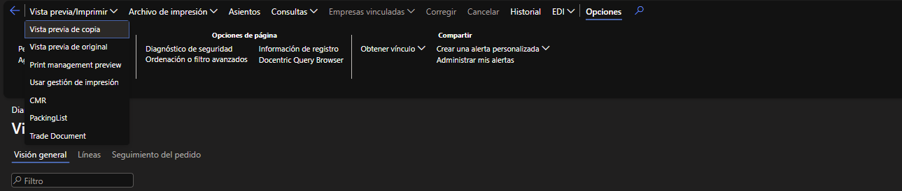

Hey, I’m back again. I’m using print management to generate packing slips, and right now it’s set up to automatically send the packing slips by email. The thing is, I’d like to generate all the possible files in SharePoint to keep an archive of all the data. But when I try to use the option to print without print management in the packing slips section, it doesn’t show up. Where should I go to trigger the function to print without print management from packing slips?

When printing Delivery notes from CustPackingSlipJournal, the process is driven by Print management (reprint scenario), and the report dialog is not exposed. Because of that, Docentric destinations cannot be changed at runtime, and the system follows the existing Print management setup.
At the moment, there isn’t a standard way to run Delivery notes like a standalone SSRS report and override the destination on the fly. Achieving this would require customization (for example, a custom menu item that calls the report with a dialog).
