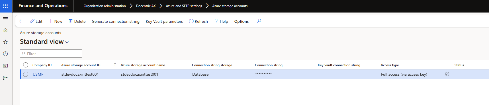

Before we proceed, we first need to set up our Azure storage account so that we can use it in our working example class.
In this example, our Azure storage account setup looks like this:
For instructions on setting up your Azure storage account, please check out this how-to manual.

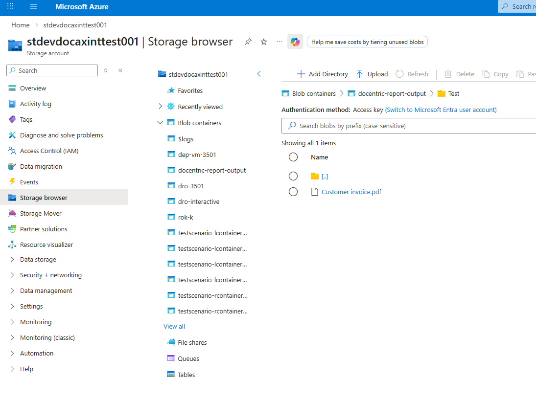

This is what the Azure Blob Storage account looks like on the Azure Portal:

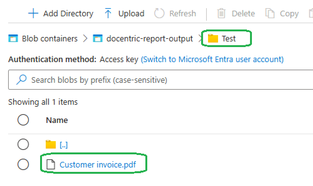

  1. Blob storage container name (if the container does not exist, it will be created):
  2. Blob path and blob (file) name (if the file already exists, it will be overwritten)
  3. Report memory stream, which you can create by using the DocSrsReportGenerator class. Other memory streams created by other means should also work.
  4. Azure Storage ID

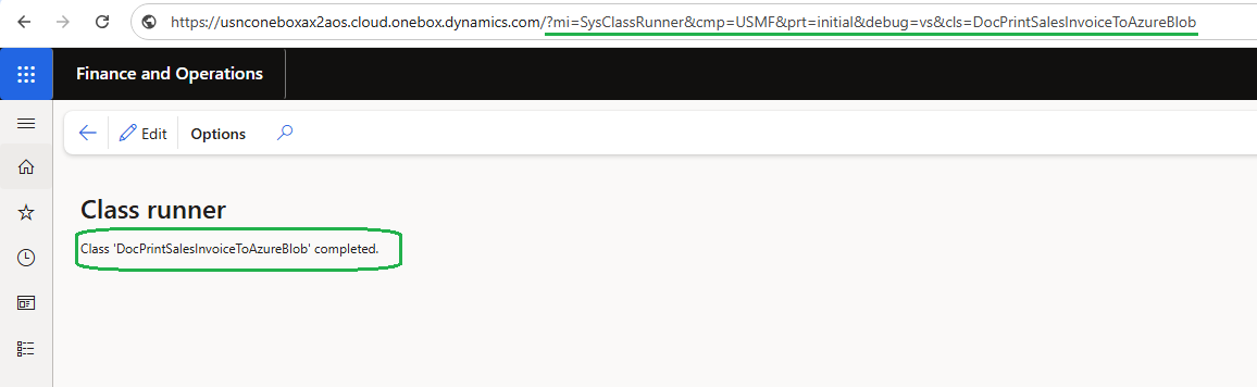

Once we have created the class, we can then build the code and try it out on our DEV machine by using the SysClassRunner menu item.
We can do this by adding the following to our D365FO URL:
?mi=SysClassRunner&cmp=USMF&prt=initial&debug=vs&cls=DocPrintSalesInvoiceToAzureBlob
After the DocPrintSalesInvoiceToAzureBlob class completes, the file should now be visible on the Azure Portal:
