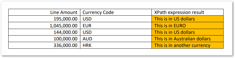

To showcase the nested inline IF expression, I’ve created an Inline IF test template.docx. In my example, I wanted to write a custom text depending on the Currency Code. The expression to achieve the output visible on the screenshot below was:
iif(@CurrencyCode = ‘EUR’, ‘This is in EURO’,
iif(@CurrencyCode = ‘USD’, ‘This is in US dollars’,
iif(@CurrencyCode = ‘AUD’, ‘This is in Australian dollars’, ‘This is in another currency’)))

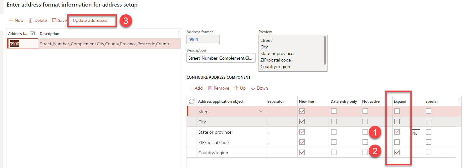

Eva, I found a solution to this issue in the D365 Global address book, address format settings. There are ‘Expand’ fields for country/region and State/province. Once these are checked the text description is used instead of the ID example ‘Ireland’ is used on addresses instead of ‘IRL’. There is also an ‘Update addresses’ job on the menu that will update the postal address format for addresses that use the format being updated. Hopefully this help someone else hitting this issue.
Hi,
Thanks so much for sharing this tip! This will surely come in handy to many D365FO users (including us) out there. Great contribution!
