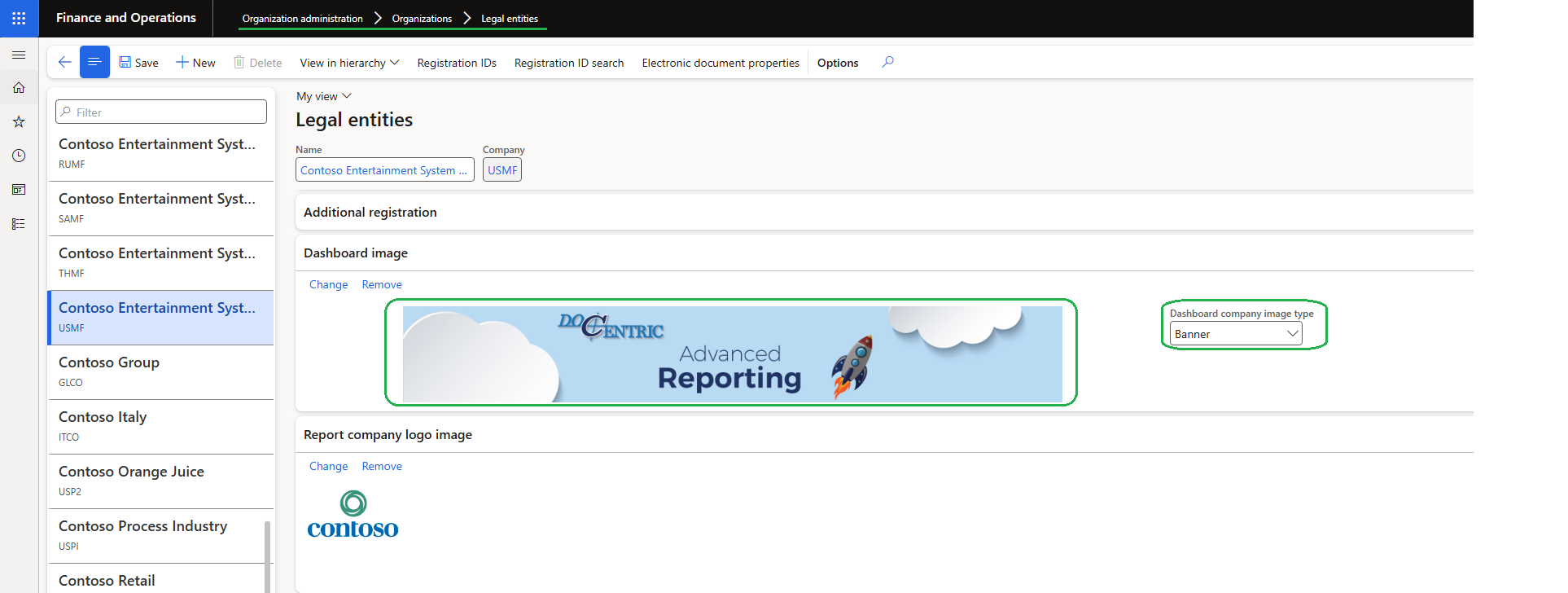

In this working example, we’ll add the dashboard image, that can be set on every legal entity, to the GeneralData/CurrentCompany section of the Schema of all Docentric report templates.
First we need to set the dashboard image in the D365FO UI, in this case, we’re setting the image type to be Banner:

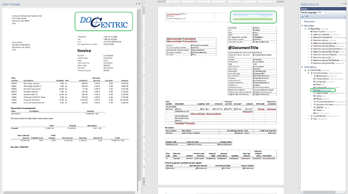

Lastly, we will load the this DDSP into our Docentric template that we’re designing:
This is all that is needed to make the Banner image available in the Docentric template:
