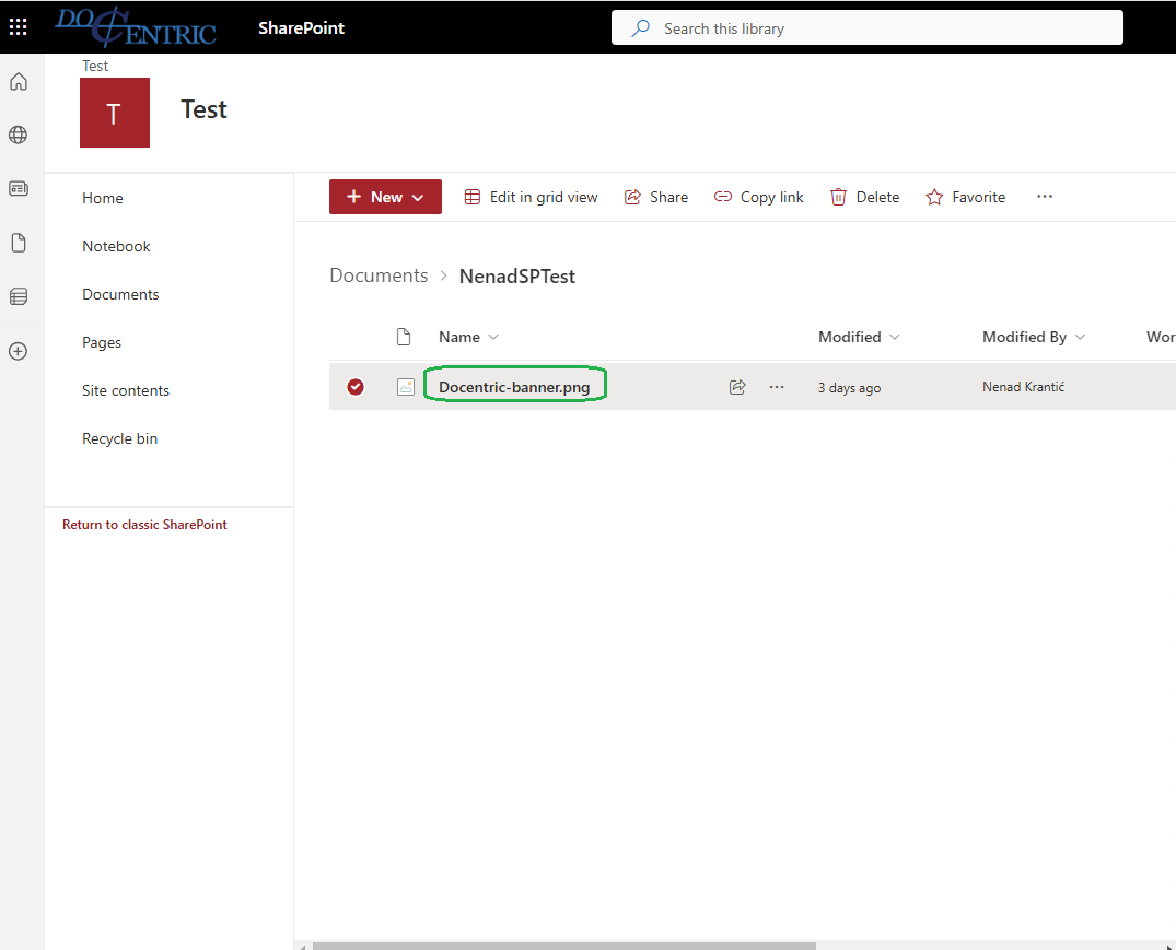

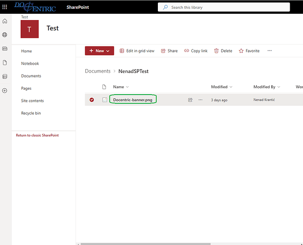

  1. First step is of course to have an image we want to use on a SharePoint location that the D365FO app has access to:

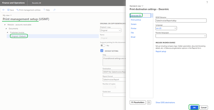

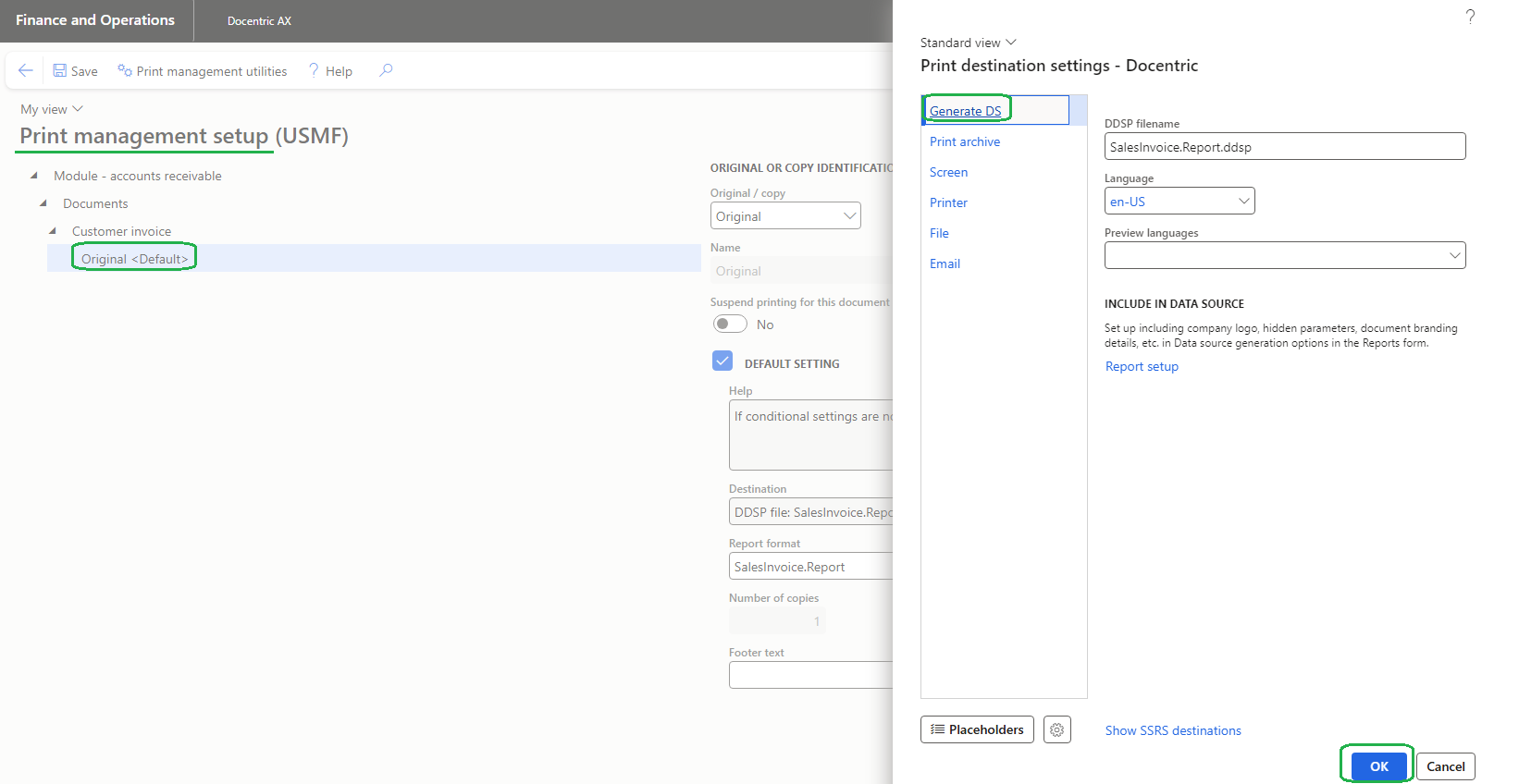

  1. Now, we’ll need to generate the DDSP of the report we’re designing, in this example Sales Invoice, by firstly setting the Print destination of the report to be the Docentric Generate DS:

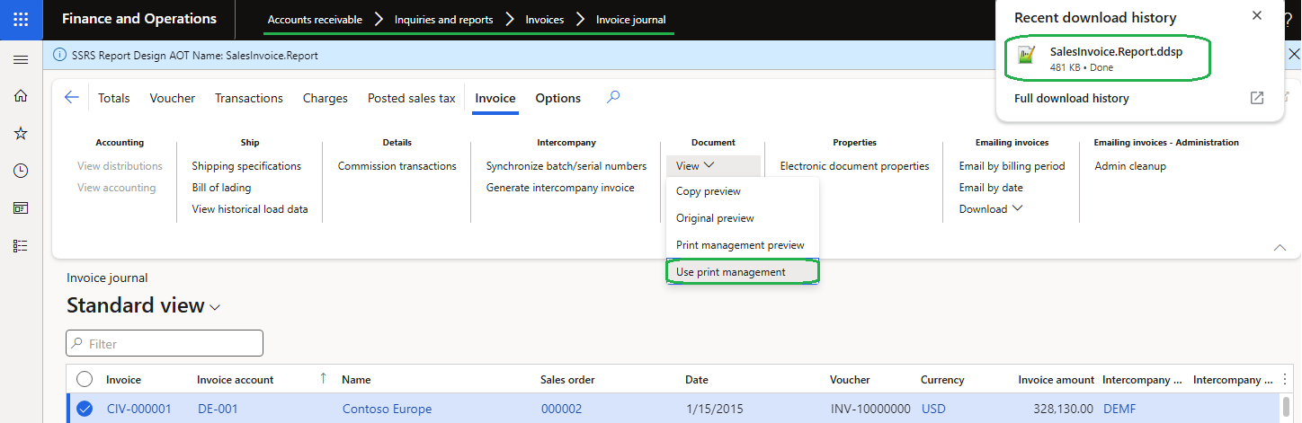

  2. Then we can simply print the report and we’ll get the DDSP file:

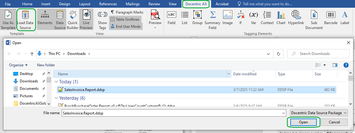

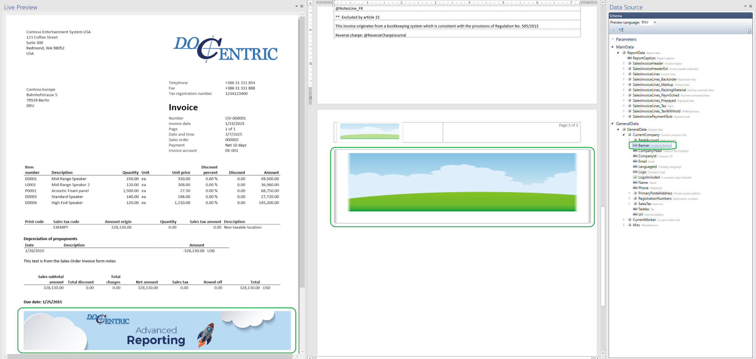

  3. Lastly, we will load the this DDSP into our Docentric template that we’re designing:

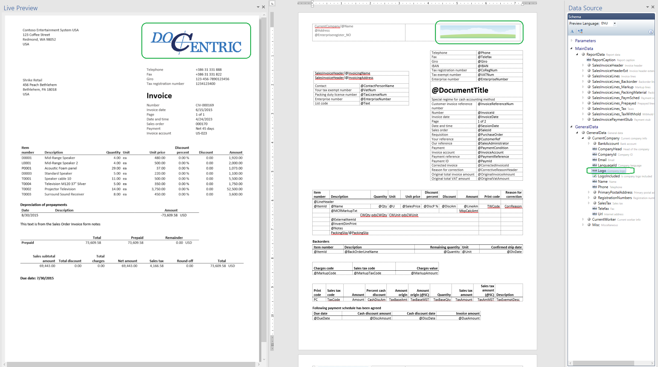

This is all that is needed to make the Banner image available in the Docentric template:
