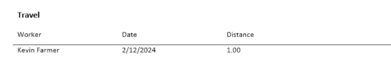

Travel table:
in the fisrt ddsp, i dont have this section (MSM_TaskTransKm)  so I need to hide the whole table, but the second ddsp i do have, in this cas I need the table.

I modified your template by hiding the “Travelling” section using the if() tagging element for the MSM_TaskTransKm element count:
count(/ReportData/MSM_TaskTable/MSM_SvcCallTable/MSM_TaskTransHours/MSM_TaskTransKm) > 0
This works with the two supplied DDSP examples, but please also test it with other cases in your environment.
