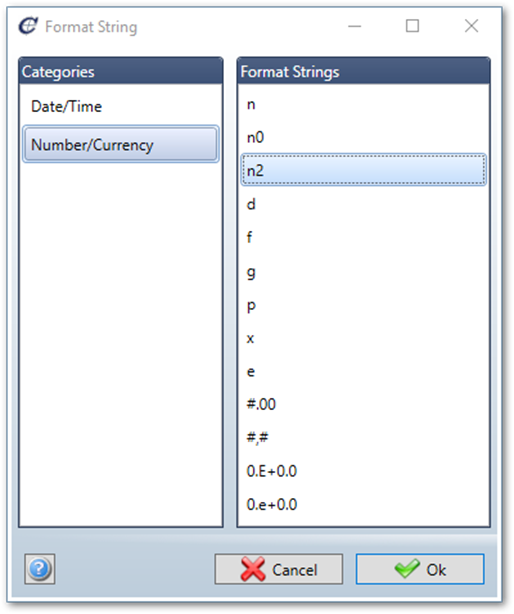

Predefined number formats
You can choose from a list of predefined number formats when you click the highlighted button in the Format String dialog box.

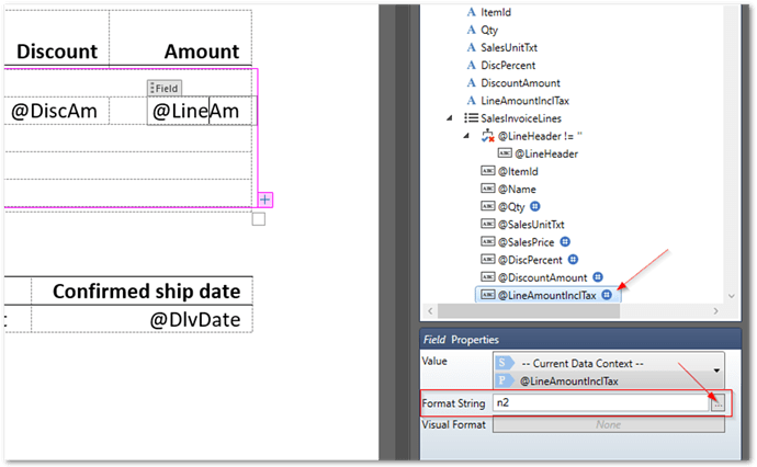

Notice that all field tagging elements to which a format is applied have a blue icon in the Element tree. Below you can see the dialog box that opens after clicking the Format String button in the Field Properties:

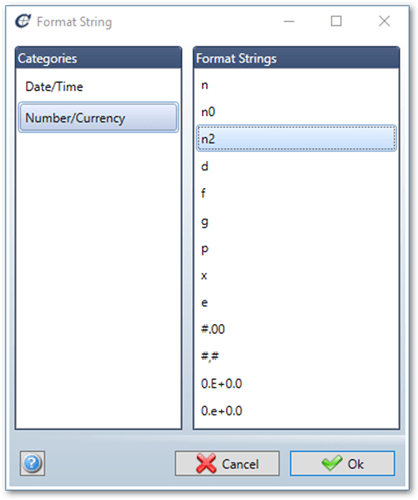

Define custom number formats
If you already know which custom number format you want to use, you can enter it directly in the Format String dialog box:
