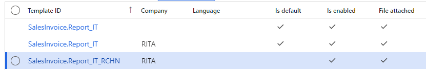

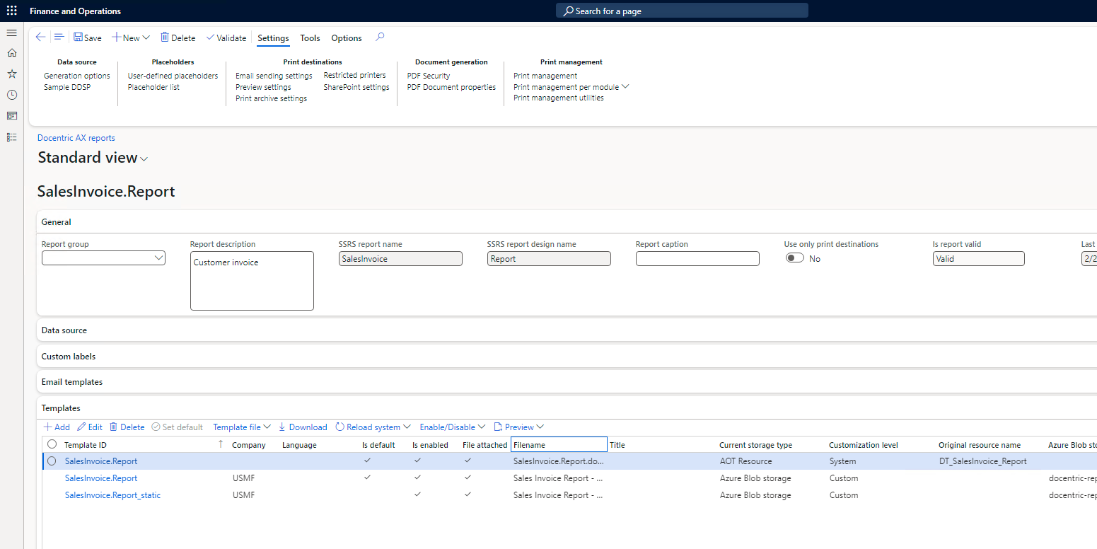

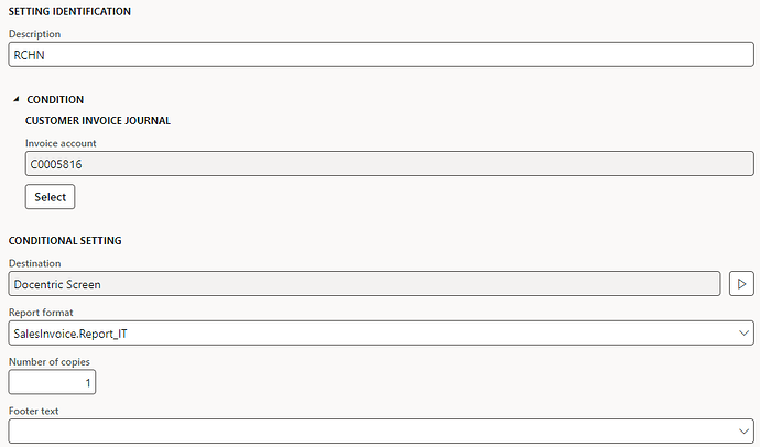

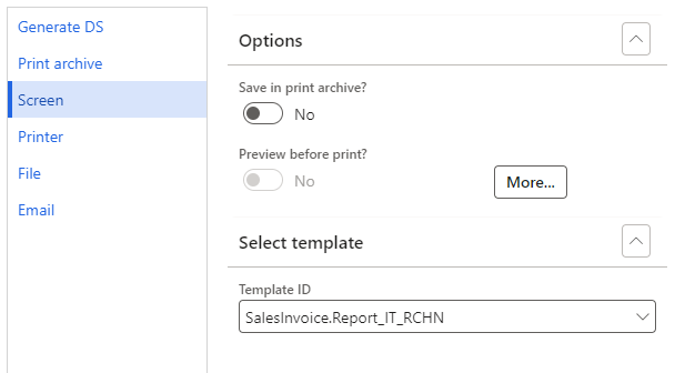

Our invoice need some special settings in case we export to China and I’m trying to set up this. I have created a new template
and made these print destination settings
printing an invoice use this template which is after printing the default for that company RITA (screen1)
What did I wrong?

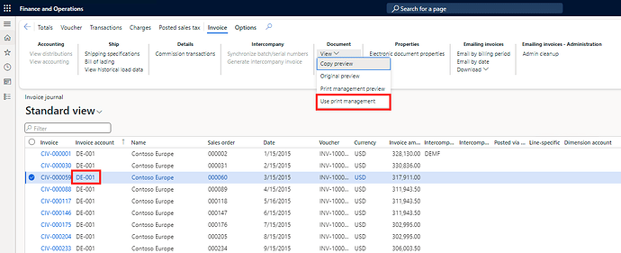

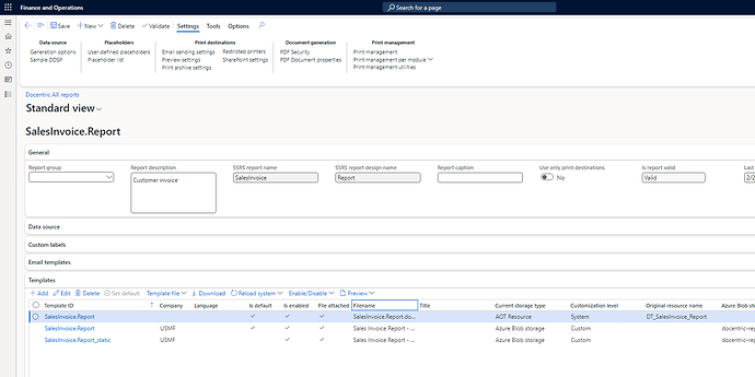

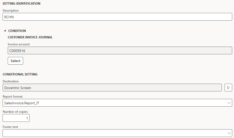

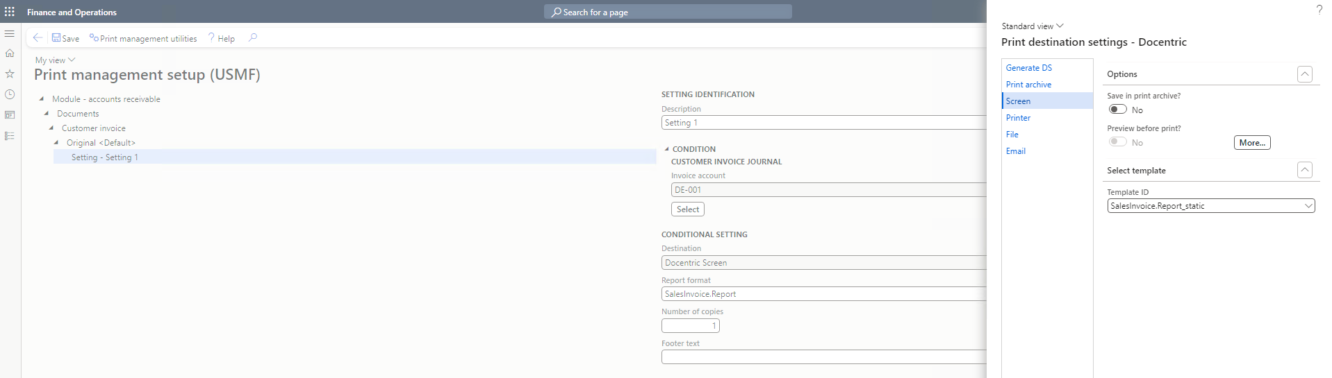

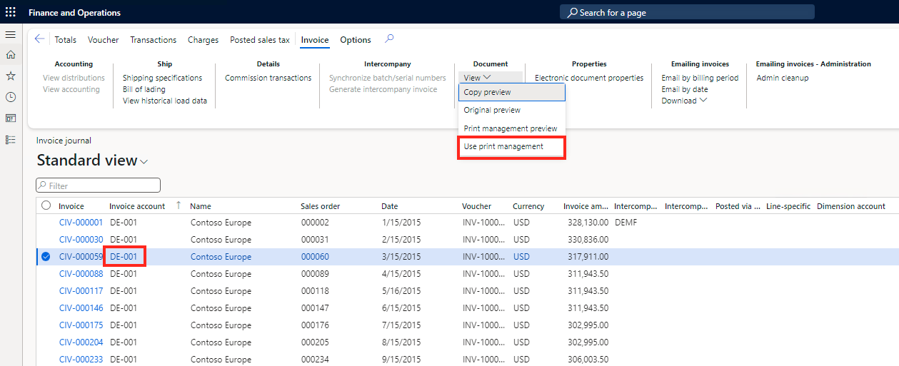

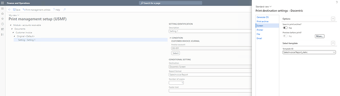

I’ve quickly replicated your case and can confirm that it should work IF your condition is met. Here is the setup:
I then created a conditional print management node to print my SalesInvoice.Report_static template when Account is DE-001:
I then select the invoice with the account DE-001 and print using print management (if you use Original preview you will get the default template printed as that is the print destination configuration configured on the Original node)
So to summarise, it can be that either your condition was not met or that you did not print using Print management.

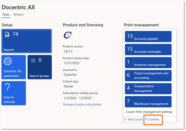

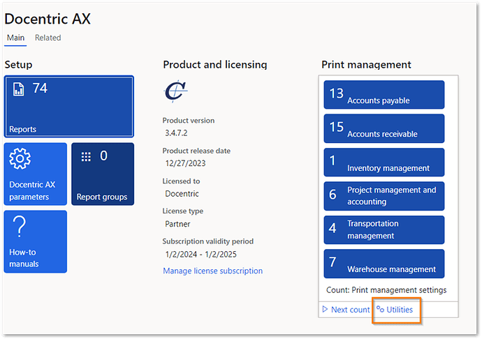

If you’re unsure about print management overwrites in your environment, I highly recommend using our Print Management Utilities. With this tool, you can conveniently preview all print management settings in one place.
For more details about the Print Management Utilities, you can refer to the how-to manual: Print Management Utilities - Docentric AX

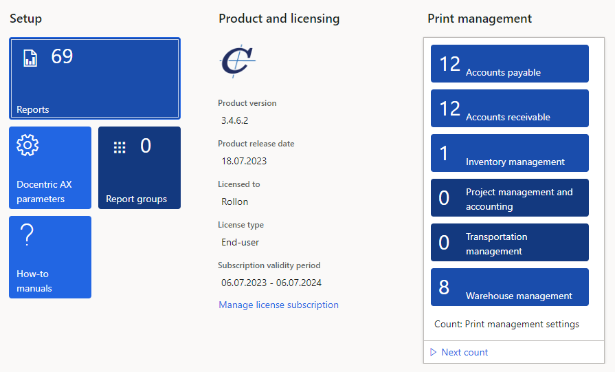

I don’t have that button. BTW my admin confirmed I have sys admin role in our dev environment I’m workin on

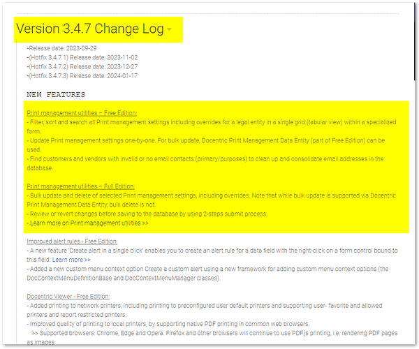

Hi Stefan,
It seems you’re using an older version of Docentric. The feature I mentioned has been available since version 3.4.7.
Please update Docentric to the latest version.
