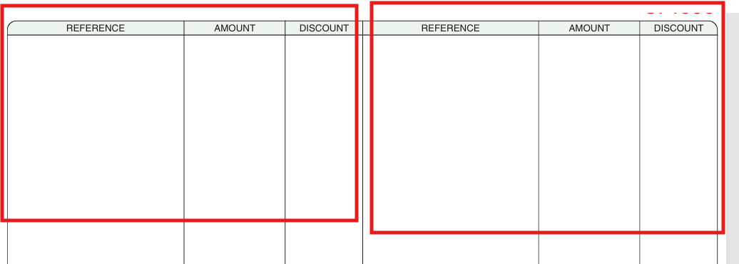

Hello, I have a list of invoices, and need to break that list into 2 side by side table. for example in the first table want to list the first 30 invoices, then the remaining invoices into the second table:

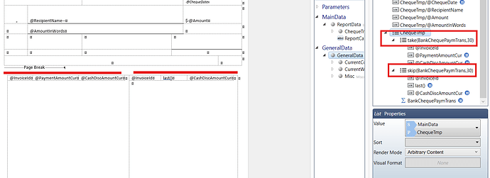

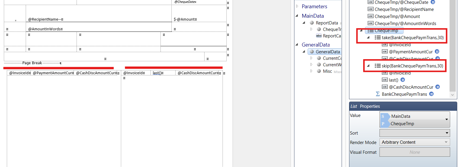

I tried the take and skip function and it went well for the take but for the skip it fail, the skeip function works when the number in second parametres is lesst than the total number of invoices:
In the attached ddsp (22 invoices)
any solution? thanks

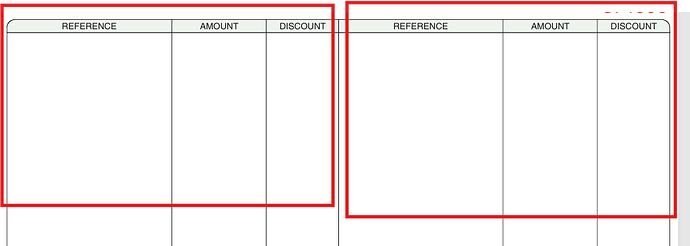

There is a workaround that can help with this issue. When there are fewer than 30 lines, the second nested table contains no rows, which causes the error.
By adding an additional row to the second nested table and reducing its font size to 1, the issue is resolved.
Please find the attached report template with the extra row added to the second nested table.
I would suggest testing the corrected template with different data sources to make sure all scenarios are covered.
