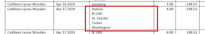

Hi @Nicky ,
You can do that by utilising replace() function and a $lf variable that is used instead of encoded characters ( ):
replace(@PMIPDescription, $lf, ’ ')
Just make sure to insert correct path for the field as the first parameter.

Hi @Nicky,
I have checked your report template, and the reason this did not work is because you have used the replace function inside the If tagging element. The result of this function was therefore a string.
This is the function you are looking for in your
substring-after(substring-after(replace(@PMIPDescription, $lf, ''),'-'),'- ')
I am attaching the report template I have edited for you - you can check the solution there as well.
I don’t know what is the purpose for which you have added the If tagging element around this field tagging element so I have set it to true()
so that it always shows the content.
