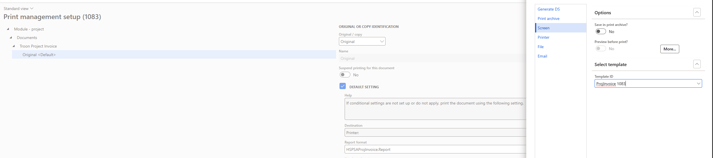

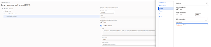

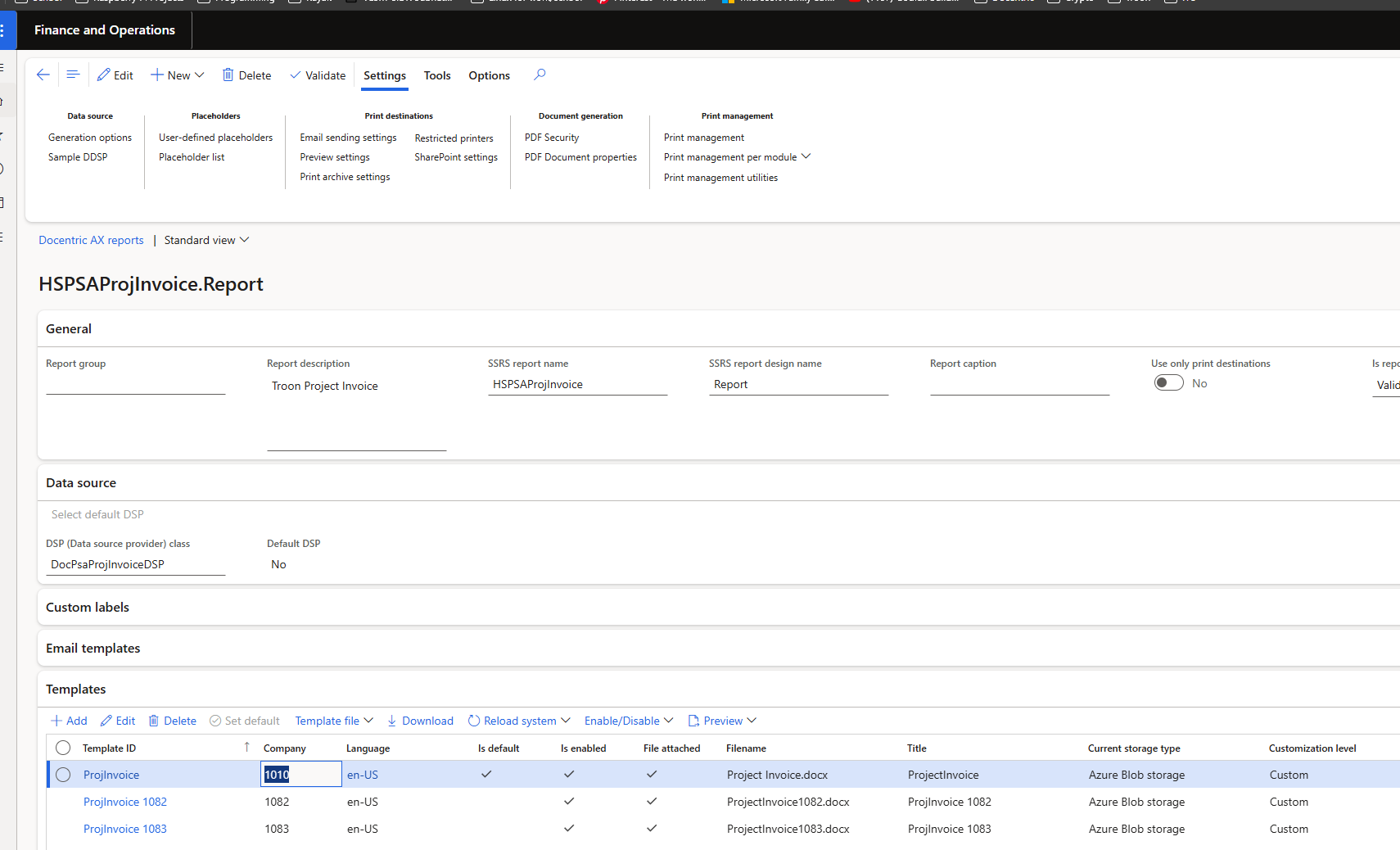

Attached is an image of our report templates. We need to only use the Proj Invoice template in 1083. But when we try to print using the original option, it only ever pulls the @Docentric_Default_Template@ no matter what is setup.
Has anyone ran across this issue? The same issue happens for us in 1082 as well.

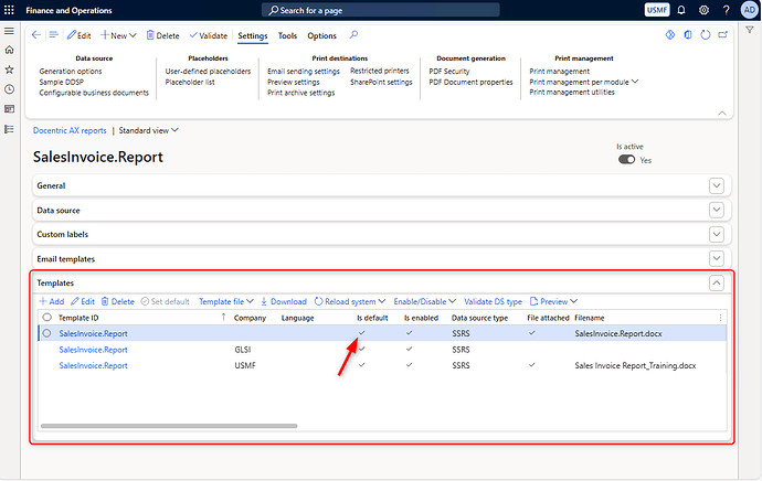

The Original Preview uses the report template that is set as default on the Templates section of the Report Setup form. You can set different report templates as default for different legal entities if needed or leave the Company field empty to use the same report template on all of the legal entities. The Template ID needs to be the same in this case.

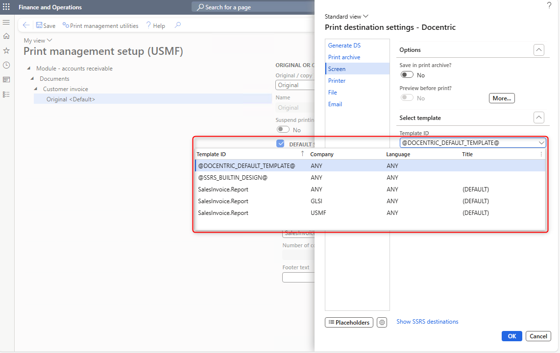

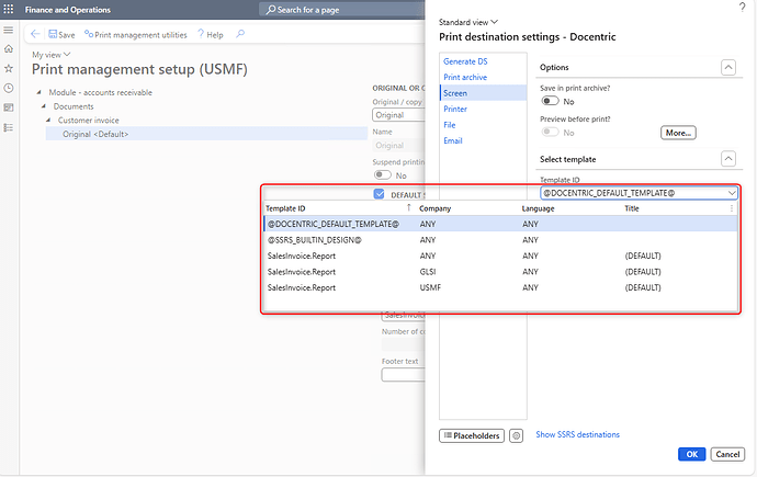

The Print management preview option uses which ever report template is specified on the Print management itself.
You can set a specific report template to be used on the print destination executed via Print management or use a default report template.

Docentric improves this by allowing you to assign different template designs for different companies. The Template ID needs to remain the same. Then, for each company, you can upload a different template design. This means you have the same Template ID but different designs, which will automatically resolve and provide the correct template.

For your case, it might be best to use the Print Management framework with conditional printing. You can create a condition for when a specific template should be used, and this will happen automatically without interfering with other Print Management settings.
You can check our how-to manual on Print Management to see how to set up conditions. Print Management in Simple Words - Docentric AX
