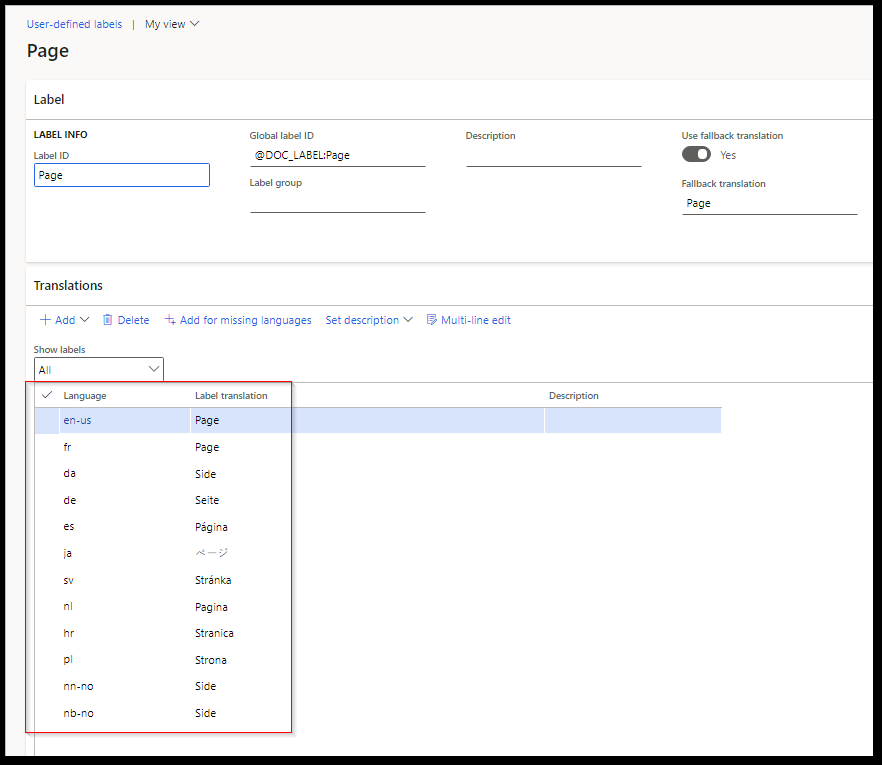

Below is a screenshot from D365FO with a new Docentric user-defined label that includes translations for word Page to different languages:

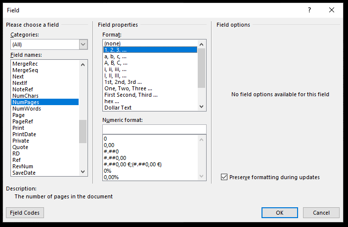

Apart from the label tagging element we also have to insert both the current page number and the total number of pages as separate Fields. This is MS Word built-in functionality: go to Insert > Quick parts > Field :
