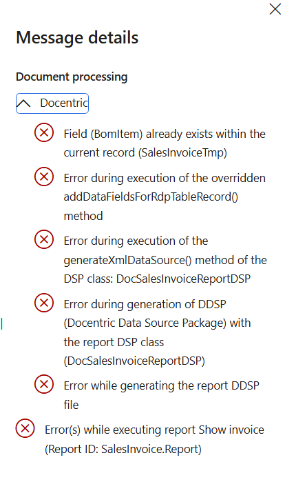

What the issue is I need to write while loop for looping through all the possible related BoM items. I am creating two new fields within the parentheses and assigning them the value.
When the first loop is run and picks a bom item, it creates the fields BomItem and BomQty and assigns the values. For the second loop the DSP class cannot assign the value to the field because there are already values in those two fields. The debugger shows that it throws an exception.

Hi Semir, my report throws error when I build. Here is the error:
